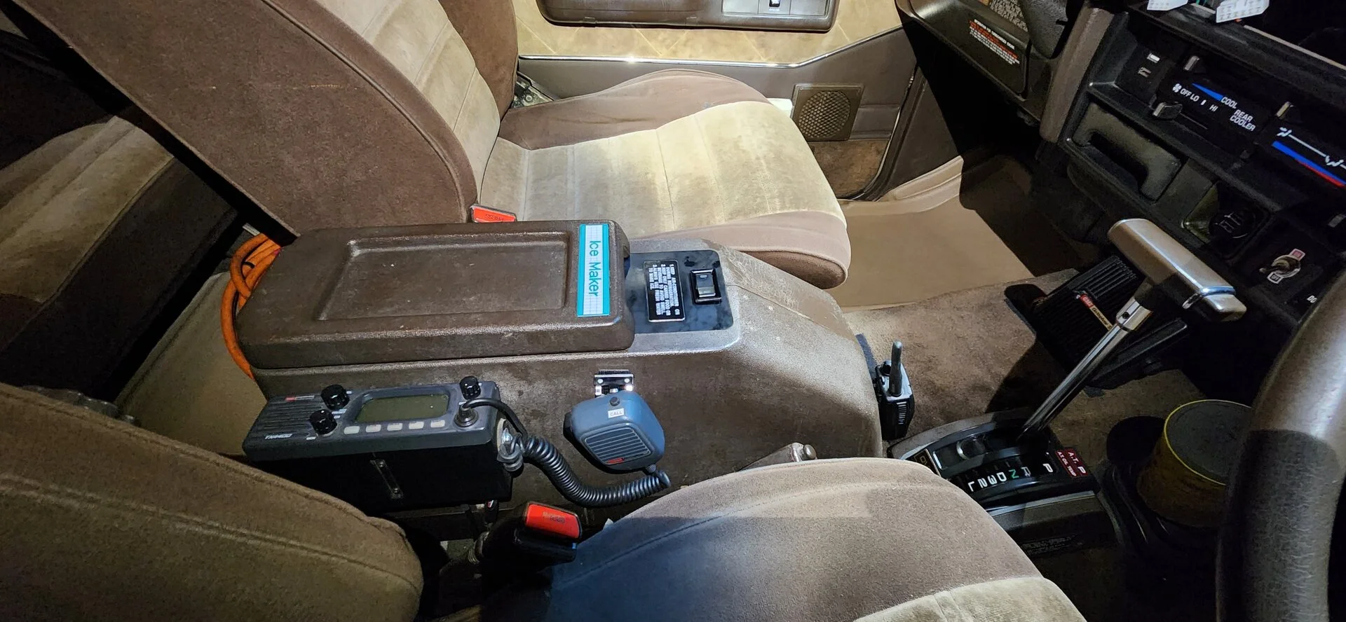

Hey guys I've got some questions about the factory Ice Maker.
I know they were never an option in the USA so there isn't much info on them out there.
I have an Aus HJ61 with the factory Ice Maker.
I have replaced with brand new the AC compressor, condenser, drier and evaporator.
I just got the aircon re gassed and it works great. The front aircon, rear aircon and Ice Maker all work.
But it doesn't get cold enough to freeze the ice cubes! It makes my beers super cold after running for an hour though.
Ive driven 2 hours with it running non stop and the ice cubes don't freeze. Maybe if I drive 3 or 4 hours it might work?? Seems pretty pointless though!

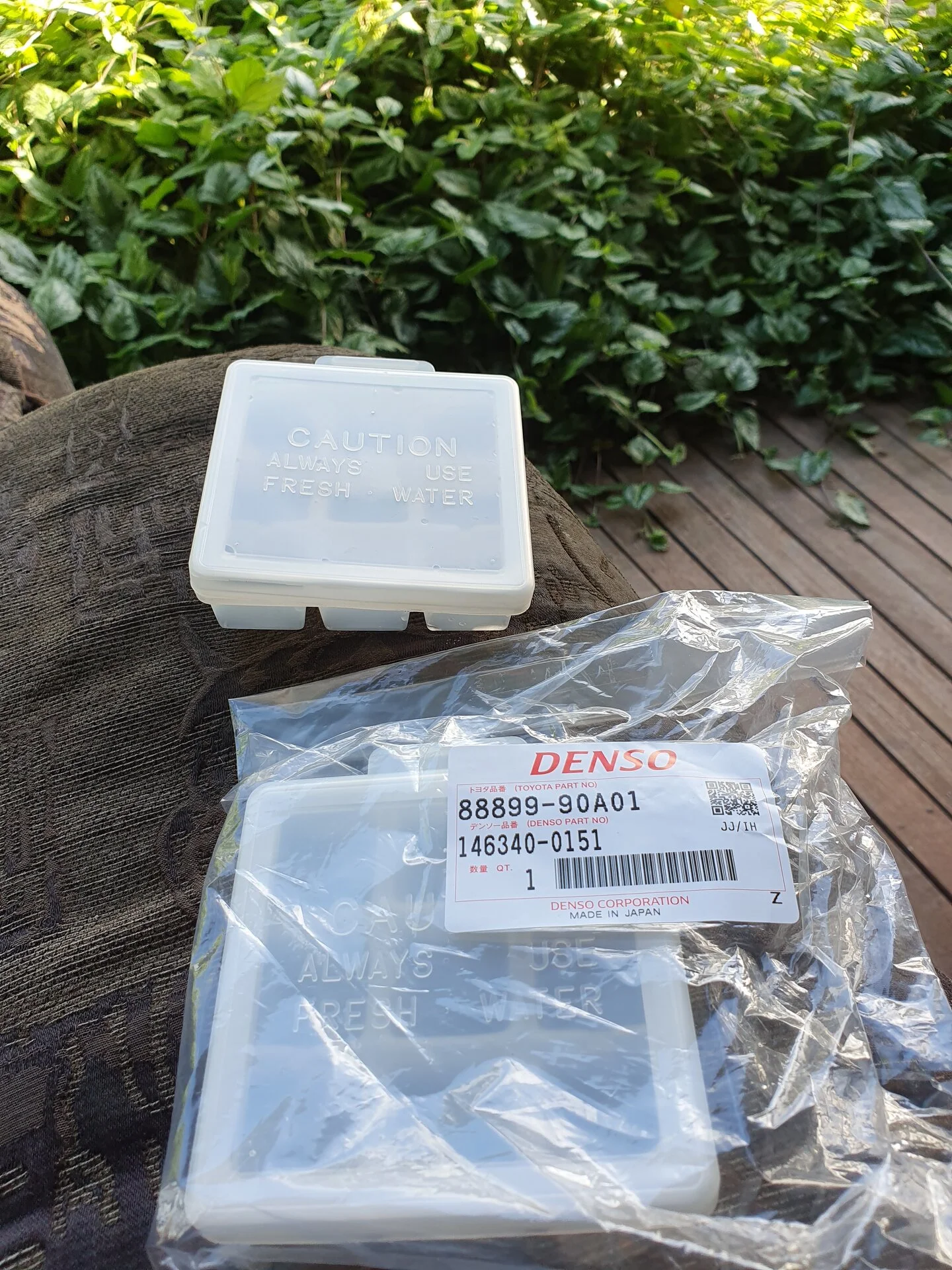

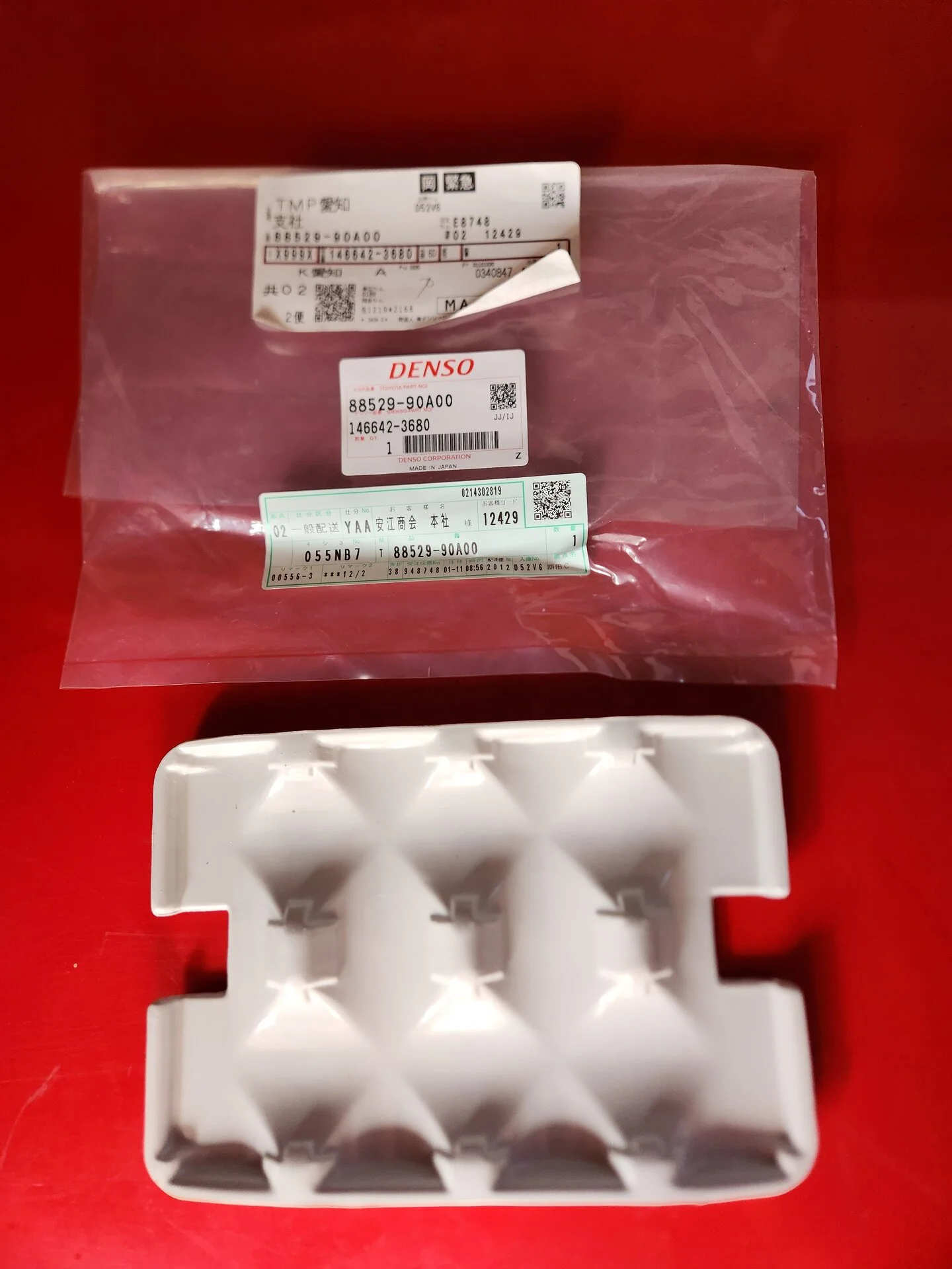

I have the genuine ice trays and bottom tray. The only thing I'm missing is the oem slide door that keeps the trays in place. I'm just using a piece of cardboard with a plastic type film on it at the moment.
I have never seen what the door actually looks like in real life, it seems to be the rarest part. But I doubt that's what's stopping them from freezing.
Also does anyone's ice/cool switch lights work??
I started pulling mine apart today and it has two lights in it, but I'm too scared to try and get them out as it's pretty brittle and if it breaks I'll never find a new one!
It's strange both lights don't work, I doubt they have been illuminated so much they both have blown! But it's possible and would be the easiest fix.
If anyone has any experience with the icebox and has actually made ice cubes please let me know how you did it!
