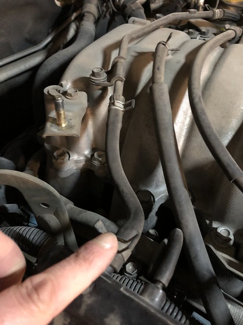

So one of the other things that happened this weekend was replacement of one of the vacuum lines that has cracked.. This is the larger rear most line the connects to the airbox and is one of the ones that is removed when you pull the intake/airbox tube. Both ends of the line were cracked a good 1 1/2" from the edge so cutting it down would not have done me any good as it is a pretty tight fit.
Untitled by Greg Fisicaro, on Flickr
Measured the size of the intake tube nipple as just about 8mm so I grabbed some 8mm ID vacuum line from BoostController.com (as well as some 6mm just in case) and threw that one. The 8mm ended up being a perfect fit.
Nothing too exciting but I am going to slowly go through the vacuum lines to replace them as 20yrs work of funk, heat and whatnot under the hood I am sure has made most have cracks, leaks or issues.
