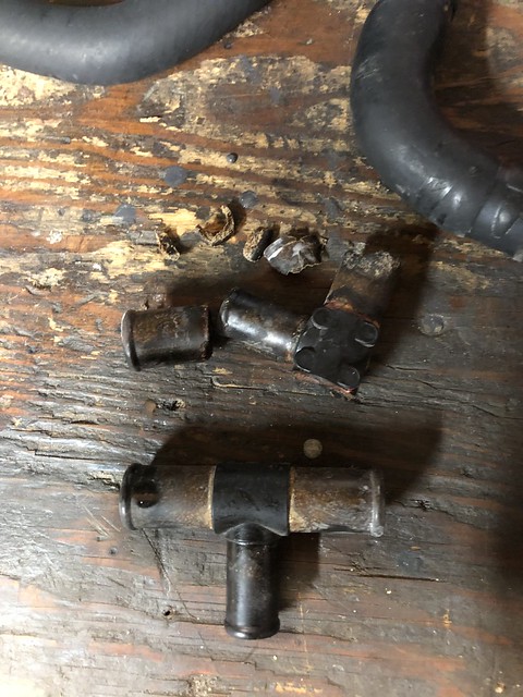

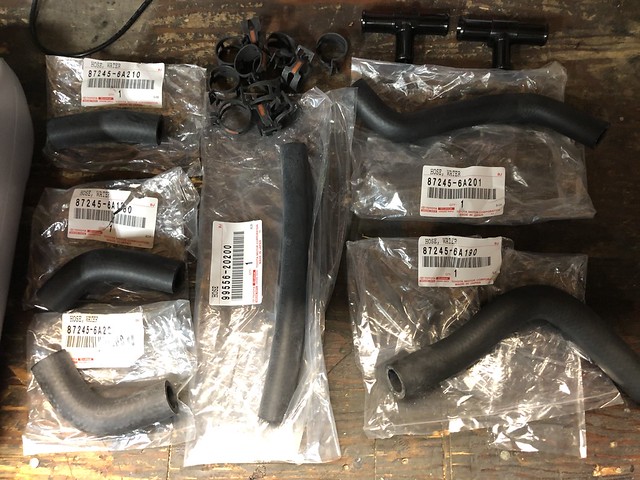

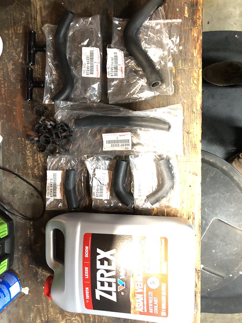

Finally got around to replacing the Heater T's and good thing I did. Hot side literally came apart in my hand as I was attempting to get the hose off it. But man was this job a PITA!! All together doing only took maybe an hour and a half but the longest part was waiting for the engine to cool.
Untitled by Greg Fisicaro, on Flickr
Tell tale pink staining around end of hoses....
And the break... once I got that size taken care of the left side of the T broke as well. Didn't disintegrate like the right but still busted easily.
And the aftermath!!
Got everything back together, filled her up with about 3/4 a gallon of pink stuff and let her idle in the driveway while I cleaned up the garage floor. Seemed like SOOOO much more came out of the system but that was all she wanted to take when I was trying to burp her. Luckily I had a large piece of cardboard that I placed under the truck to kinda catch everything. Quick run around town and the system is rock solid at mid-line and blowing nice hot air!
