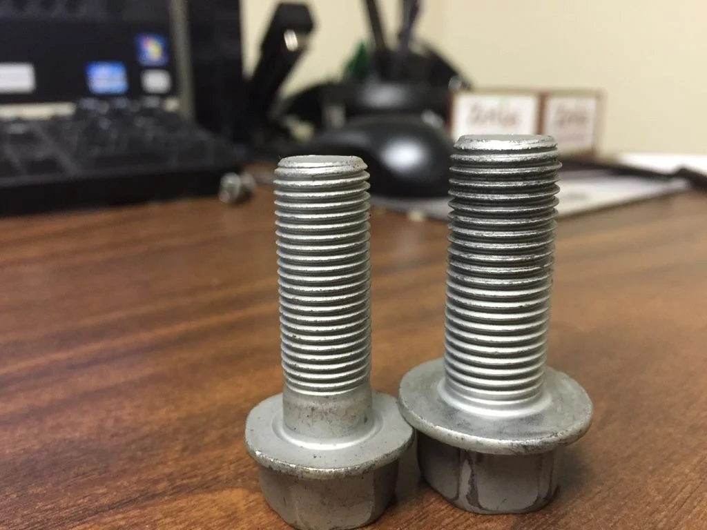

Heads up! If anyone is planning to do the 5th gen brake upgrade be sure NOT to get 2016 calilpers with a 14WB casting. You need the 14WA casting. They changed the caliper bolt size from 12mm to 14mm. I found some fresh 2016 calipers at a salvage yard and attempted to install them last night only to find this out.
Random pic I found of the different bolts:

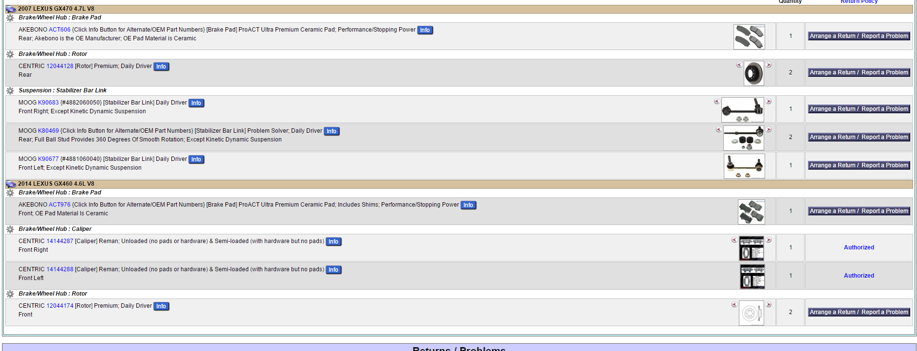

I spent $459 (including shipping and also getting a refund for the caliper cores). I went with these parts (price doesn't include the end links in my screenshot). So rebuilt front calipers, front rotors, front pads, rear rotors, rear pads.
