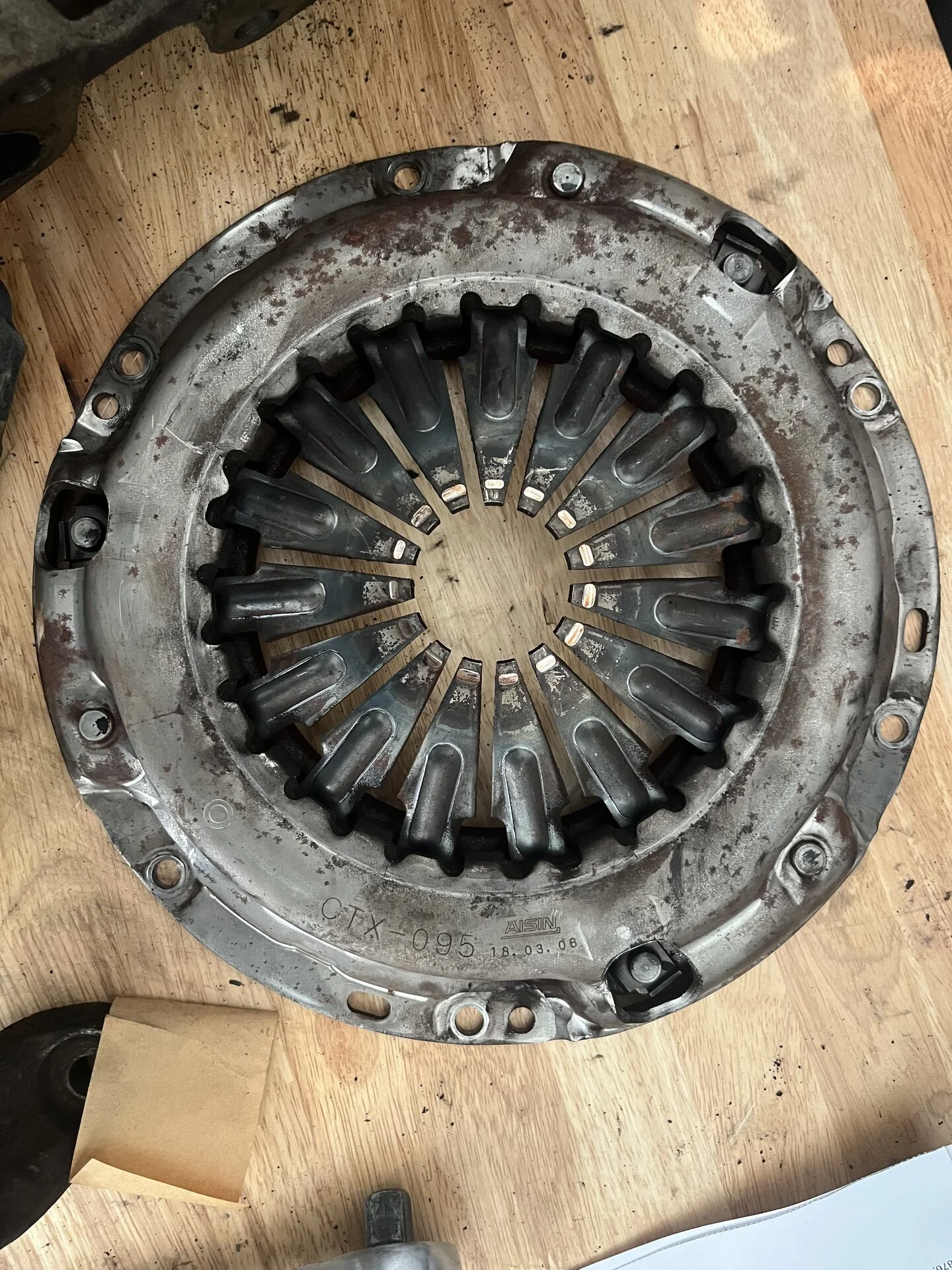

Trying find best place or local parts for clutch for 5L engine and it seems like pressure plate and clutch are not compatible to 22r trucks, which i was initially led to believe .
Dug through p/n and alternate part numbers
CTX-095 / 31210-35330- pressure plate
Dtx-126 / 31250-35301 - clutch

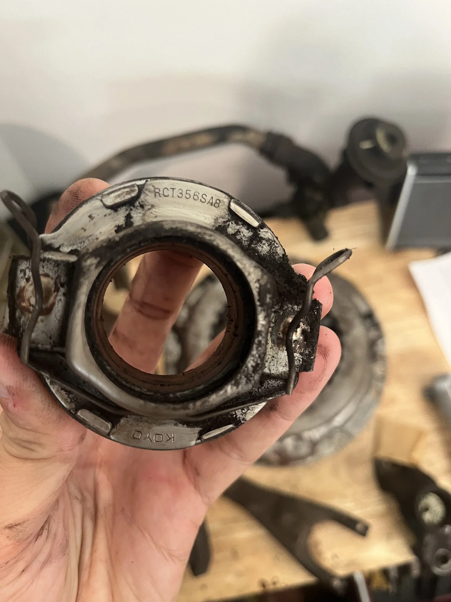

RTC356SA8 / 31230-22091 - bearing release
Update.
I found that clutches for 88-95 TOYOTA 4RUNNER PICKUP 2WD 4WD 93+ T100 with the 3VZE 3.0L SOHC V6 have clutch kits that will fit. Works well with over 500 miles in so far.
Crosses over with these part numbers
31210-35071, 3121035071, 31210-35192, CKT-016 061-9147 KF718-01 16-059
