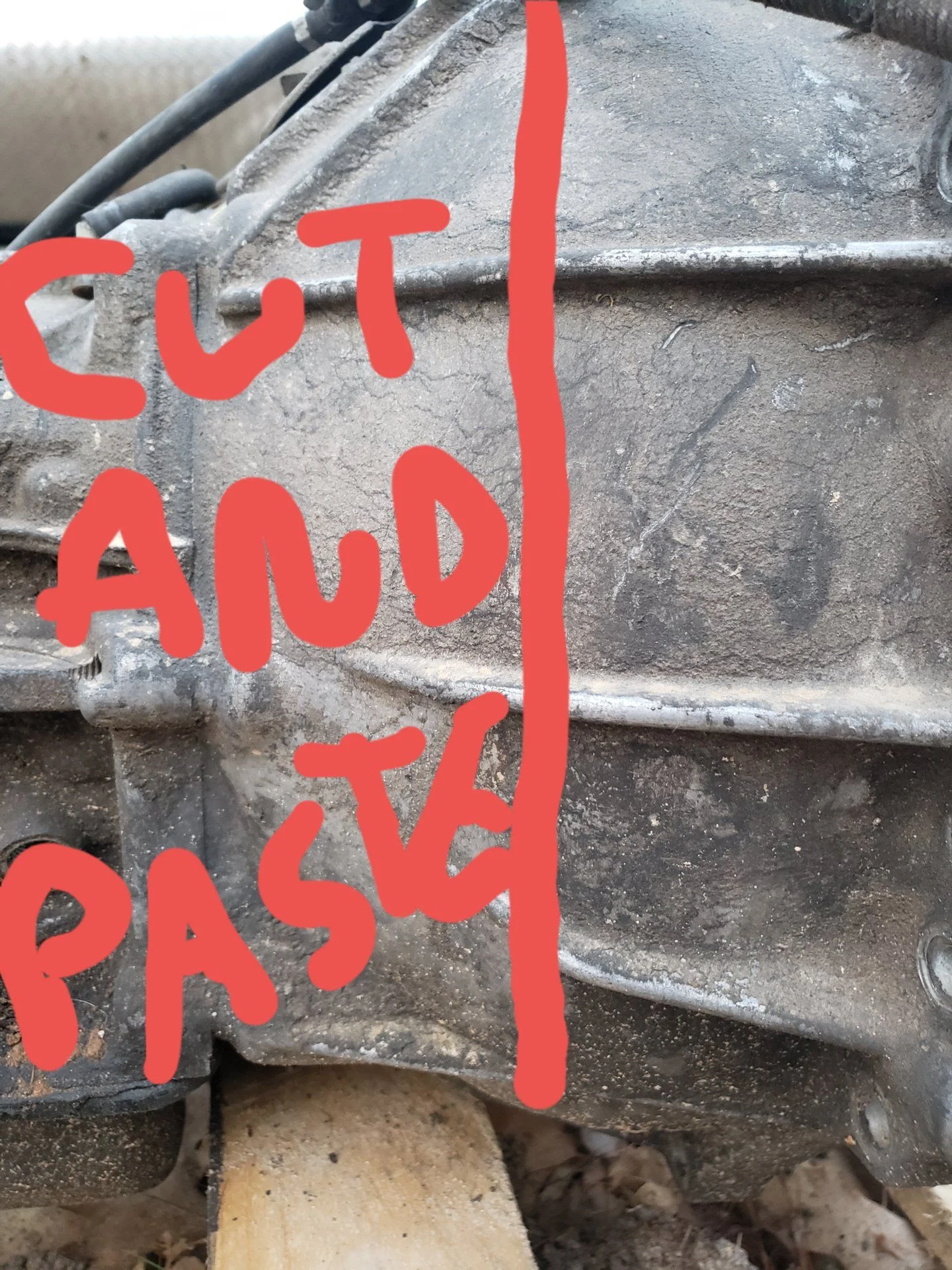

I took a look at my a343 spare I have and have a few questions and thoughts
Is the main transmission of the a750 the same length as the a343? Will the hf2a transfer case from my 80 bolt up to the a750?
I should know these answers and I am sure I read them but just didn't retain it I guess.
Sounds a little crazy but looking at the transmission, I am wondering if I could slice off the back of the a343 bellhousing and the front of the a750 bellhousing, then tig the two together for an adapter? I have the means to get it done by a machinist and excellent welder to where the surfaces could be parallel milled after to make it all perfect.
Just a thought
