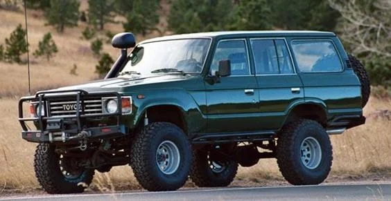

PRINCESS?!?
Watching intently. Back in the day this was one of the primary trucks that shaped the direction for moonshine.
If it is the Princess, what a dramatic change.... It reminds me of pictures of people before and after being addicted to meth. It was a beauty when @davegonz owned it
Three total paint jobs: the original "Tempered Gray", then 012 Super White, then Conniston Green. The 012 paint job was a cheapo (~$600) done by an airplane shop in AZ, I couldn't afford anything else at the time!
Good to see the old girl getting some love, lots of memories. Her original license plate is still on the wall of my garage.

You built such a venerable land cruiser that was so formative to the mud community.
It was difficult to see her in her current condition. But some therapy from Georg, Kelly and others should bring her back.

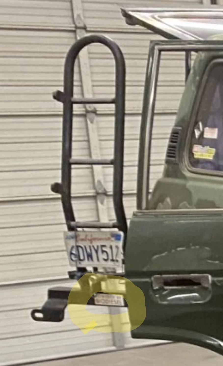

Can't believe this sticker is still there. Must be 12-13 years old!
