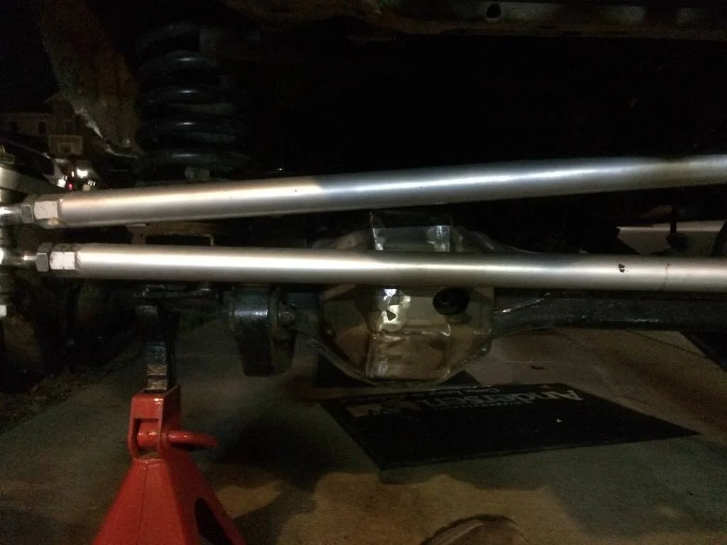

Best I could do on short notice.

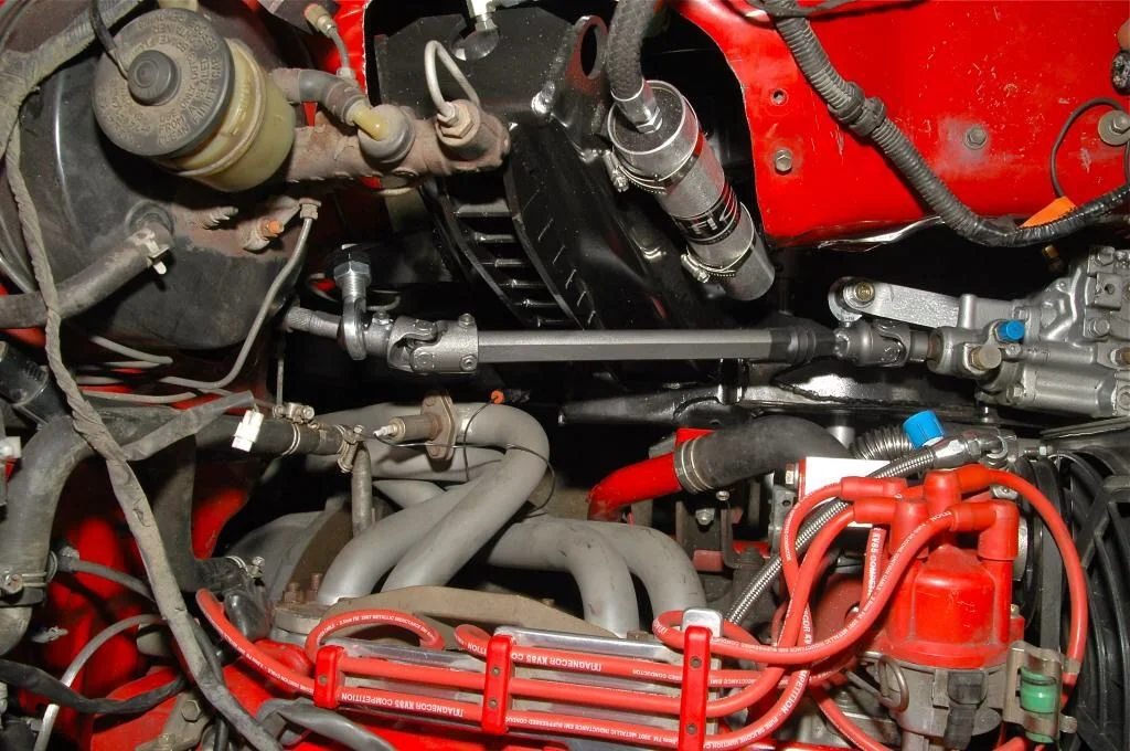

Unboxed Billy's stuff and did get short armed.
Prolly be a tad bit on the anal side, but half inclined to have two long arms made with the single front hole.
I don't like guessing which hole to stick things in. :)

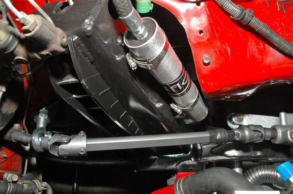

Similar to what I was talking about, ie double jointed driveshaft, but simpler and smaller.
Dunno what type of forces the shaft sees, but know my forearms were always tired after any kinda fun.

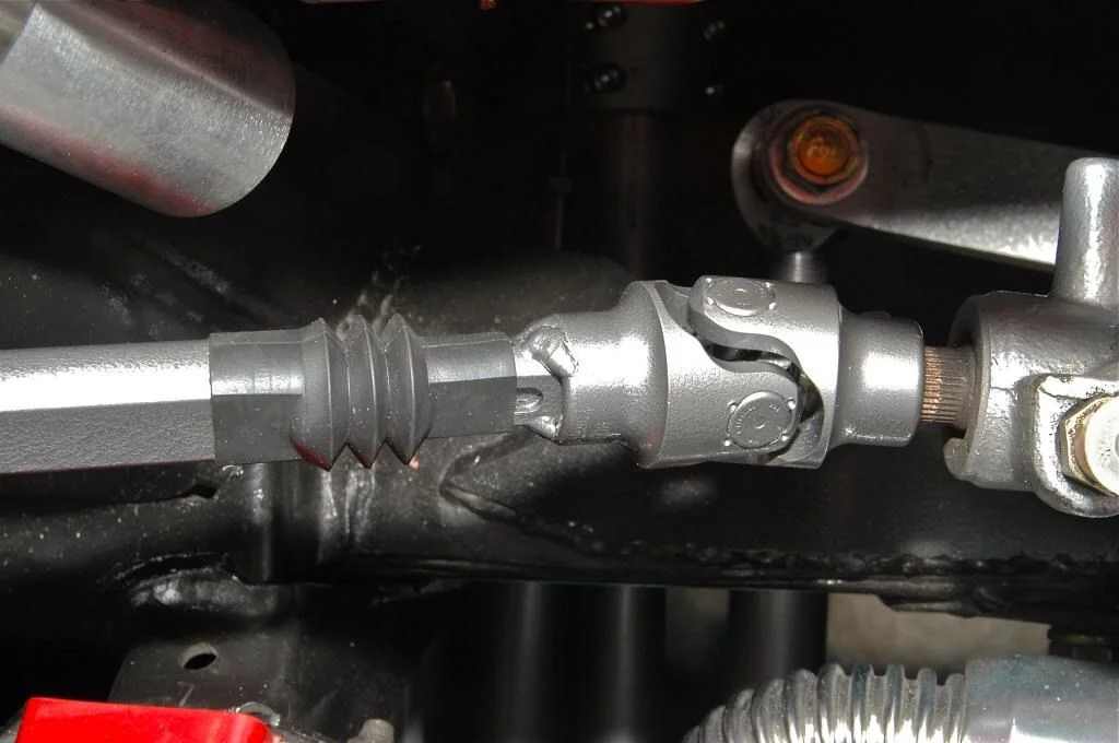

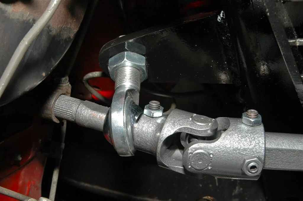

ha ha. Good point. As for u joints for the steering. Go get junk yard ones not the cheap Borgeson ones. My question is are you guys as a whole willing to do that? I can make an axle side mount in about an hour and provide the cobra towers in the kit if are willing and then everything is complete. But I would like the input of this crowd before I take the time to do so.
Sounds like a great idea and I can't speak for everybody but I've already dropped the money on towers and axle mounts unfortunately.

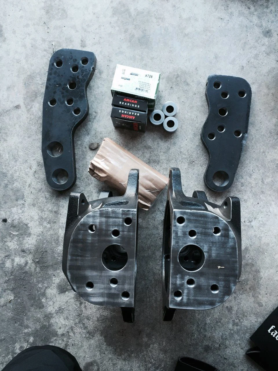

Okay so to everyone that has asked what steering do I need to run with this 3link lets go over the basics.
Factory steering will work though I recommend that after a certain point hi steer will be an asset to your performance. Lets call it after 3"s of lift I recommend going to high steer. I know Action Jackson did it with 6" and you can too I just recommend a high steer arm at some point.
Hell Fire Knuckles. First off let me say this any hi steer arm you buy will require you to run the drag link under that steering arm. This was done on purposes for clearance reasons and wheel travel. So hell Fire Knuckles require you to run the Drag link under the arm. The Hell Fire system is the only system that allows you to run TRE's instead of forcing you to run Heims. You can choose to run the tie rod in the factory location, or with a chevy Y style system or you can get the over seas arms and run the drag link in front but you will have to use heims with this last option because of limited space. We are fairly certain that you wont be able to get a TRE on top of the stock steering arm and a TRE under the hi steer arm. Just not enough room because of the tapered stud being built into them very unlike a bolt that slides thought a heim.
Slee Hi Steer. Chances are that the Chevy Y style wont work here since Slee arms are typically for heims. Beyond that the tie rod can go in front of the axle provided you have the over seas arm for double shear or behind the axle in the factory location. The drag link still needs to be under the hi steer arm.

Ok, cool. Ordered Slee Hi Steer arms today along with RHD lower. Just need to figure out heim joints and I'll be in business.
