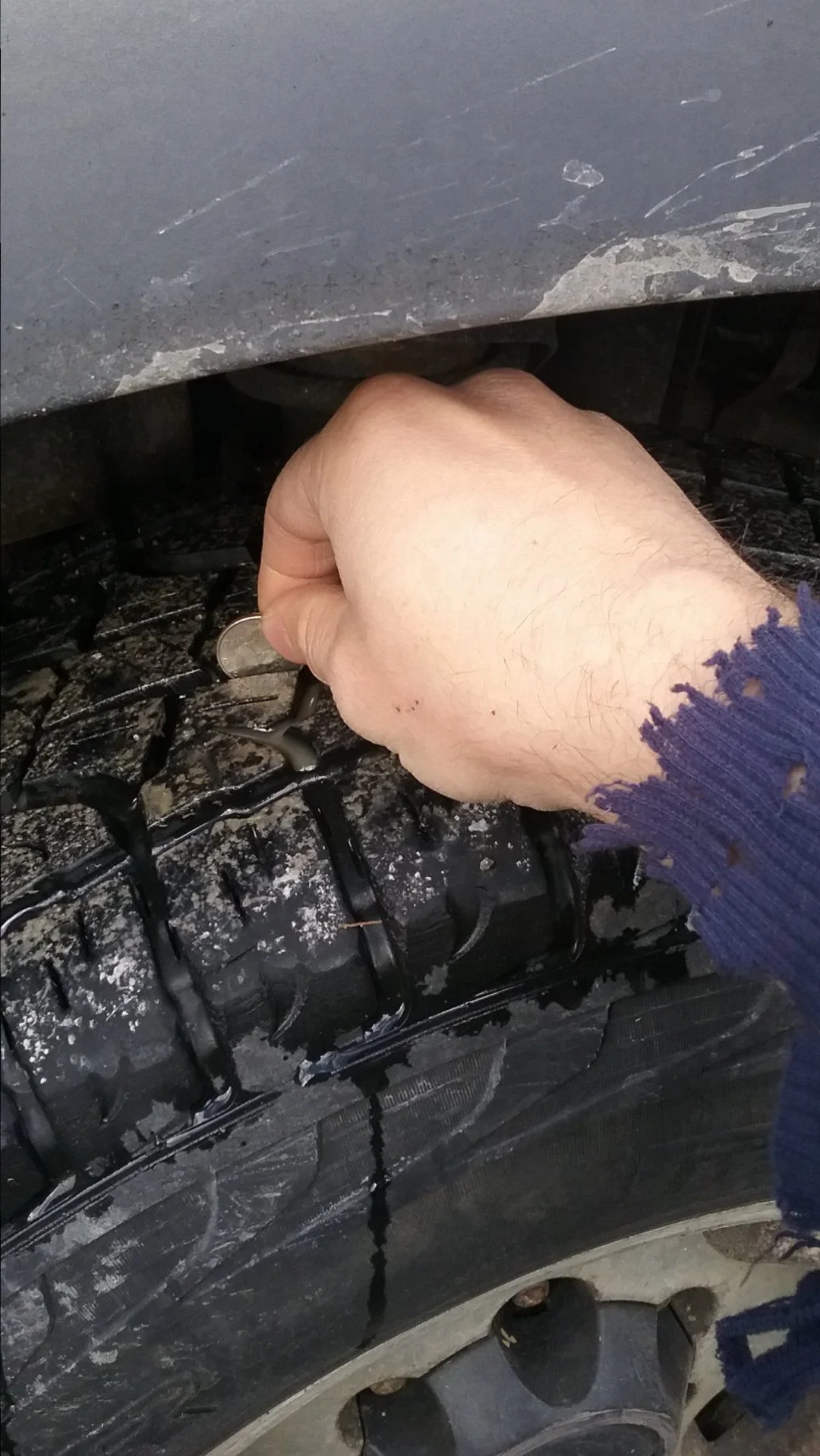

I locked the CDL put in P jacked up each tire. Fronts spin freely in both directions. Rear moves slightly in both directions before locking.

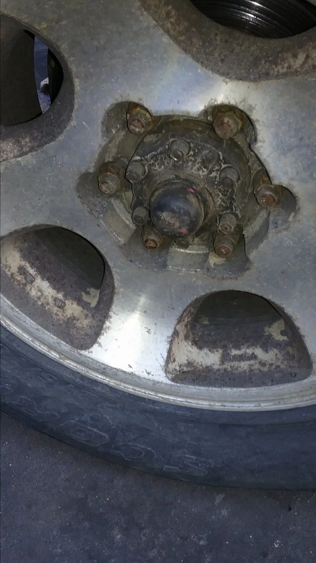

Yup, definitely connected. Can you pull the center caps and pull the birf end cap cover off to see if you see a birfield stub inside?

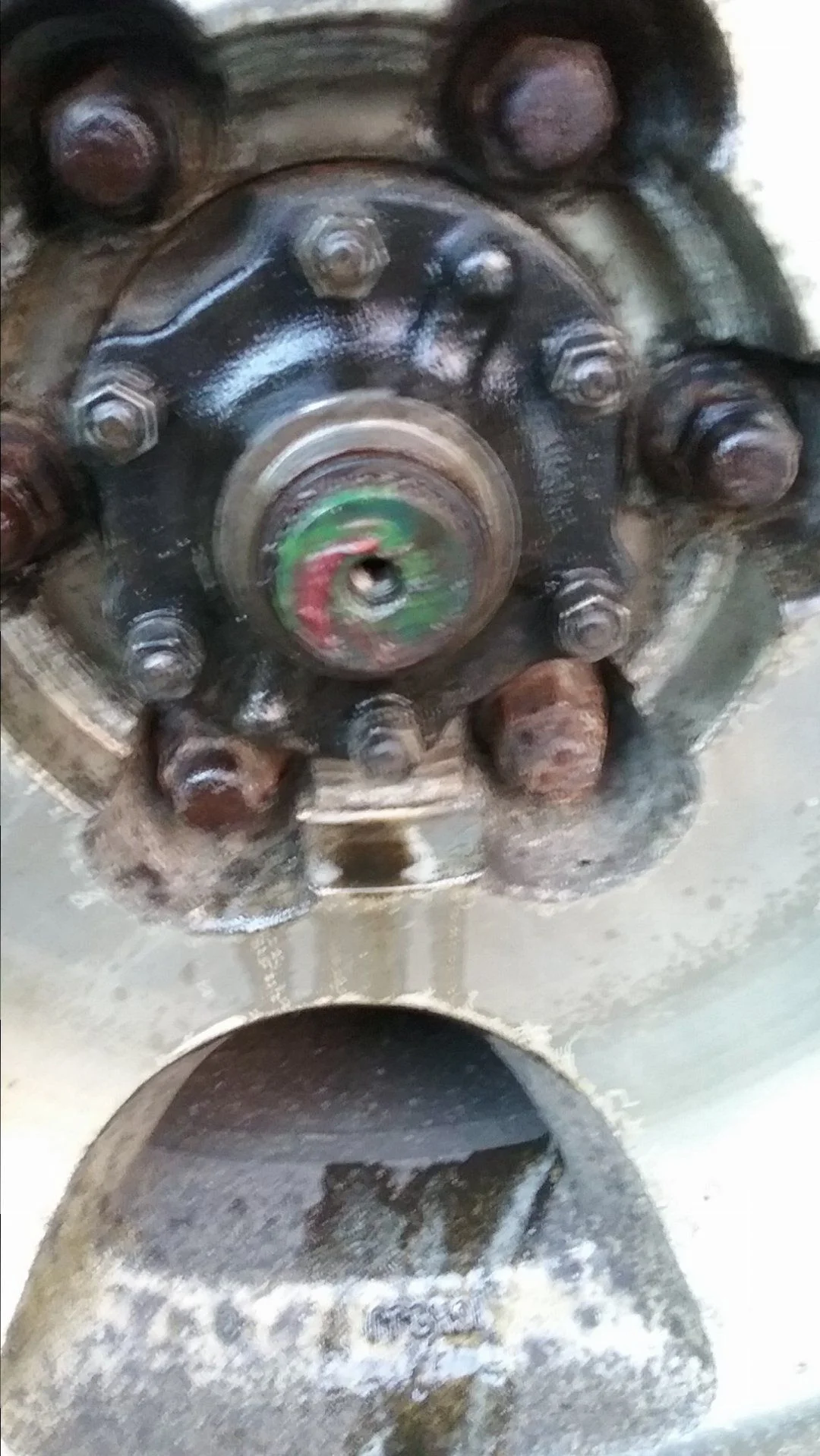

I'm guessing you mean to un bolt these 6 bolts? Also how do i get that cap off?
Just pull that little dust cap/dome off the center with some channel locks.
no..... dont undo those nuts and cone washers just yet.
The round dust cap will pop off with a rubber mallet, a flat edge may help to pry it off.

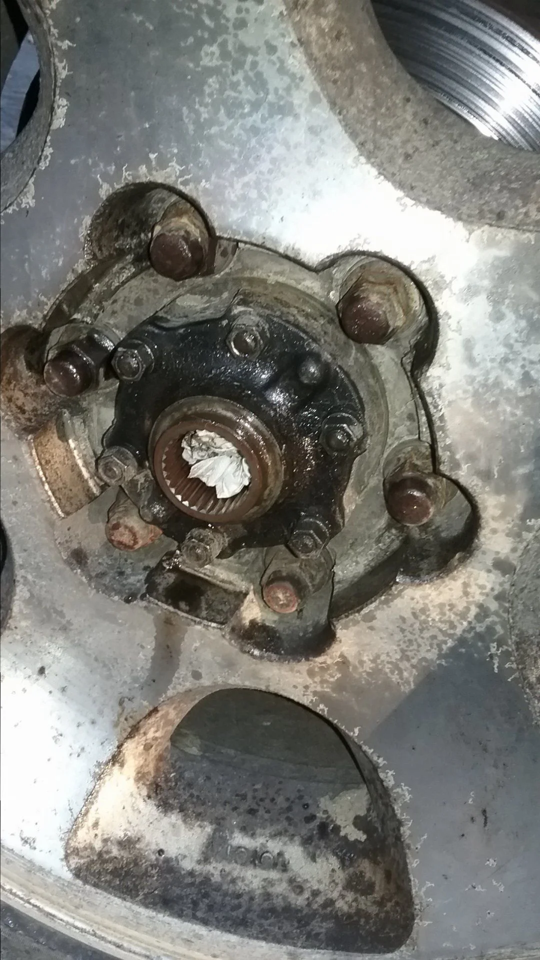

You will see (or should see unless its not there, hence your problem) the end of the birfield resting in the splined portion of your drive flange (thing held on with 6 nuts). Also this is one piece i was referencing that could be stripped of splines preventing front wheel power. However it is usually accompanied with a grinding noise when stripped so not sure this is your culprit. Also tends to work in reverse but not forward. Or low range like you specified because Center diff is locked when you go to LOW
I would pull the cap first to see if you can see the end of the birf along with the c-clip. You can get that cap off with a screwdriver and hammer.
That would explain your 2WD predicament....now to understand why somebody took the birfs out. I am suspecting damage to the front differential. Looks like you will be tearing into your front axle soon. Post updates for us.
This also explains why your truck rolls when you put it in park in 4H and it rolls, its because there are no birfs to hold the front axle to the wheels. With the center diff locked (in 4L) the rear tires hold the car in park.

Next steps are to pull the other cap and see if there is a birf in there. If there is not, pull your 3rd member differential and inspect for any damage on the gears, housing, center section. There has to be a reason why this was done.

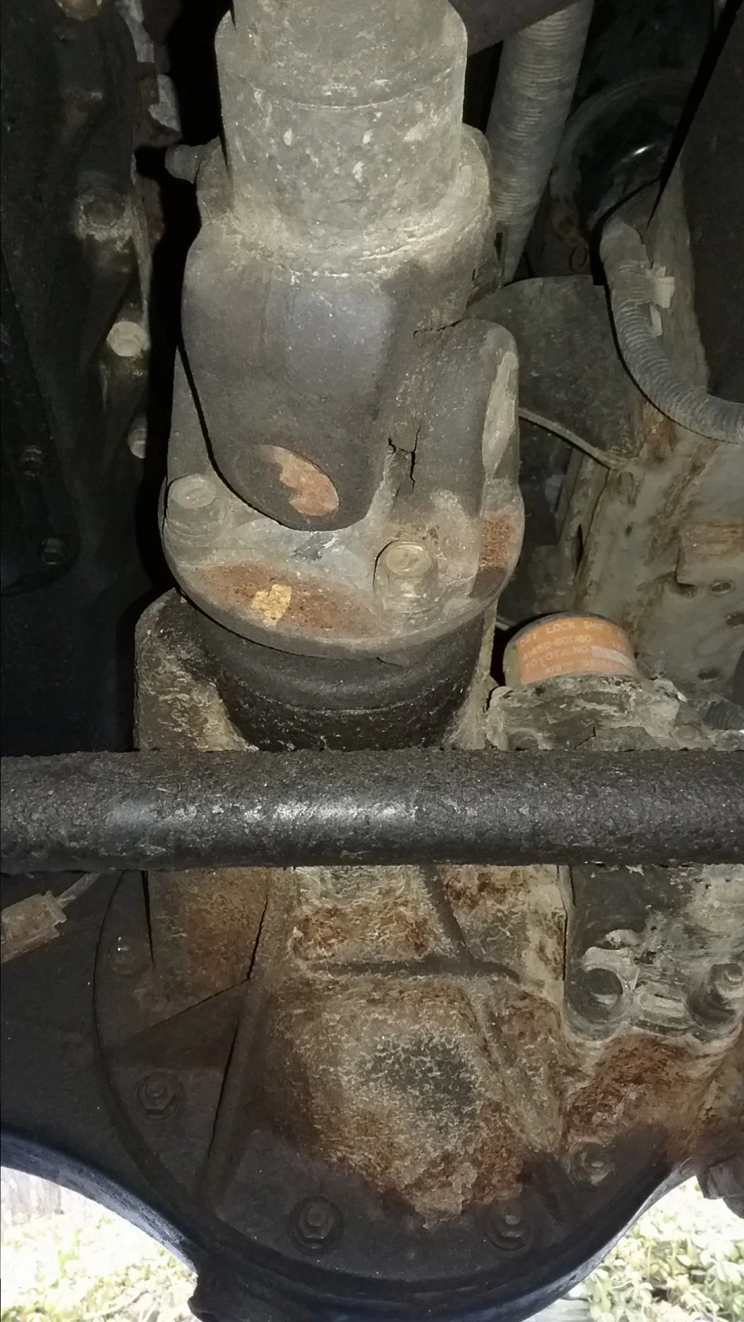

Here is what i found i the passenger side
