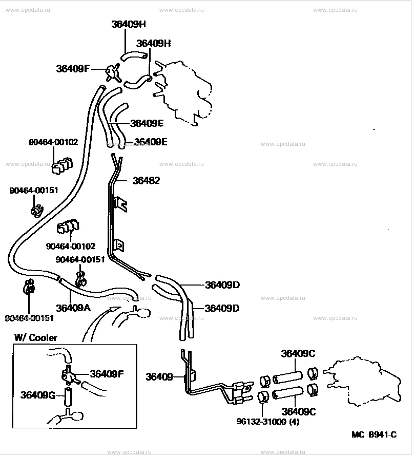

the light staying lit, most likely means the solenoid/switching valve is bad, you can get around it right now by switching the 2 vacumn lines and it will release, then switch the lines back.
there have been a few write ups about the fix for FJ62's which I'm thinking is the same as your BJ, only issue would be if it is 24 volt

So finally got it fixed. Wound up being a hole in the steel portion of line that runs proximal to the exhaust on its way to the transfer case etc. got it replaced and all is well. Wound up finding it with a vac gauge. Even still it wasn’t easy bc of check valves holding vacuum somehow.
Also realized with the resources you all presented that there have been several bypasses and tinkering done on the system in a non proper manner. So going to remedy that now and get it as it should be
