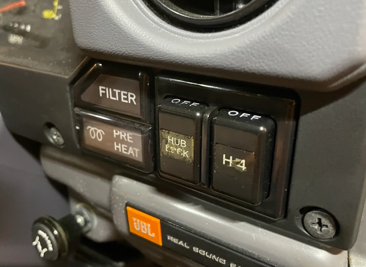

My 24V 4WD control switch (84724-60030) was starting to bother me in how ratty it looked:

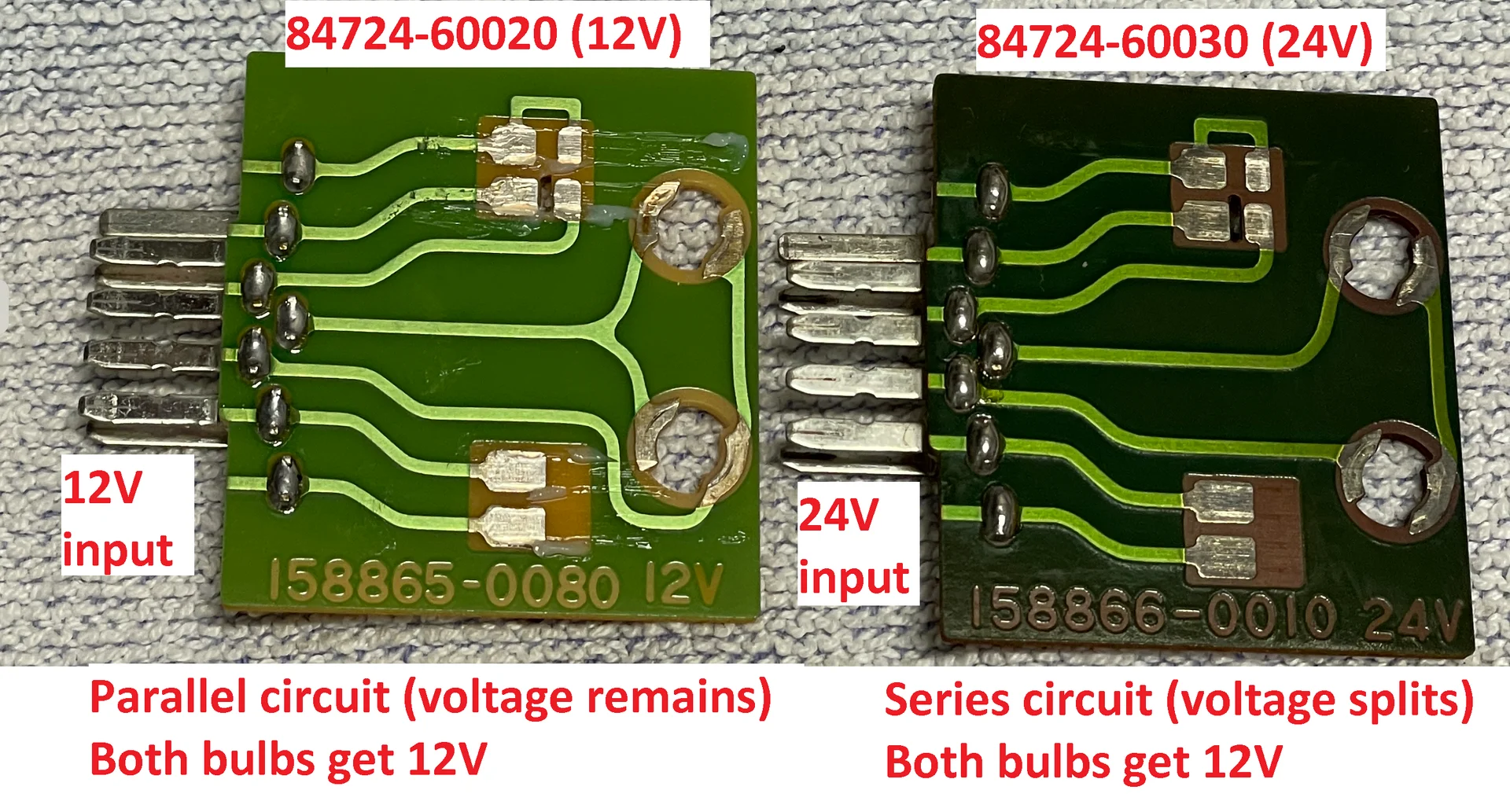

So, I ordered the 12V switch and stuck it in my 24V truck. Should work, right? Same bulbs! Yeah no, it didn't. The entire switch melted.

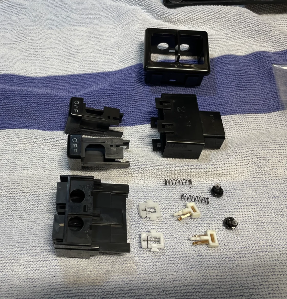

So, the 12V version definitely does not work in the 24V system. But how are the bulbs the same then? Both versions use the same 12V bulb. So, I bought yet another switch and took everything apart. Here is why they both use the same bulb. The voltage is split in the 24V version, so each bulb only gets half the voltage.
I swapped the 24 circuit board over to the new housing, and everything works great and looks great now.
If anyone knows where to get new Filter and Pre Heat NOS faceplates, hit me up.
