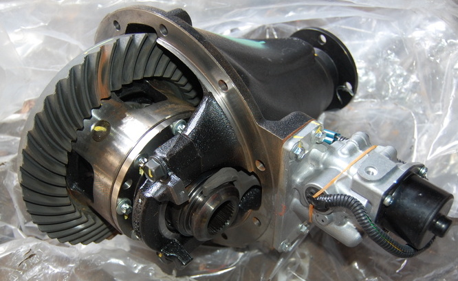

I wish I had a rear locker to worry about locking and un-locking. :(
I didn't get a factory locker on mine so installed an Australian LOKKA great pricewise had it installed at around 17k kms and done 95k kms with no problems. Bummer with the factory one is you have to be in low-range to engage it.
You can....
^ Is that 4.3 or 3.9 gear ratio?
if you install a locker would you just turn off all traction control prior to engaging it?
