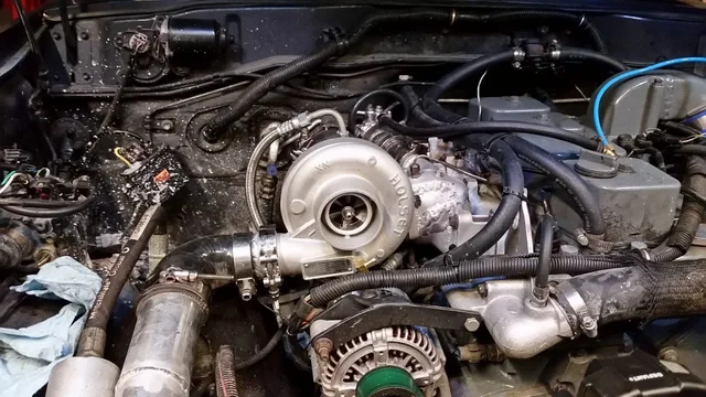

Got a little bit larger compressor on a new turbo to see if I can't get a little more top end power. Also test fitted an hx35 way to big of a turbo but I'm going to try it in a few weeks to see how the top end is and see if I can support it with a twin setup.
Haven't driven yet will double check installation tomorrow night and see how it does.
It's a 44mm inducer hx30 vs 40mm on my old. 4btswaps has some good info. There is a bigger version. Just not as common and more expensive.
