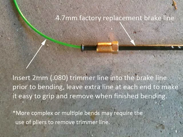

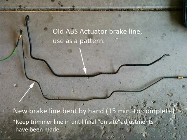

Oh Ive done my share of hand bending on a 95 4Runner. My method using weed wacker line works great to keep the tube walls from kinking/pinching and tools can be used when your thumbs become numb. $60 for a factory bent would be worth it vs. time to custom bend/flare, looks like I'm going to custom bend anyway.
