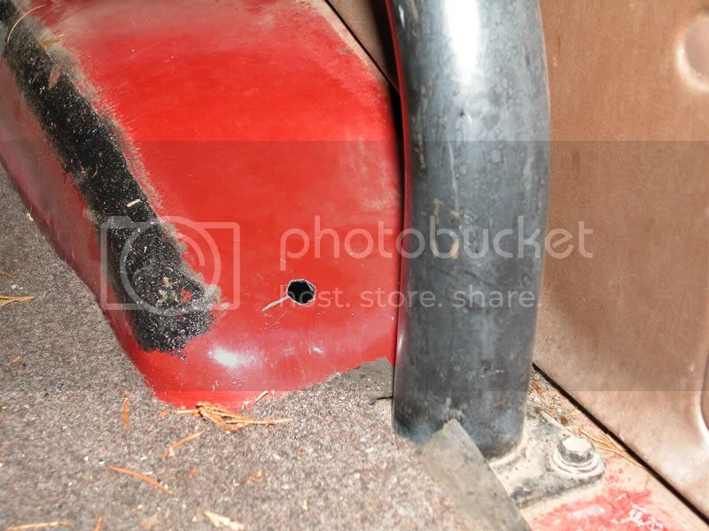

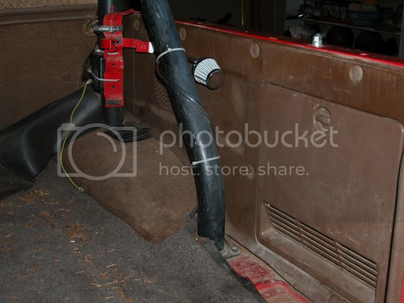

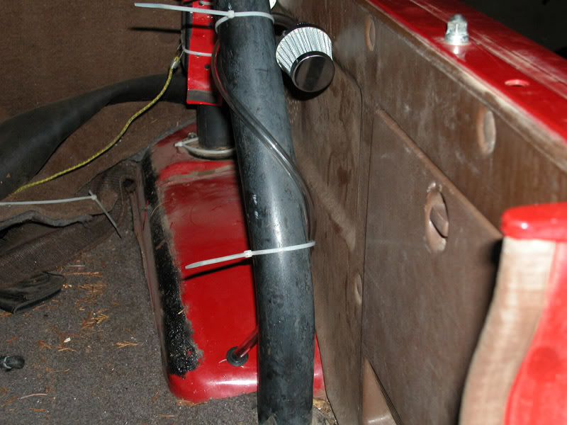

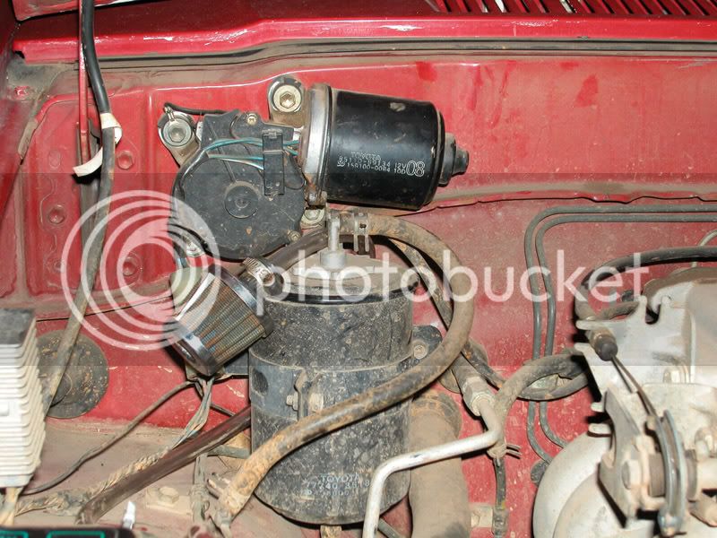

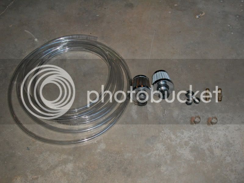

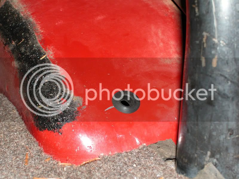

Nothing hardcore but in case anyone was looking for some ideas for their differential breathers, I thought I would show what I did with mine.
I picked up everything I needed at the local NAPA auto parts store. I just went through their different bins until I found the right fittings, gromits and hose clamps. Aside from the air filter (which now cost a whopping $7.99 each:rolleyes:) it shouldn't cost you any more than 5 bucks. The filters aren't mandatory though, I just use em because they are cleanable, work well and look bling bling :grinpimp:
Here is where I routed it in the front:
This is where I decided to route it in the back of my 4runner.
Drilled a hole (duh)
Insert gromit
and covered it up
Go ahead, thought it would be worth sharing in case any one needed ideas :)

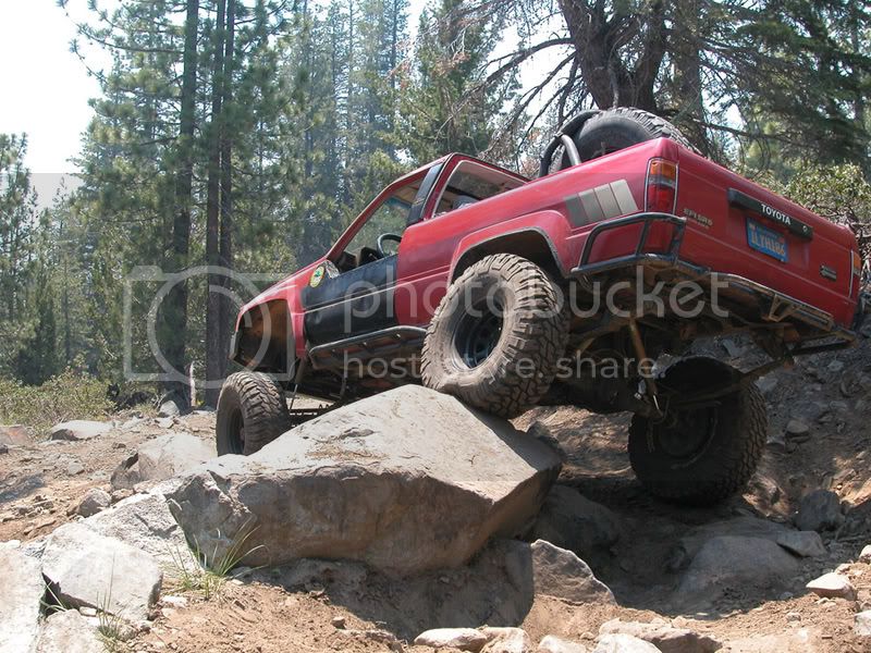

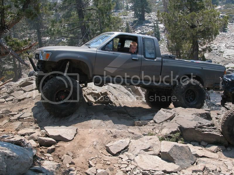

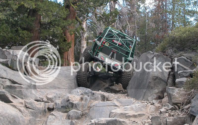

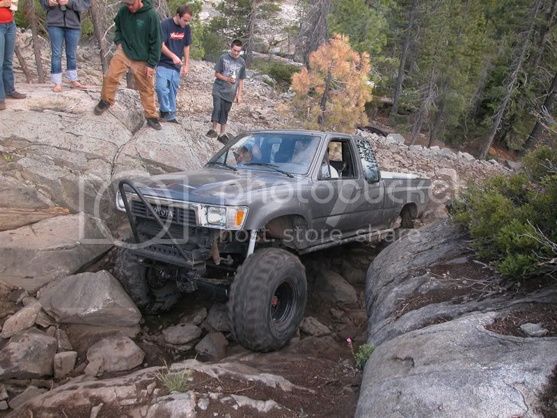

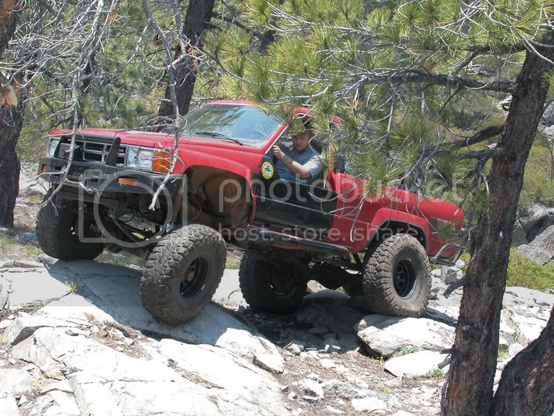

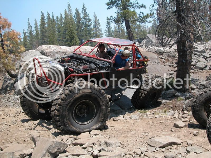

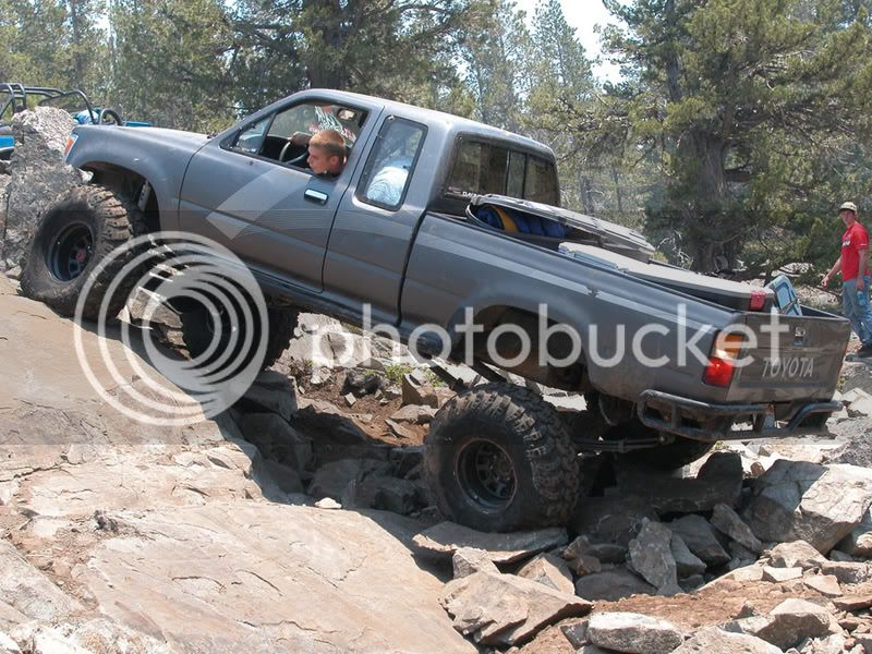

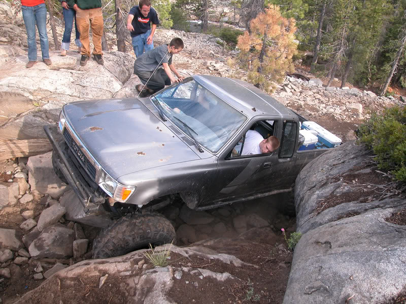

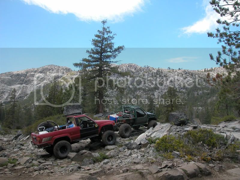

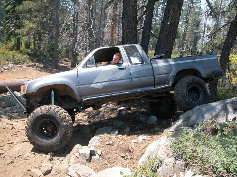

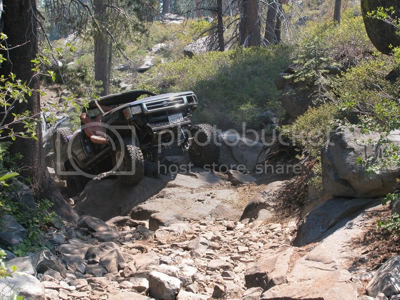

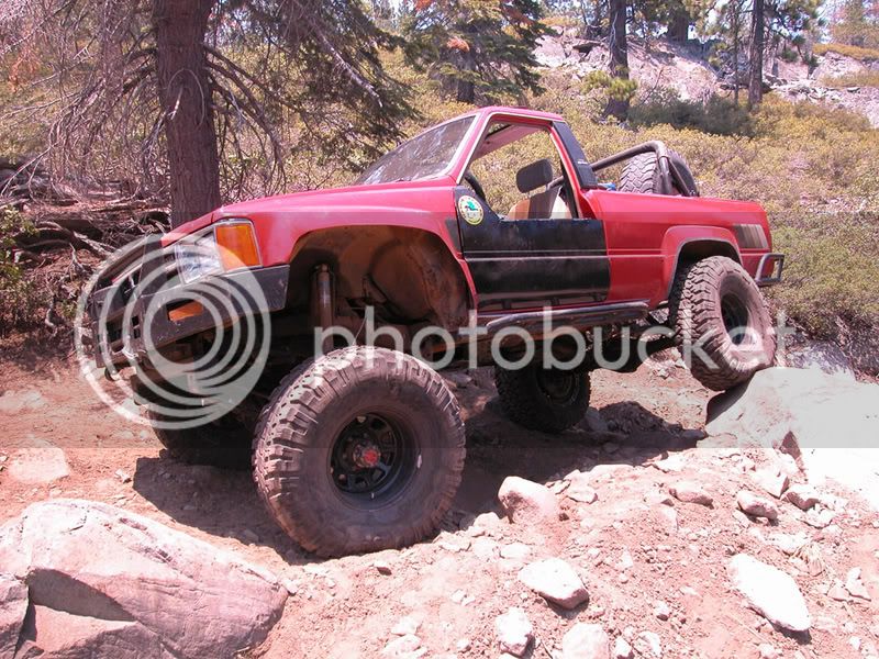

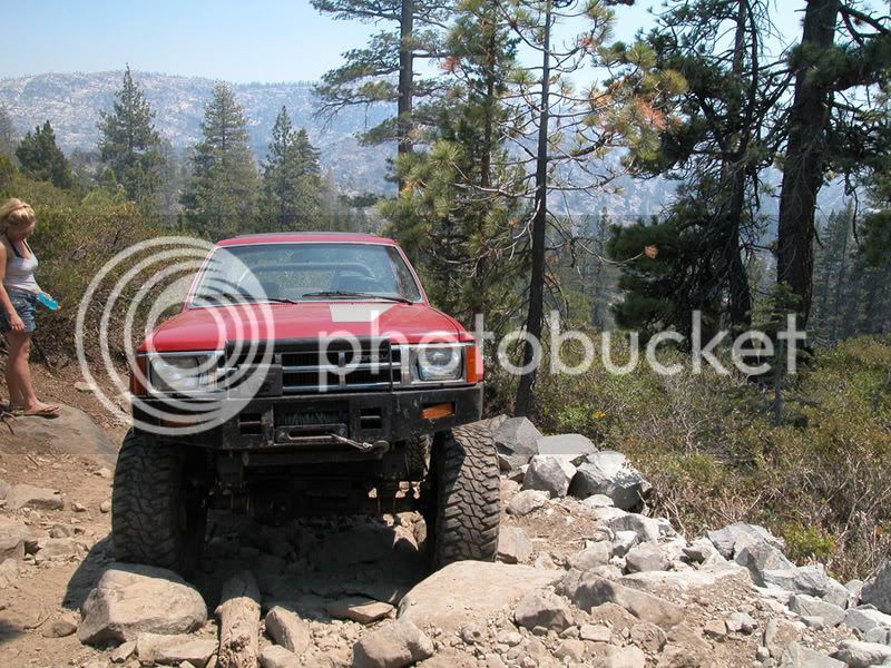

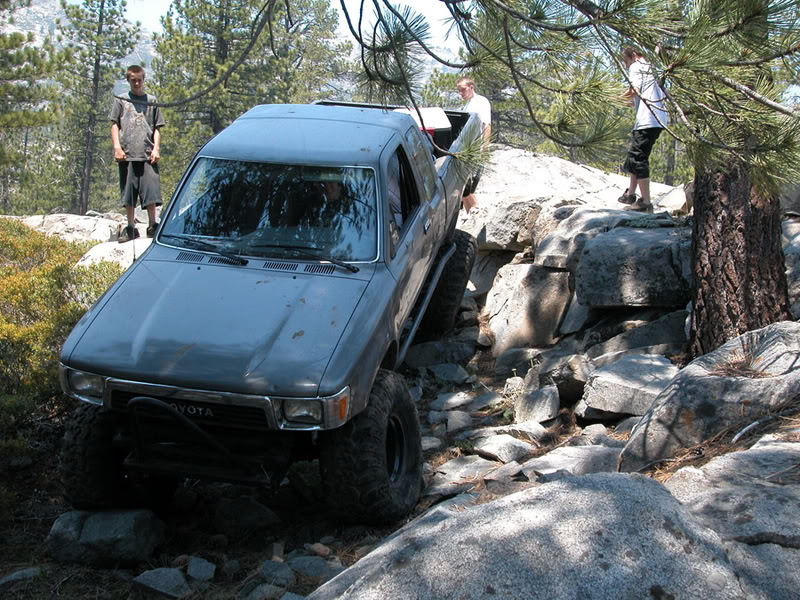

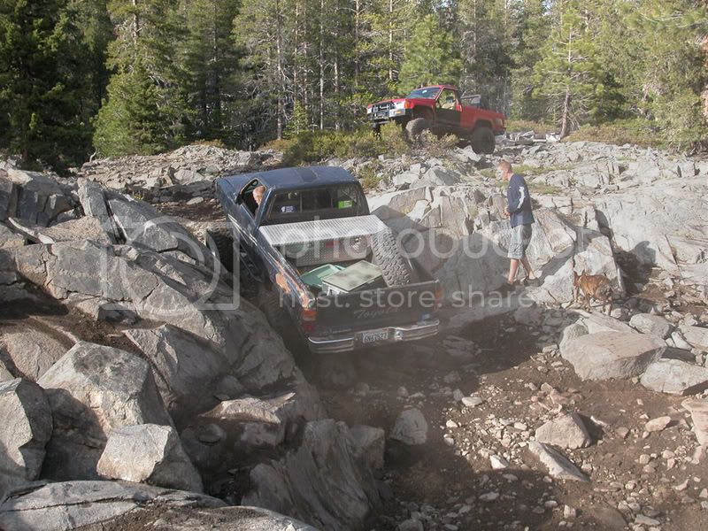

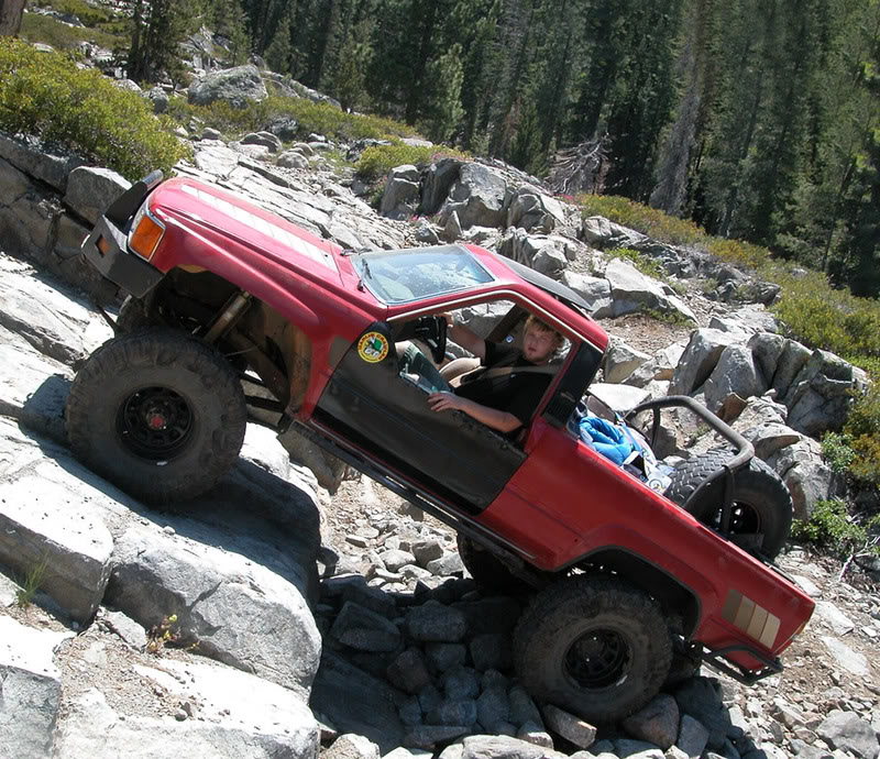

So anyway, like I mentioned we went to the 7th Annual Marlin Crawler Roundup last weekend. It was a blast. Met a ton of great people and had a really good time. It was all our first time to the Rubicon and we really liked the trail. I would like to get back there on a less packed weekend though, there was a lot of traffic on the trail (to be expected though hehe.
Here are the pics... didn't get many of my truck because I was driving all the time but I did get a few...
