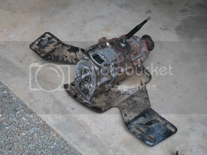

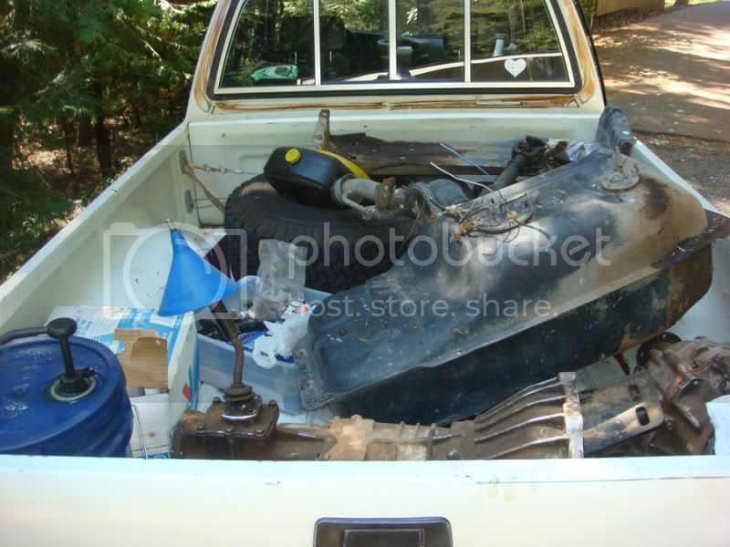

Finally after what seems like forever, the duals are back together. My original high range shift rail was bent so I had to find a new one, which took some time. My buddy Kyle got my cases all back together and ready to rock, now running 23 spline 4.7 gears :D
Now I just need to resurface my flywheel, install the Marlin HD clutch, reinstall my tranny and slap the duals back in. after that, I need a new fuel tank, tires and I need to fix my rear window, which stopped working for some reason.
After that I am ready for winter at least. Not gonna make it to MCR this year unfortunately.

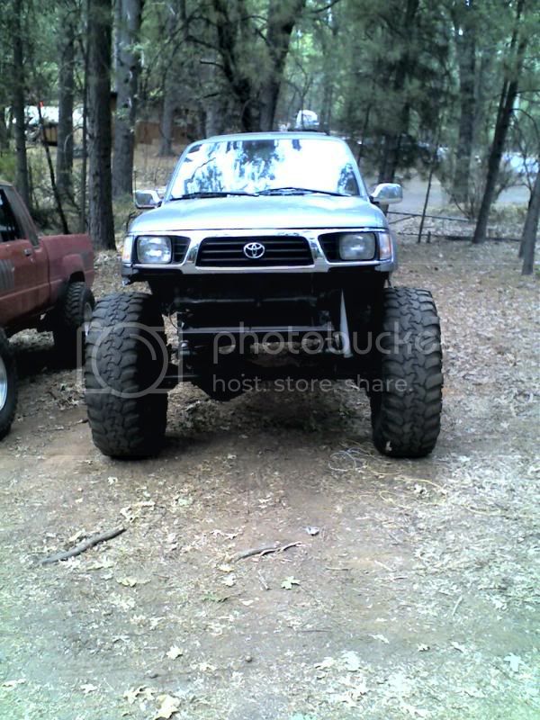

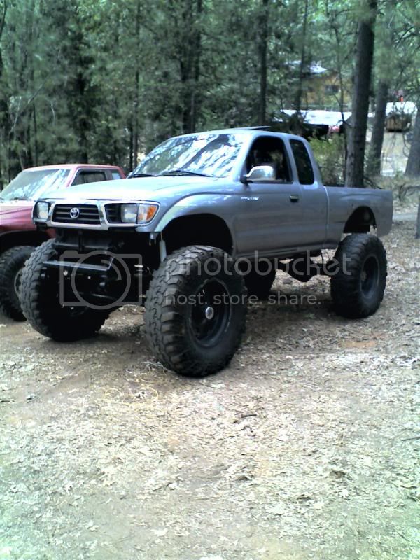

And this is Kyle's Tacoma he just got done building recently. 3.4, 5 speed with an inchworm adapter to a gear drive tcase with Marlin 4.7s. Dana 60/70 on 41 iroks with 20"rims. not usually a fan of big rims but it looks pretty cool actually.

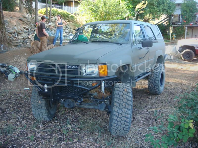

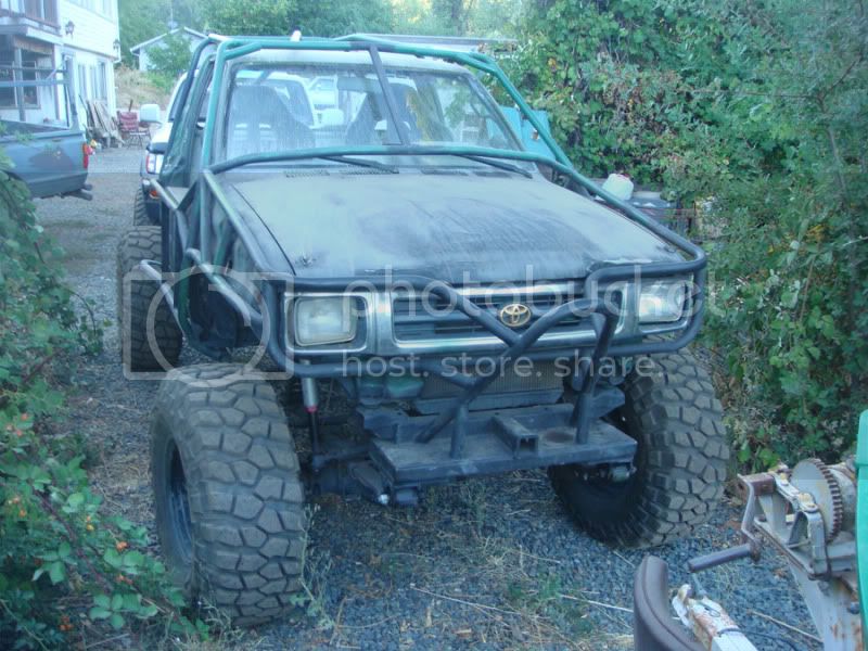

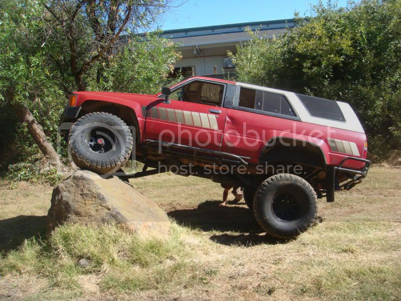

After a year on hold while I sorted out my life, school, and finances, I finally got the 4runner back together.
Here is the run down on what got accomplished recently:
New Marlin 1600 HD clutch, new throwout bearing (the CF pilot still looked brand new)
Tranny back in
:turtle: Duals back in, now with 23 spline coupler and rear 4.7 case gears
New (used) gas tank
New tcase mount
Couple good wacks on the starter and a half a quart of 10w30 and the girl fired right up. Love my OG, 10 year old Red Top Optima. *:biggthumpup:

Testing out the new duals:

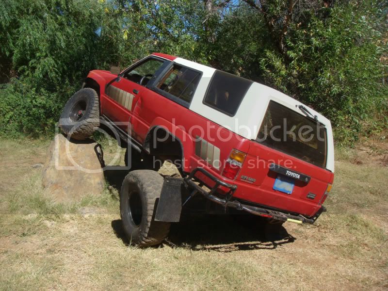

This is the 4runner Wade built as a gift for his dad over the last 3 years. He's definitely the coolest old man I've seen driving around Grass Valley *:cool:
