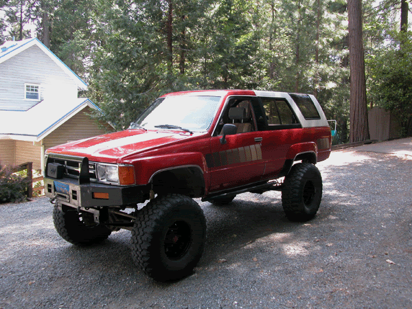

Basicaly I wanted a stock, or near stock 85. Had to have fuel injection and had to be clean. The rest was more or less up to fate. I hated red, but somehow that is what I ended up with. The rest is history. So enough crap here is my 4runner and my condensed build up.

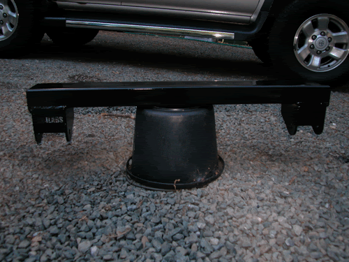

[ * ]Marlin Crawler Dual case crossmember

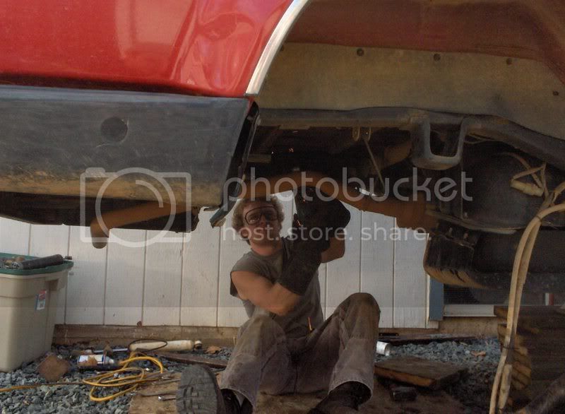

So here it goes. Sold my 32" meats and rims and slapped on some 30" racing slicks. Loaded up the 4runner with all my junk and head off to my friend Wade's house. Wade owns the welder and would be helping me with the build up.
A big thanks to Wade, Kyle, Evan, Wyatt, Adam, Luke, and Ben for all their help during the month or two it took to get this project "done."
Getting ready to roll out.
MMmm...parts :bounce:

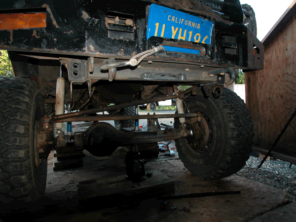

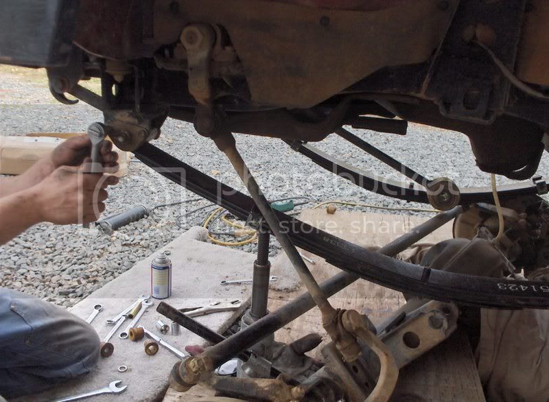

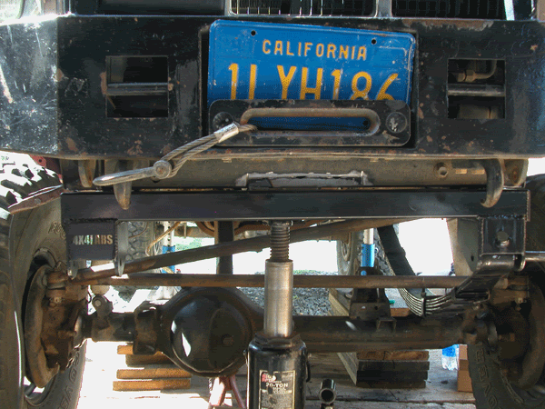

Had to hack the exhaust a bit shorter to clear the dual shackle setup i wanted to run with the 63s.
There goes the old bumper, it wouldnt work with the dual shackles either. Looks like I have an excuse to buy a Marlin Crawler DOM rear bumper! :D
This is backyard mechanics at its best :D
Got the shock mounts in place and the 5125s mounted.

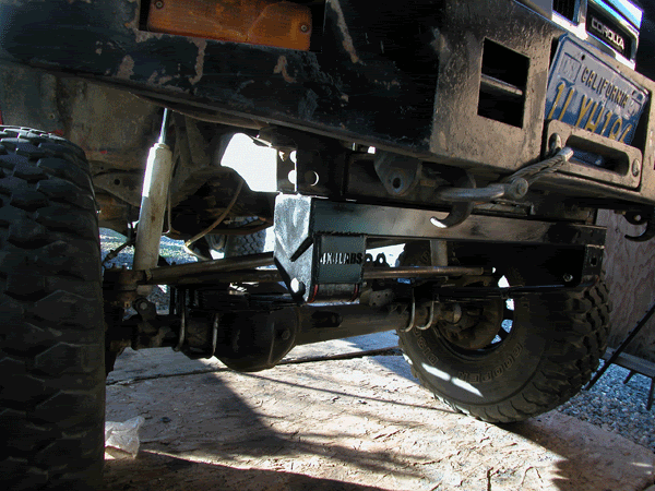

Here is the Marlin Crawler high steer.
Still havnt painted my tie rods, :censor: I'm a lazy bastard.

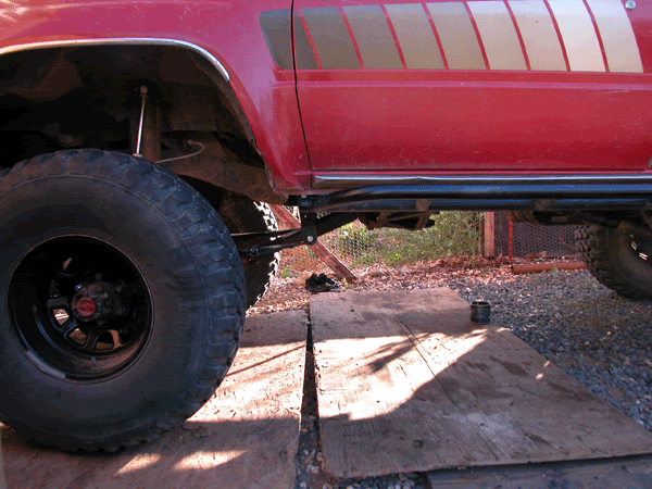

Homebrewed square driveline for up front. I didnt want to waste money on a custom driveline until I go dual cases. For now I am going to wheel it with a the single 4.70 tcase. Theres a peek at the MC sliders too. For $107 bucks shipped to my door the MC sliders (when on sale) can't be beat!

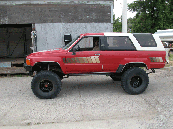

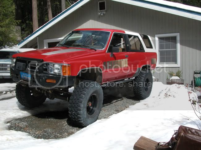

Backyard mechanics my eye...... you have gravel!!!! Ya yuppie!! :D Looks great man!!! :cheers: What size tires are you going to run on this monster?
35x12.50s.
Down the road I think I might just make the leap to 37s, but this rig is my daily driver for now and so far the 35s have been more than adequate for my needs.

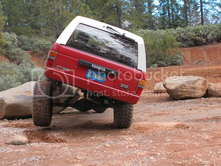

Got some decent snow last winter, not as much as we should have gotten but enough to have some fun.....
Ended up finding a smoking deal on some 35x12.50 cooper mud terrains on 15x8 rockcrawlers. Found em about 2 weeks before the heavy snow started falling...

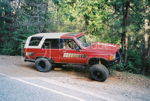

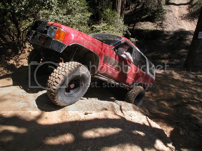

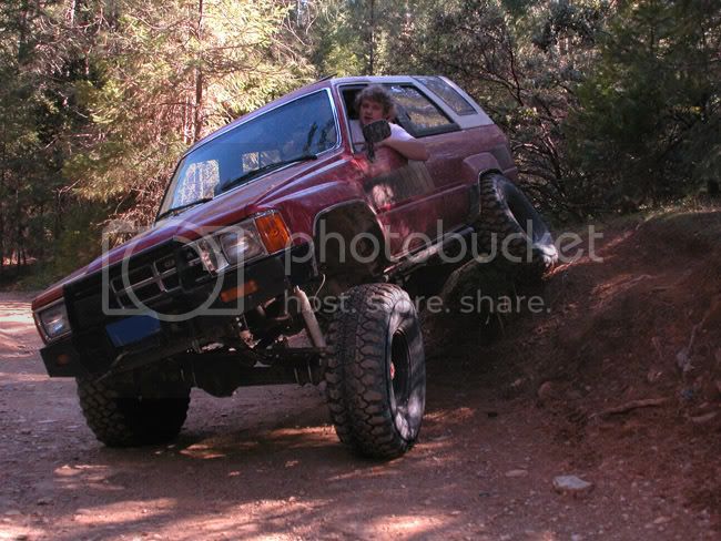

Here are some wheeling shots from spring of 2007. After the snow melted I was eager to see what my rig could do. I was pretty impressed aside from the front YJ lift springs. They were just too stiff for my liking. So I decided to swap with some 44044s. I also wanted to move my axle foreward.
