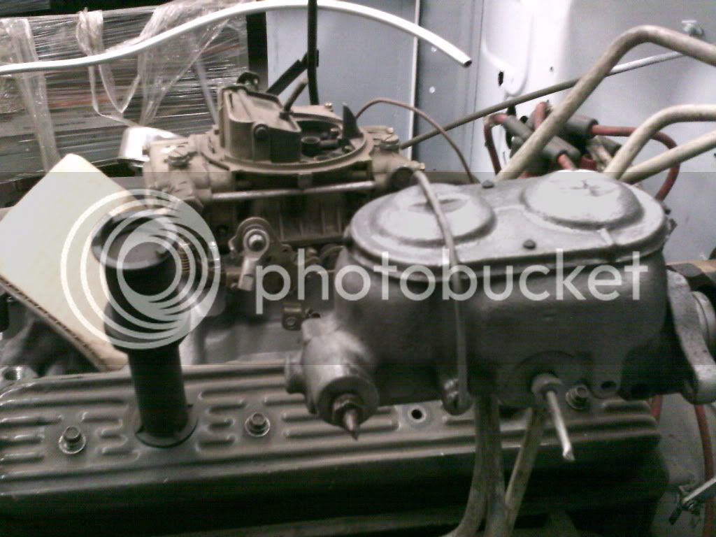

Picked up the spool valve and springs that were lost for the hydroboost and grabbed a hydroboost master as well. It cleaned up OK.
