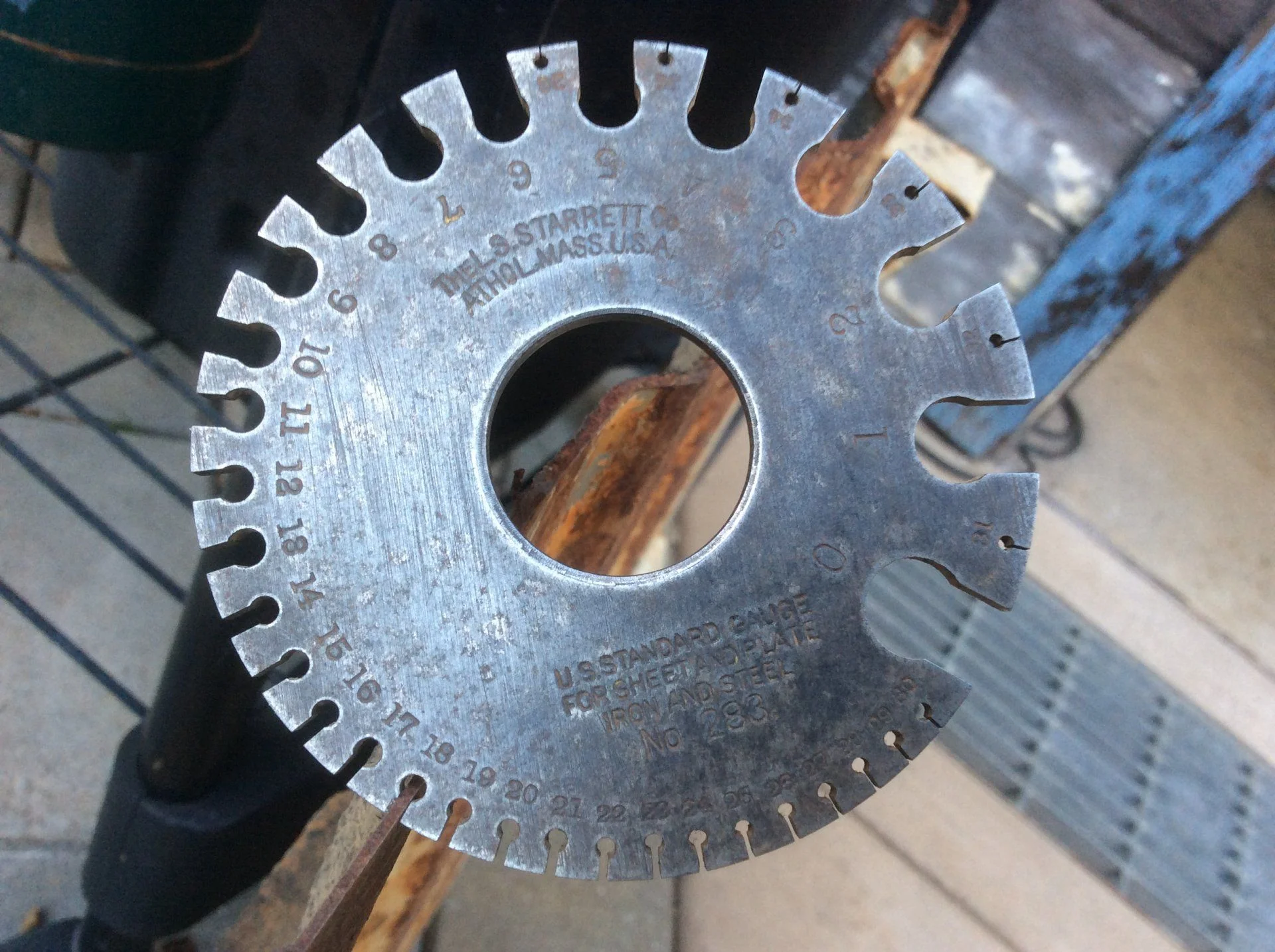

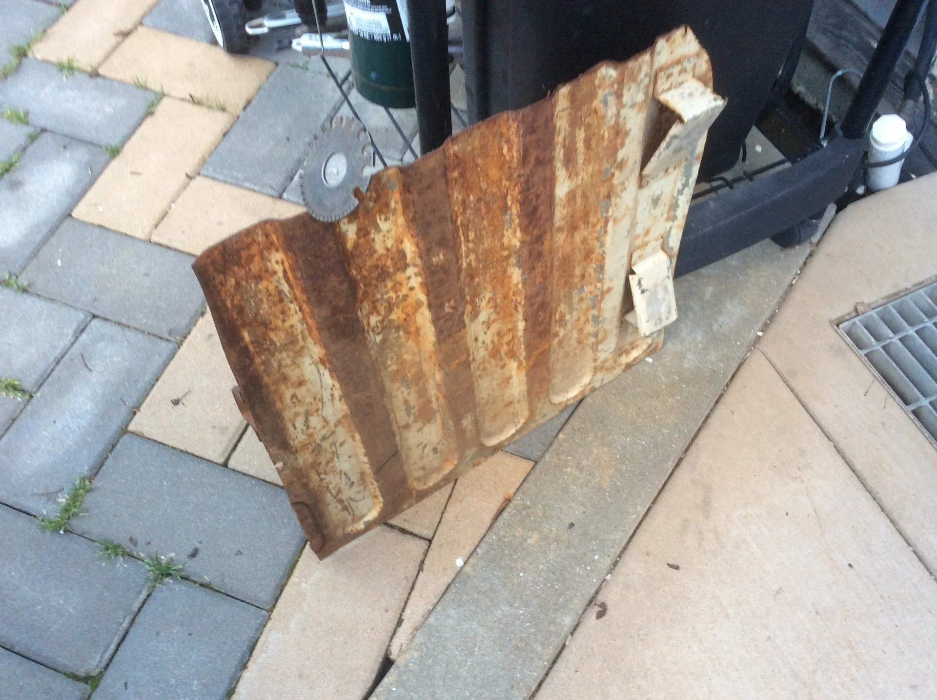

This a piece from the rear floor near the spare tire carrier. Looks to be 18 gauge.
Thanks for taking the time to measure it. It's time to buy a pile of 18 gauge sheet metal because it will probably take me 3 attempts or more to create the shapes I need. The only way to learn is to try it!
