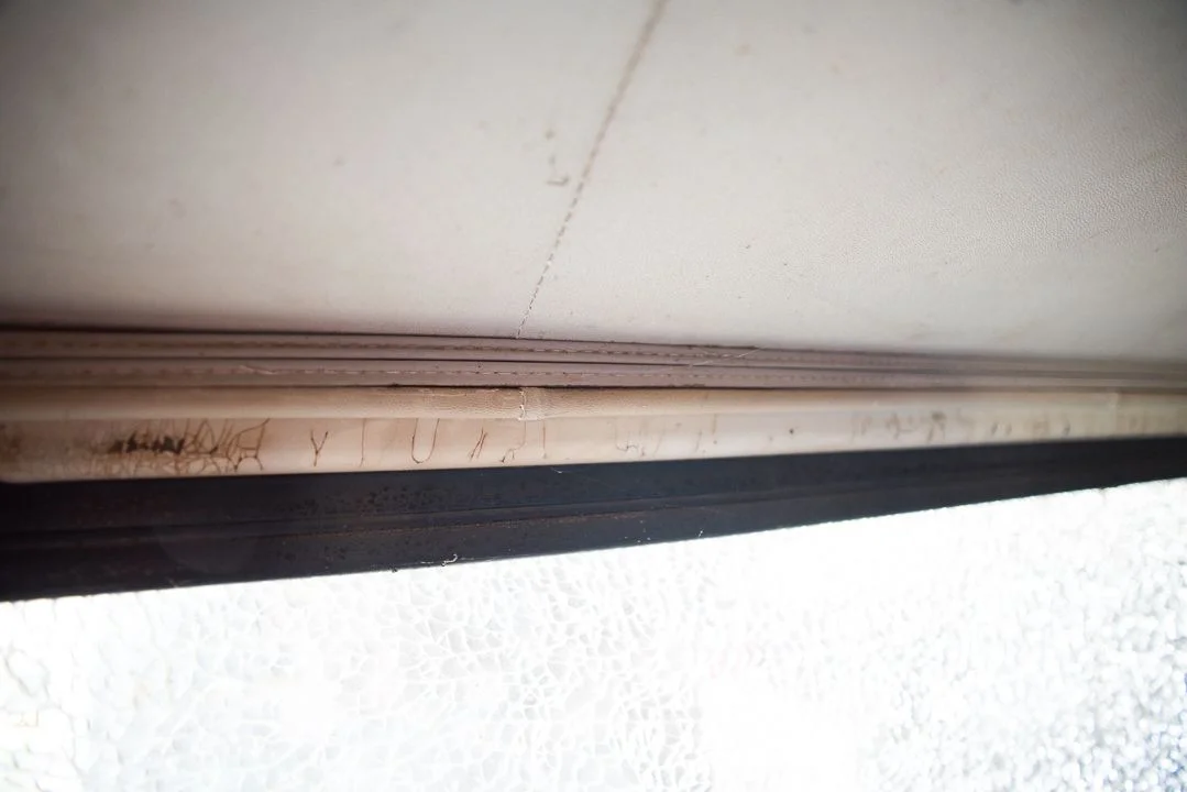

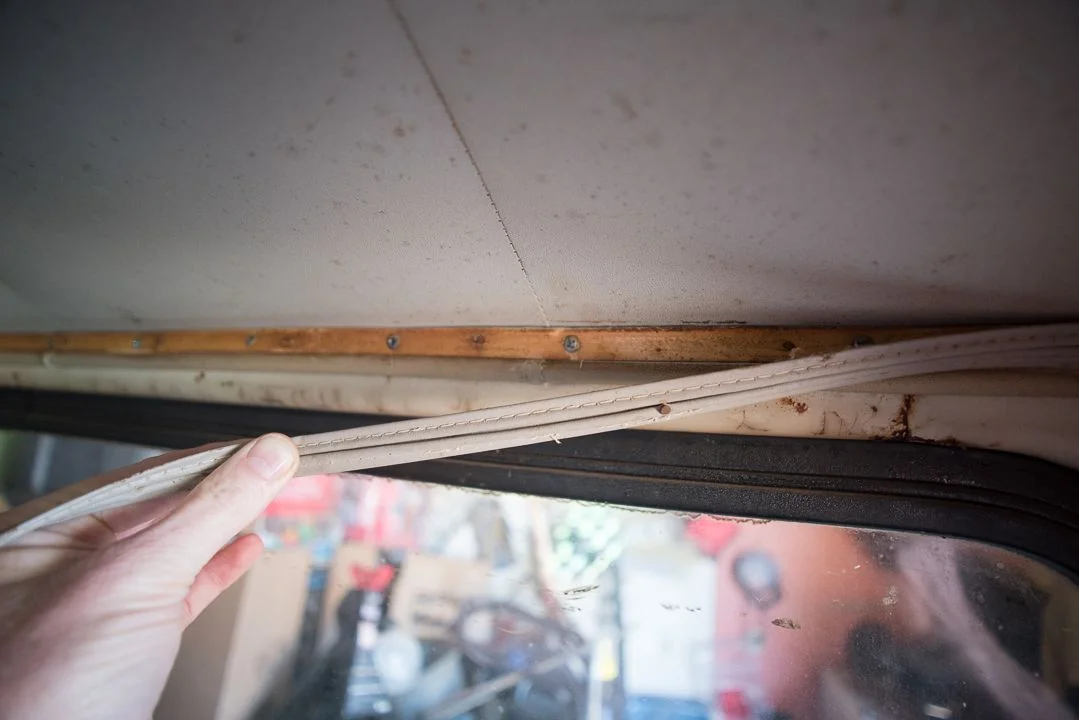

Headliner wood and welting '67LV
It does Scott....thanks. That's the way I figured it must have worked based on my crappy pics but I couldn't figure out what was missing with the older SOR top that I got with another truck. Now I know.
