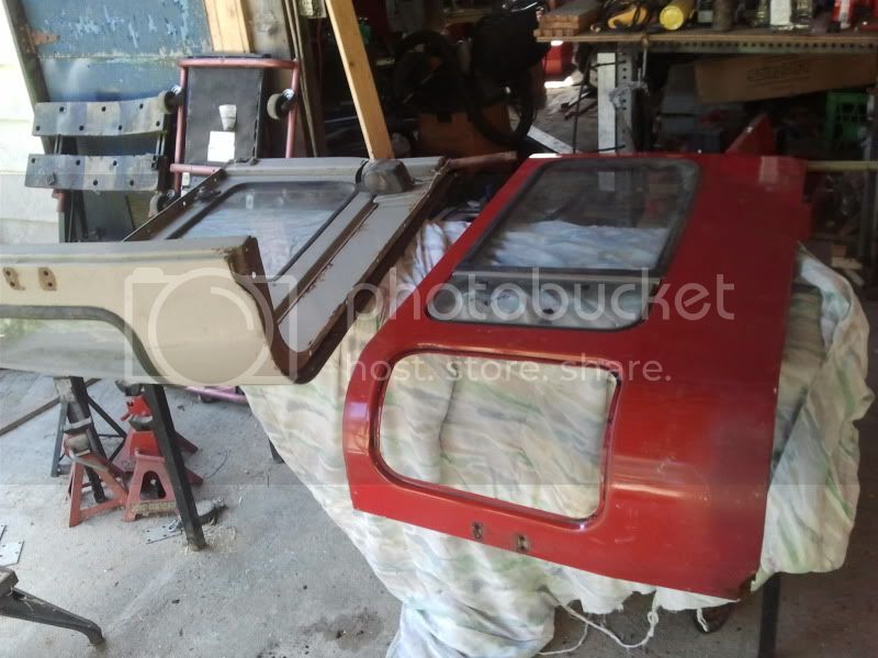

So, after several days of messing with the worst job on a cruiser, which came with several irritating issues, the front end is back together.
I should have taken a picture of what the back yard looked like after unloading stevens stuff...:lol:
it was getting kindof retarded out there....
a half dozen hard top sides layed out on the ground as I try to find a decent pair( amongst random doors and fenders and s*** everywhere)...
and I did find a decent pair, just they were both lefts...:bang:

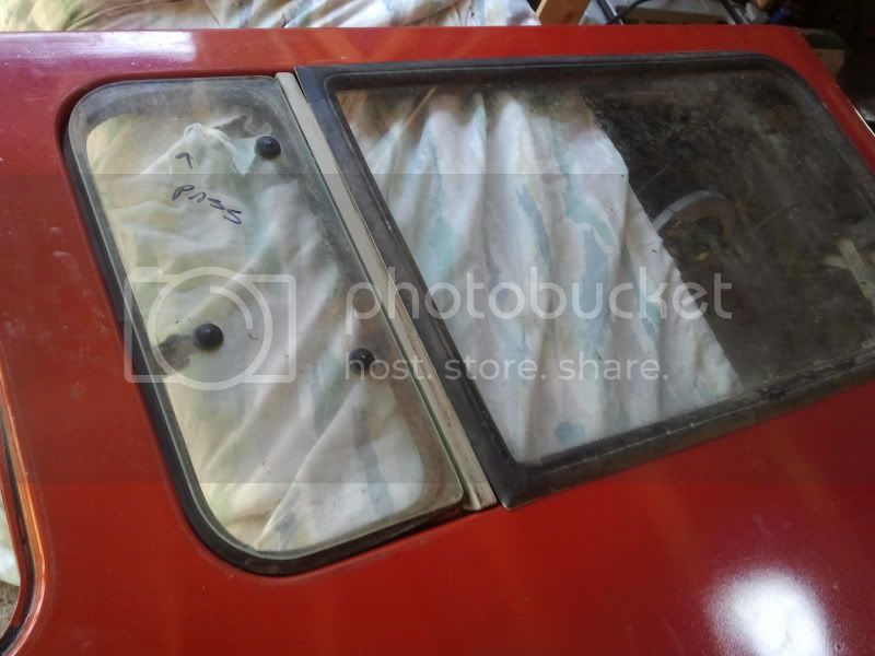

So after a bit I figgered the easiest thing would be to ad the divider to an old style ht side, as there was an early one there that was near minty fresh...( I can almost hear stephen grumbling...:flipoff2:
Annoyingly Mr.T decided to make the newer windows about 1/4" smaller than the old ones, so after adding the center divider, putting the newer window in has it somewhat loose...but meh, I'll just ad a little stickyflex when it goes in and it'll stay put. this is waaay easier than rust patching the new style side.
And because, it occured to me, that once the lid was on, I wouldn't be adding the cage till next summer, I threw in the mt front kit I picked up in orygun a few months back.
I still need to pop it out and finish welding it, and paint it, but it's a start. went in pretty quickly, I'd been waiting till I had a dash pad to put it in. ( so it went in the right spot, it's tight up there between the doors and dash)
I was going to do the ghetto cheap bastard rear cage with a second factory roll bar, but ran out of steam. Think I'll call this good for now.
