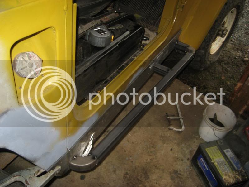

Built some rocker protection/sliders, and cut out the rotten rear sill, made a new one and got one of the back corners mostly rebuilt.
a few pics to try to motivate myself to go out there tonight...
slider things...
and the joys of rear silliness.
Used a bit of flatbar and some square tube to recreate that little step dealio there is back there.
Considered the CCOT piece for about 4 seconds, then heard the distinct tone of my bunghole slamming shut at the price, and went for this way.
It will look pretty much the same in the end, and you can sortof see it in this pic if you squint a little...:hillbilly:
This side was the much worse of the two, and the corner itself and the side is actually surprizingly fair, will hardly need any weld improving putty, under the spare tire carrier there's a bit of wonk, but it's under the spare tire carrier, so I'm not too worried.
I'll give it a little hammerlove before I finish, so it should be somewhat respectable for a half drunk redneck with a hammer as his most sophisticated tool...:hillbilly:
slider things...

Nice slider step bar things! I really like them. They suite the truck nicely and I like the home made aspect as well. :beer:

Rear sill looks not bad for being a chunk of 2x2 and a 1/4" piece of flat bar....
