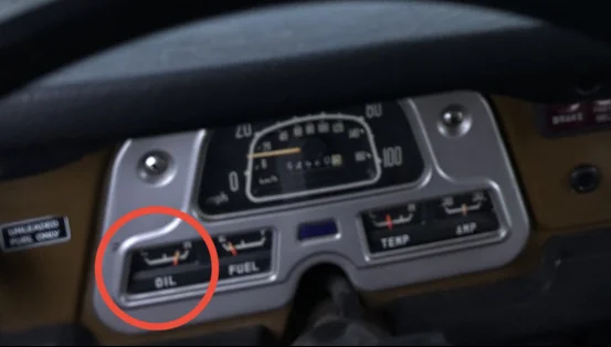

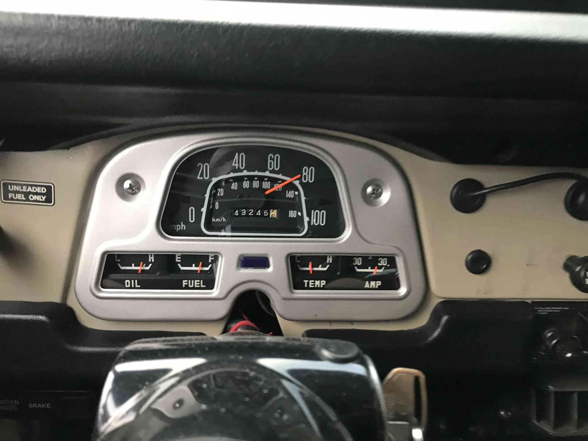

What do people here generally see on their OEM oil pressure gauge w/ factory 2F motor!? I’m sure these aren’t incredibly accurate gauges, but, just curious what’s “normal” out there. This seems a little high (attached photo). Thanks!!

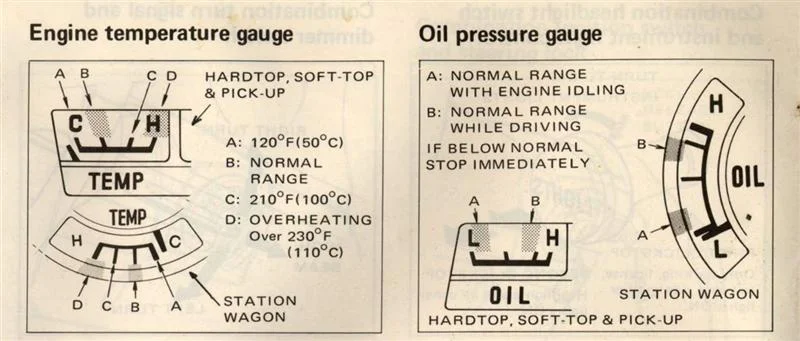

I found this pic on this site. Pressure would depend on if the oil is cold or is at full operating temp. You can adapt an actual pressure gauge to compare the two.
Your photo looks identical to my 1977 HJ45 (3.6L H diesel engine - mileage unknown).
The manual excert looks pessimistic to me - my idle is higher than that
