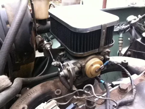

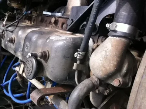

Ntsaint, here is my carb.
Thanks!
Two questions: do you have a shot of the front side, where the fuel lines hook up? Want to compare that to what I have.

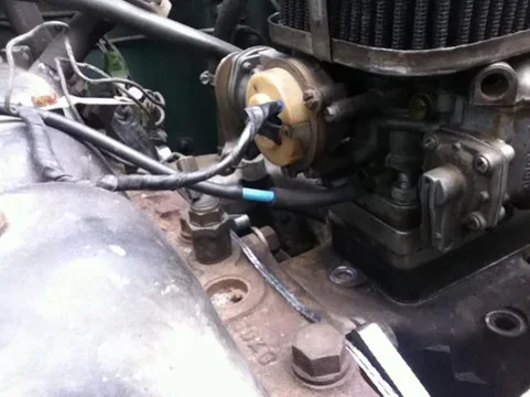

Also, see below pic...does the line I've circled run to your distributor?
Thanks again.

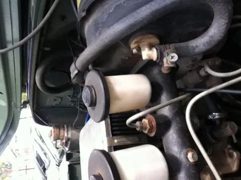

Can somebody tell me what part of brake system the brake fluid reservoir that is empty goes to? That thing has emptied on me twice since I had it.
It's the one in center of pic or the aft one.
Why does this thing have so many reservoirs?

Yes. That line runs to distributor.

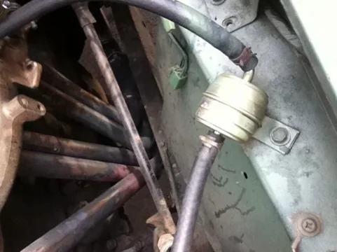

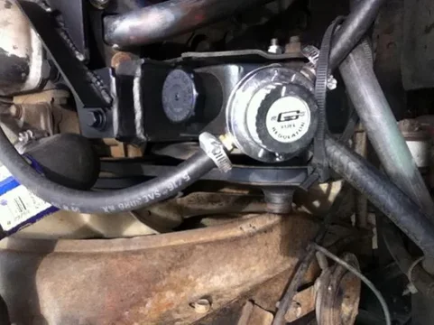

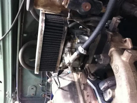

Next pics are running from carb back to fuel pump.
Thanks for all the pics. Think I'm all hooked up.
I have a slightly diff carb than you, my fuel line inputs are different.

Your rear wheel cyl's are leaking I'd bet. Can you say $100 bill? Not too hard. Just did mine. Try the guys at Cruiser Corps or Cool Cruisers for parts.

Had kids press pedal while I crawled underneath after I filled up empty reservoir. I could not see any leaks. I did hear some noises coming from both rear wheels. Seemed a little loud for regular break movement.
Got a link to the part you think I need?
Or... For about $200 we can fix you up with the stuff to convert to rear disc brakes ;)
Nice thing about discs is that everything is visible. Why replace when you can upgrade for a little mo' money?! :cool:

Mike for what it's worth the rear passenger side wheel cylinder was replaced and the whole system bleed and replaced with fresh fluid a month before you bought it. (professionally) If the problem is RP then you may can get a warranty on part. Dig through that receipt pile and if you can't find it I can get print out from shop that did it.
I'm wondering if flushing the system actually opened up a previous leak. The problem with 30 year old trucks is that if you wash them, replace a part on an inline system (like brakes) other stuff tends to happen as as a result........I always try to look at the glass as half full. $120 and you will know alot more about how rear brakes work. (probably not comforting right now.)
