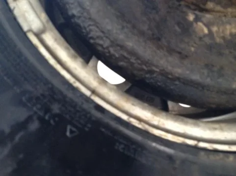

Well I found my leak. DS rear wheel. What needs to be done to fix this? Can I get these parts at an Auto Zone or Oreilly's?
Seriously. Clamp off that side of the rear brakes ( to stop leak) and hold off until you have the time and. $$ to do a rear disc brake conversion
But will that pass cottonlands safety inspection for the crawl. :)
Seriously though, there seems to be as many people that like drum compared to disc?!?!
When you say clamp off, you mean crimp the line so fluid wont keep leaking? How do you clamp or crimp without damaging line?
You have to sacrifice a small section of brake line to clamp it off. I do it with small vice grips.

Even when adjusted and working correctly the rear brakes only provide about 30% of the total effort. The good and bad of older Cruiser drum brakes is that there are two wheel cylinders per wheel. This set up makes them hard to adjust properly and also makes them work quite well when set up right. I would not recommend replacing rear drum brakes that are in working order with a disc set up but if your system has issues the cost to repair the stock system can be used to upgrade to a disc set up.

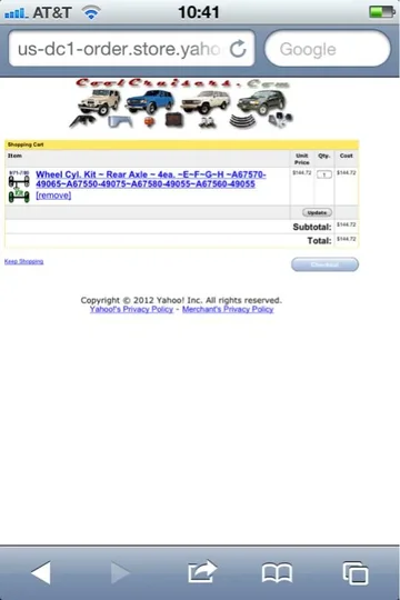

If you want to repair your current system you should plan on ordering both wheel cylinders for that wheel as well as new brake shoes. You would be better off to go ahead and buy some drum brake tools to help you do the work (if you can still find them),and also find a shop to turn your old drum on their brake LATHE. Once you get it all back together you can enjoy a few hours of fighting with a adjustment tool on both the top AND bottom cylinder until you get each one adjusted properly( good luck with that).

Just spend about $70 to fix the side that is leaking to get you thru the crawl if it bothers you. It's not a hard job. The hardest thing is getting the springs back on. We did mine before we came to HS in June. Doing Jrobs full floater now.
SHUSH, how much did that cost you when you did PS? Why did you do it? Was it leaking like mine is now.
OBTW, when I sell it back to you it will be brand ....... new.
don't remember price as bill had other work included. Passenger was leaking so I did it.
