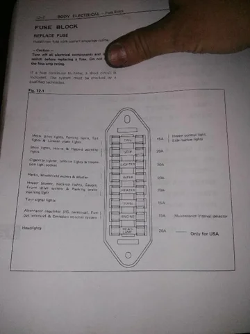

Spent a few hours today pulling an old and installing a new stereo head unit in my Tuffy console. Good music and Cruisers just go together. Anyway, the new cheap Pioneer will not turn completely off. It has to be wired to accessory power so it goes off when the ignition is turned off. The previous (dead) Pioneer was not wired to keyed accessory power. Any leads on a simple keyed power source on a desmogged '77 40? Thanks
Mine cuts off. Find a keyed power source. Been so long since I ran that wire that I can't remember.
Lash,
This fuse panel diagram is from the FSM:
The top three circuits are always hot, the radio/wiper circuit is accessory hot, and the others are ignition hot.
On the back of the panel, on the right side, there are spade terminals for the accessory hot circuit and one (I believe) ignition hot circuit...you can feel them if you reach around the back of the panel. Easy place to tap into switched power.

Good stuff. Thanks!
