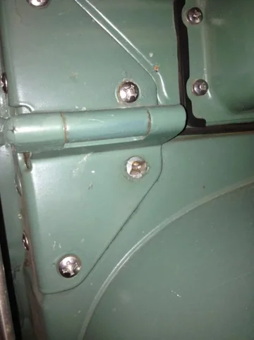

Anybody know where to get replacement bolt/screws for the one stripped in picture?
Anybody know the size? Maybe I can source one locally.
What is best way to get that out? Looks like at least one PO tried to no avail. I hit it with Kroil once a month.
i'd use a left handed drill bit
Yeah go with left handed bits, starting as small as possible. Drill through and then move up to next size. As you keep increasing size what's left of the bolt will normally back out.
SOR, CCOT and cruiser corps all have stainless bolt kits for that.

Mike you have bolts that match the rest that I gave you n one of those boxes of parts.
