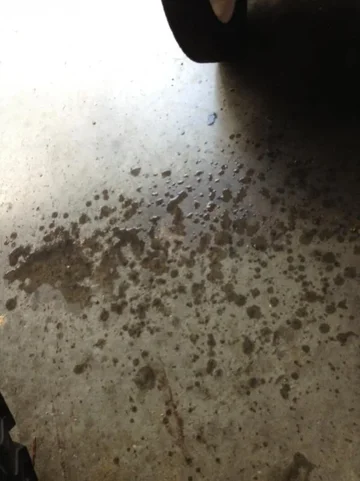

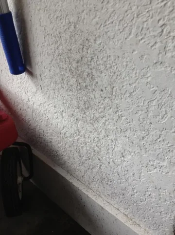

Haven't run my 40 in a week or so. I always let it idle for 5 minutes or so before driving it and noticed some fluid under exhaust pipe and black soot on the wall. Any concern?
Nope, It's just condensation.
Nope. Water forms in a cold exhaust (condensation), and when you start it up from cold, it's just blowing that out of the pipe. As for the black, the condensation is just picking up some of the carbon in the exhaust system and carrying it out with the condensate.
