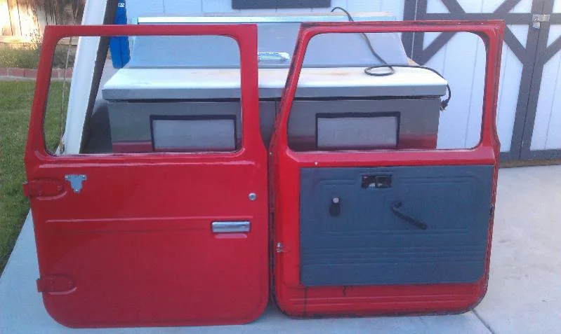

Along the same lines, when did the door handles change to the "pull up" style, rather than twist handles. The doors, I have have vinyl door panels, no wing windows, and the plastic mirrors bolted on the door itself, not to mention they are quite heavy. All of that put together puts the doors at '77 according to the excellent write up from Chamba. My doors have the pull up handle, was that part of the change in 75?
Thanks guys, glad you liked it. Yes, the handles changed in '75. Your doors are '77-'80.

There are some threads and pictures on this topic, but inner door covers on the early doors existed at some point. https://forum.ih8mud.com/threads/1974-inner-door-panels.420504/ I don't recall the production date of the vehicle, but I saw an FJ-40 with the early style doors that had factory vinyl cover panels that simply bolted on to the door. The covers can be seen in the EPC drawings online. I do not have the covers, I don't know if they were standard or optional and only for a short time period I assume.

There are some threads and pictures on this topic, but inner door covers on the early doors existed at some point. 1974 Inner door panels I don't recall the production date of the vehicle, but I saw an FJ-40 with the early style doors that had factory vinyl cover panels that simply bolted on to the door. The covers can be seen in the EPC drawings online. I do not have the covers, I don't know if they were standard or optional and only for a short time period I assume.
