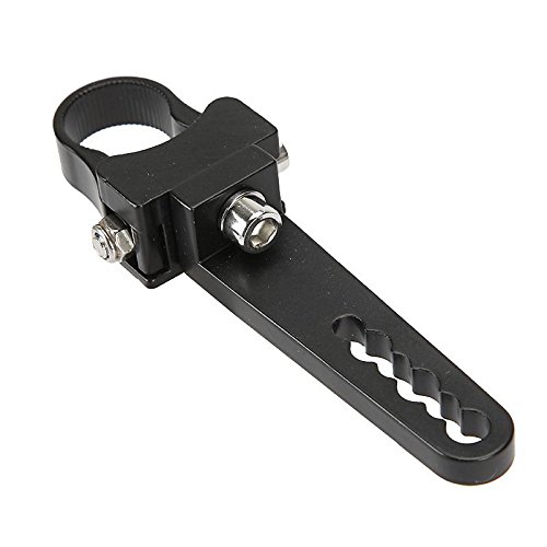

Well, I am closing in on finishing my rack. We got one done but I was hung up on how I wanted to mount mine. I wanted the following things in a mounting location/design for the 42" bar:
  • I wanted to mount it under the rack to not take up any space on top.
  • I wanted to mount it under for protection from branches
  • I wanted to be able to mount it far enough BACK from the leading edge to prevent as much hood glare as possible.
  • I wanted to be able to rotate the direction of the beam pattern up and down.
  • I wanted light weight, simple construction.
I found all that I wanted in the Auxmart Universal mounts for 1" tube on Amazon:
Amazon.com: AUXMART 1 Inch Bullbar Nudge Bar Mounting Brackets Tube Light Clamp for Hid LED Light Bar: Automotive
They are simple enough, they are very adjustable as they rotate around the tube, and spin 360* around the "L" bolt. They would work for a large number of different mounting options.
Before I could mount them though I had to modify the mounting end caps on the light bar itself. There was a threaded M8 x1.25 area but the exterior hole would only accept the diameter of a M6 diameter bolt. So, I chucked a tap into my drill and opened it up and threaded at that same time.
A quick tip for tapping aluminum is to use a little cutting oil, a cordless drill with the clutch set about 1/2 way and drill on in... it makes quick holes and works really well. Obviously you gotta back it out and clean up the chips but this is the fastest way I have found to make quick, CLEAN threads.
The end result is about 3/4" of solid threads to hook into. I might add a rubber washer to clamp down and give me some friction on those geared teeth to hold the adjustment tight... thoughts? Thread locker for sure but I think a little friction with a thin rubber washer might do me some good?
One things I like about the mounts is it allows me to set the LED light bar back from the front of the roof rack, this should cut down on the amount of hood glare I get as well as, how many branches it comes in contact with. Here is roughly how it looks on the truck. The rack isn't level so it looks like I am cutting it close but there will be about 3/8" between the bottom of the light and the sunroof. I will likely lose the ability to tilt my sunroof but since it drops down to slide rearward I should be all set for it to still open.
I had to use a 3/8" washer to space the mounting arm to clear the Gore-Tex breather. I have since bought a few 3/8" spacers that allow me just the right amount of clearance to rotate the light where I want it without hitting the breather nor the wiring.
Here is the overall look this will achieve. I like how this is coming along, I think the balance of aesthetics, light output, glare, and protection are where I want them. Today I made a jig for my milling machine to start all the upper hoop stand-offs, and I bent up the upper hoops for my buddies rack to fit his dual light bars on top of the rack. They are gonna look great.
