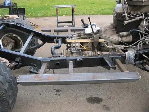

Here I am lining up my new sliders. The sliders are 2x5" x 3/16 tubing attached to the frame with 2x2" x 3/16 tube.
On this first one, I forgot to box in the ends of the main tube before I welded it all on, so the welding was a little more challenging. (the other side I did it on the ground first)

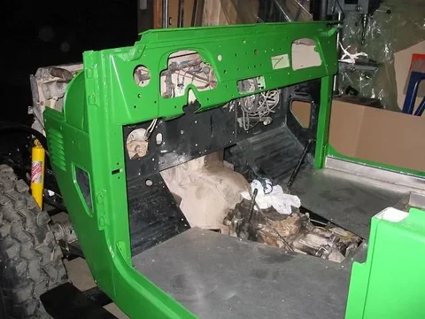

Finally! I got a little more work done on the truck. I fit all of the body together, bolted it, put in the tranny cover, hung the doors, and checked the fit of everything. It all lined up pretty nice. (forgot to take a pic though).
The seats are going to be a pain. You 45 owners already know how limited leg room is. I think I am going to try out the seats I have from an 81 fj40 as they seem to take up less room. And now I have the hardtop to help position the seats
BUT, here is the tub and firewall sitting together on the frame
Here you can see the tight clearance on the rear tires. Should be okay though

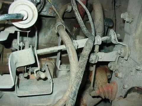

I also had to modify the bracket on the carb and the one on the firewall for the throttle linkage. The factory set up is pretty well horizontal
