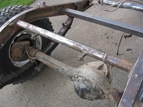

Here are the next few mods I made to the frame.
I boxed in the rear x-member, installed some angled braces for the rear crossmember, and some mounting plates to weld on some rock sliders

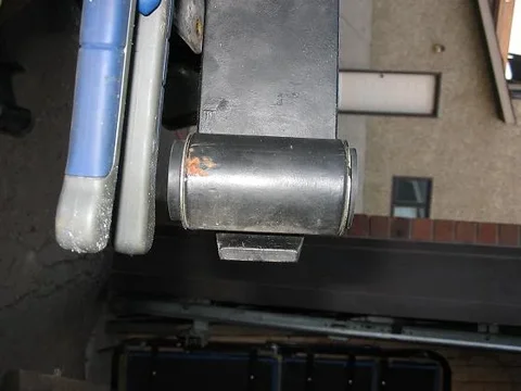

I skipped over the bit of work it took to put on the suspension during this process. The biggest problem I had with the fj55 springs was getting perfect sized bushings
You can see in the pic where I had to reduce the size of the flange on the bushings (used a flap wheel on a grinder - it took 10 seconds)

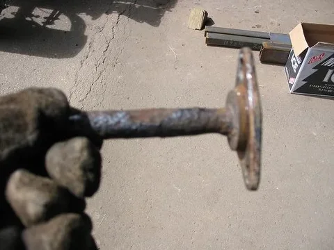

Of course, removing the spring/frame pins was a chore. Ended up burning the bushings out with a torch. Check out the wear/neck on the shaft of the pin.

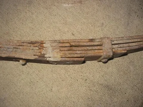

And just for fun, here's a pic of one of my old front springs. See anything wrong with this pic?? There were 2 like this

The last 2 things I did were to clean up the boxed ends of the rear x-member
and to rotate the shock mount x-member 180 deg. so that the mounting locations for the top and bottom of the shock lined up (because the axle is sitting 4.75" further back then before)

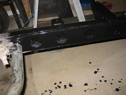

So I cleaned up all of the loose stuff on the frame and as much of the dirt as I could (cleaning out those boxed sections is such a *****!)
I used POR-15 for the frame (used it before with mixed success).
Marine cleaned it. Rinsed it off. Metal Readied it. Rinsed it off. Let it completely dry.
Then applied the paint using foam brushes (they work pretty good cause you can soak up a lot of paint and bloch the really rough areas to leave lots of paint in the cracks/bumps. They just fall apart after a while so you go through a lot of them (but a $4 for 24 or something stupid like that, who cares)
After the first coat of paint, it sat for about 6-7 hours. When I started the second coat, the first coat had just a bit of softness/stickiness. I'd say that the POR guys would likely say to paint it a bit sooner.
An hour after the 2nd coat, I put a real light dusting of primer on the sticky paint.
After that dried (I waited 24hours), I put a gloss black coat on of cheap old rustoleum. Remember, this is not a full resto. If my buddy hadn't started cleaning the frame off, I would have never painted it!

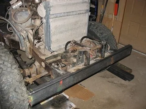

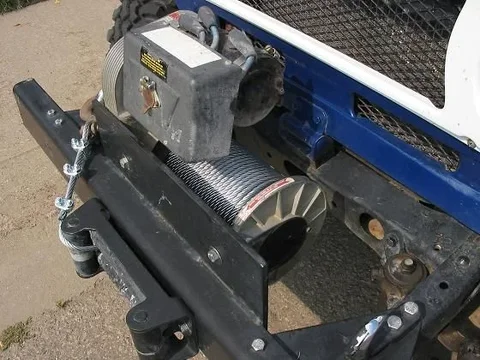

Along side all of the work I have been doing on the frame, I've also been cleaning up the PTO winch and building a bumper for the front.
Before I tore the truck apart, I had a 8274 mounted on a bumper I had built. The bumper was made with 3/8" thick plate that I had a local company bend into a c-channel. I then welded another piece of 3/8 plate to that for the mounting of the winch.
For the new bumper, I used a 2x5 steel tube (3/16" wall). Cut it to 4.5' and cut out openings on one side for the end of the frame to go into. The front of the winch sits on top of the bumper (just like a factory set up)
You can see that it still needs all of the holes drilled. And I'm planning to mount a receiver as well for a portable winch

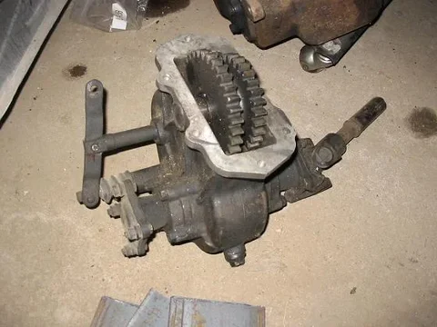

Here is a pic of the PTO box before I put it on. It's from an 81 BJ41 and bolts right up to my T-case. To my surprise, there was already a PTO drive gear in the T-case (I had another one but this saved me splitting the cases)
The box shifts real nice and I cleaned it up a bit before I bolted it on. It doesn't seem to leak (yet)
