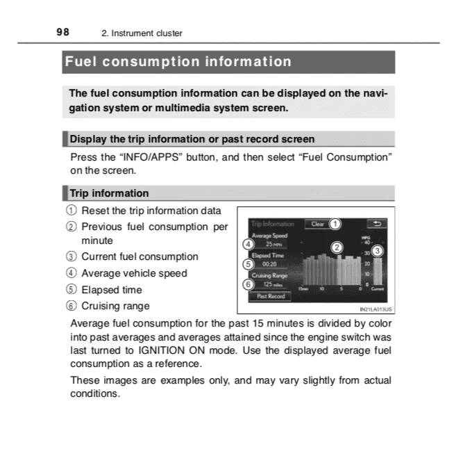

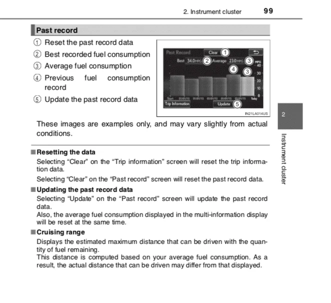

doesnt apply to your model probably as mine's a 2018. but im new to Toyota so maybe you model year has it - not sure. from the manual - shows cruising range. I can also see it or distance to empty in one of the center dash menus.

Fuel light comes on when you still have about 4 or 5 gallons in the tank.
The 200 does have a range screen, but it is the range until the light comes on...not range to true empty.
