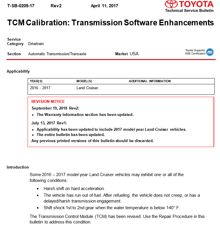

Have any of you tried to get this TSB performed on your 16-17 200s and did it help?
I had the update done, and it made the transmission shift smoother but i feel like it’s actually contributing to the slow pedal response. It felt to me like it had much better response before the update.
