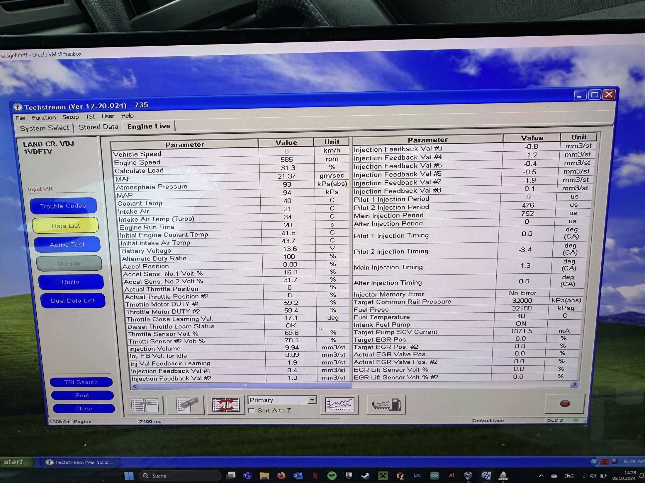

Interesting to sind out this has been listed in a TSB as below:
TSB EG-00130T-TME "Knocking noise caused by cylinder bore abnormal wear due to dust ingress" (v.2, 06/26/2019)
Did you had an abnormal injector offset in your obd reading? I checked mine like a week ago but none if the injectors showed anything bigger than +/- 1.9 mm3 per stroke.
I believe that Factory spec is +/-3 for injectors. Check them for variation at startup from full cold and then full temperature.
