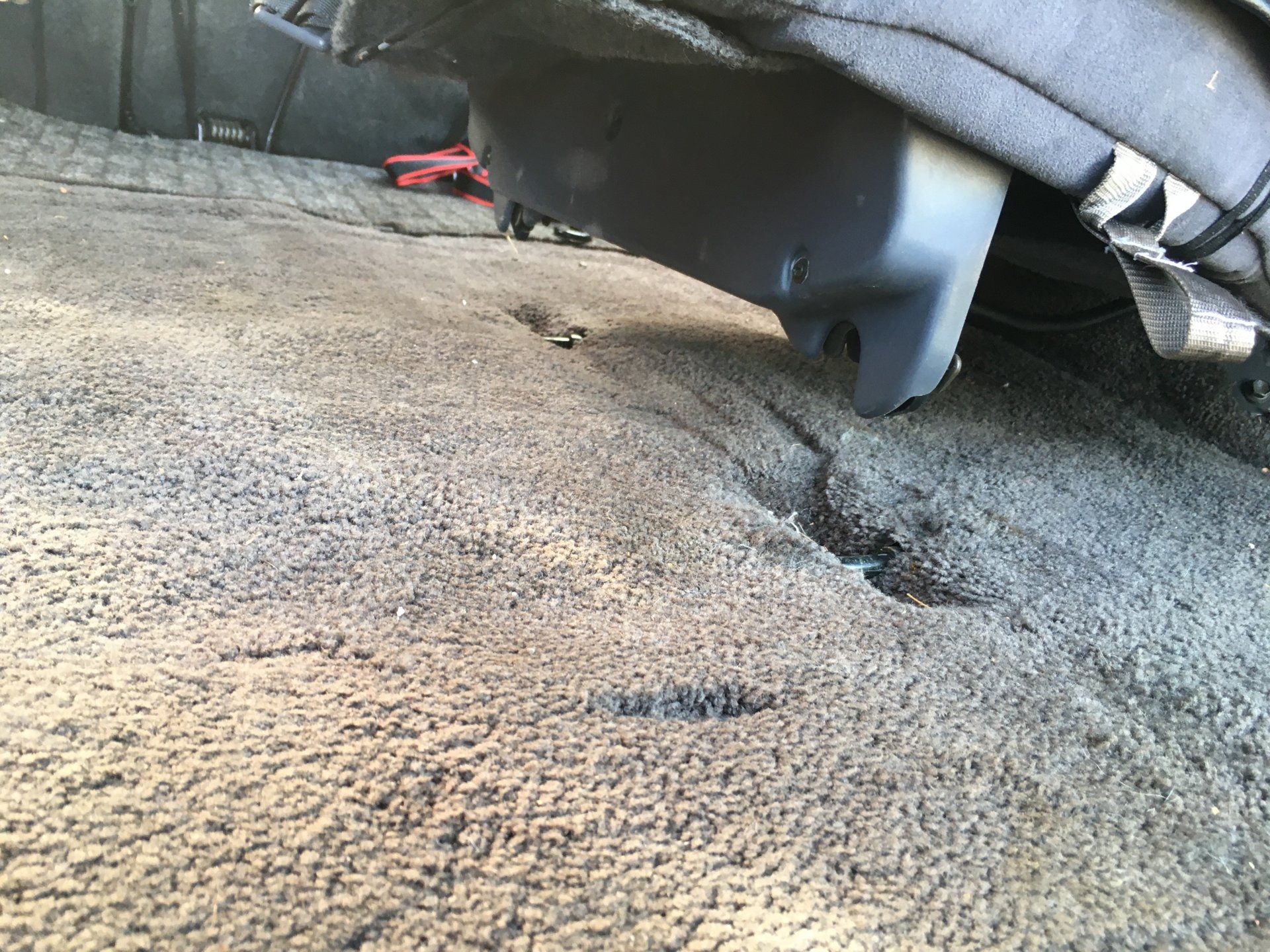

Can someone take photos of their 3rd row seats folded down, specifically the area where the seat latches into the floor? How much clearance is there around that area (i.e. how close does the bottom of the seat come to the floor, are there any plastic doohickies hanging off the seat and generally what does it look like?
I did search, and I'm a little shocked there aren't many good photos of the 3rd row setup out there. I've got an idea kicking around in my head, but don't actually have the seats to determine feasibility. I'm thinking about removing my 2nd row permanently and installing a full-length platform (5/8" plywood or something along those lines) that sits flat on the floor. Picture the goose gear seat delete platform, only with holes cut in it around the floor brackets so the 3rd row seats can still be used when needed. Just want to make sure there's enough room under and around the seats for some lumber.

Awesome, thanks! So basically, I'd have to cut out the area in red at a minimum. How about the little metal rod--do you think a piece of plywood would fit between that and the carpet, or no dice?
You dont need the metal rod. Mine are cut off. They just help kick the folding latch part outward so you dont have to manually line up anything when dropping them.
