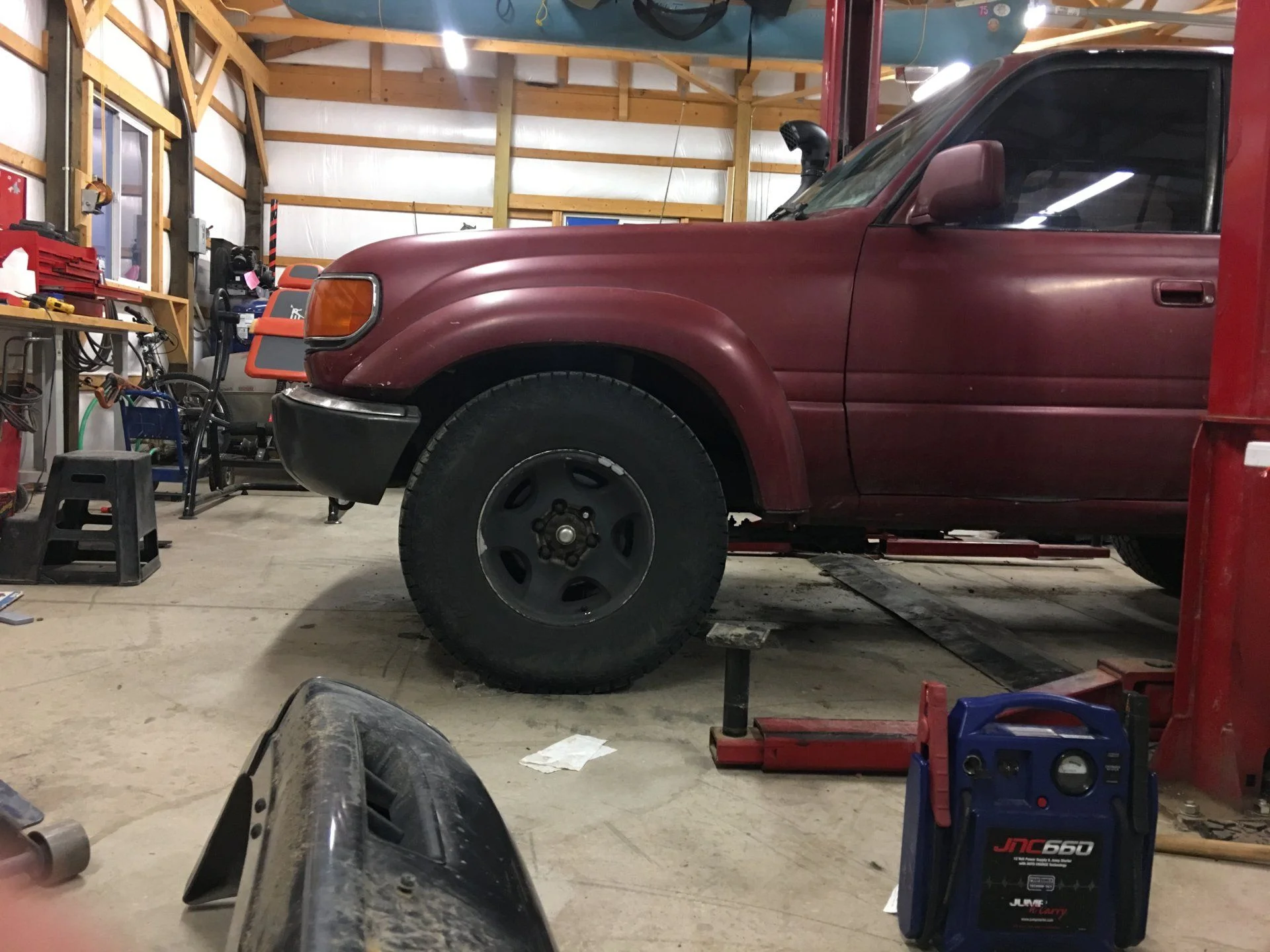

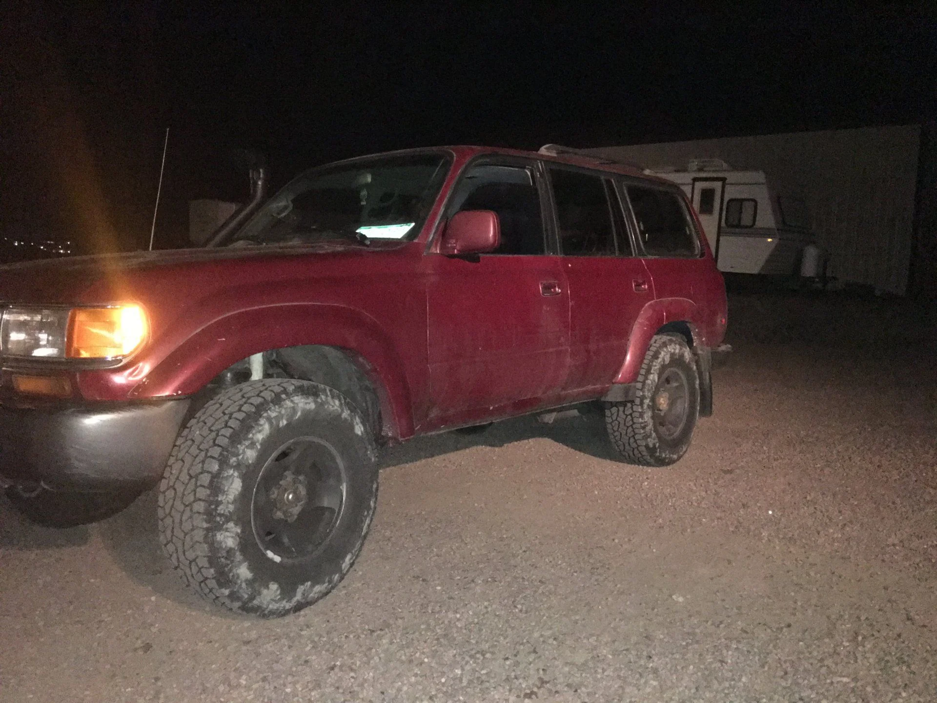

so talking with my dad about cheap lift options for our land cruiser and researching coil spacers and that.. coming from Toyota 4 runners... We knew that you could lift the back of the 3rd gen 4 runner by using front coil springs out of aLC.... So decided to see if the cheap 2" coil spacer that we had in spare parts would work in the front of the 80 series... And it worked quite well
Didn't know if anyone has ever done this bought I thought it was with sharing because you can get these spacers for pretty cheap... I don't know exactly what brand these are but they fit well...
I BOUGHT A SET OF USED 863 SPRINGS FOR THE REAR... IN THE PICTURES POSTED THOUGH THERE IS NOTHING IN THE REAR JUST STOCK SPRINGS
