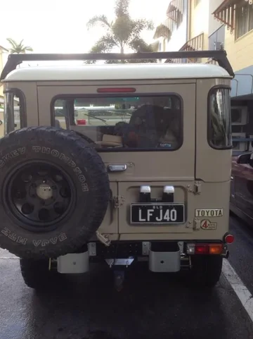

Thanks Ige, have you fit one on a 40? Above the rain gutter, or below?

I was '89-'93. I ran it from the left brake light up through the hole/grommet for the licence plate light then up the pillar to the roof. I used a Toyota plug inline for taking the roof off and then I have a brake light from a '96 or so GM van which is mounted to my tail gate for when the top is off. I have the same plug on that, so I just plug it into the same female plug I use for the Toyota light on the roof.

i used a hella,stop and tail light in one
What if you don't have a hardtop and want to install a 3rd brake light? Anyone?
This is what I did on my truck. The light plugs into the trailer wiring and functions as a turn signal, brake light and park light.
