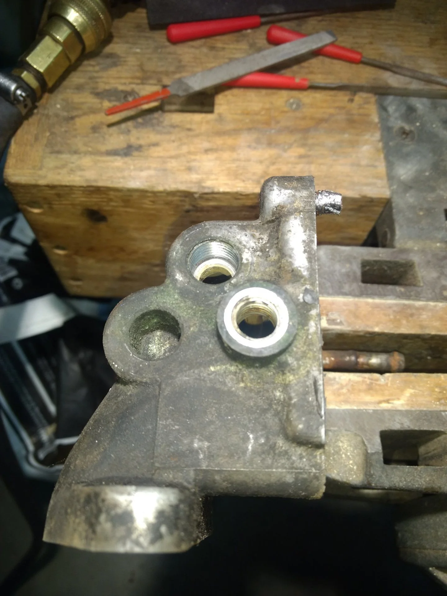

This might be the style like a couple on the lower that seal metal to metal at the bottom. I know the sender for the temp gage in the dash is like this. So are aftermarket gage senders.
Those are straight threads no sealant. Depends on the quality of the two metal surfaces that seal off. This could be the failing of the aftermarket housing.
The hole in the top of the pic is the type I'm talking about. The other open hole is the type that seals at the top with a copper washer. The third boss is a hole ready to be drilled and tapped for the aftermarket gage (metal to metal seal at the bottom.)

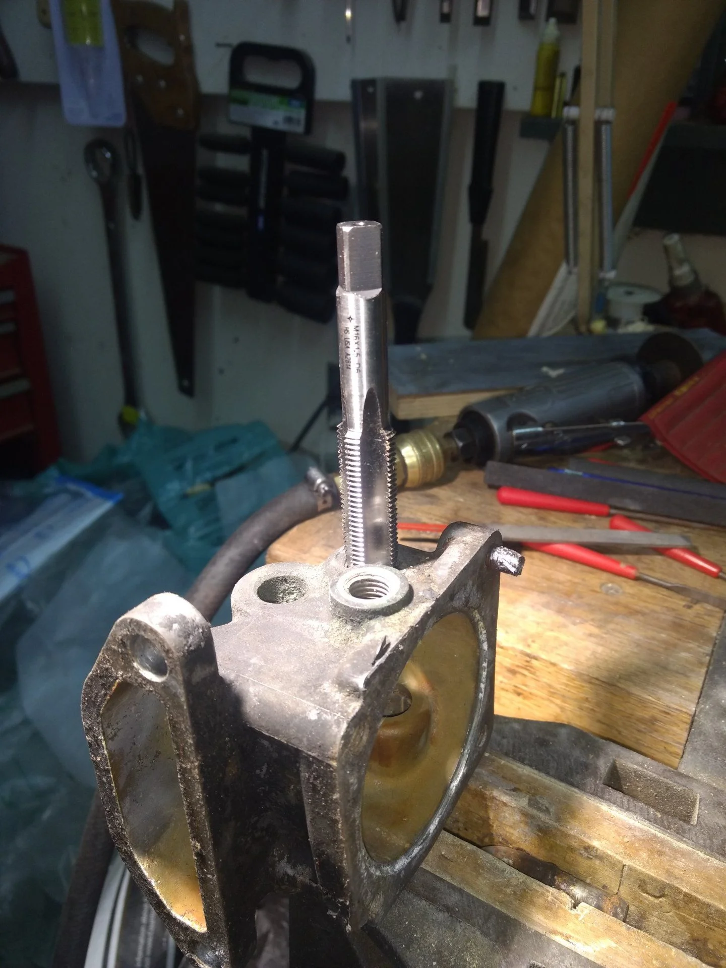

M16 x 1.5 if you need to chase the threads in yours.

Update and wrap up on this one: took the Parts Geek upper thermostat housing off and took a close look. The water temp switch port was messed up on the last couple threads. Rather than play with trying to chase it, I took a look at my old housing and decided to see how clean I could get it. Ground off a bunch of deposit crud as best I could. Put it all back together and not a drop and running perfectly. So no gasket or oring on the stock switch, anyway. I ended up going with the Mishimoto radiator. Fit perfectly and includes trans cooler ports. I already head an external trans cooler installed so not going to use them.
