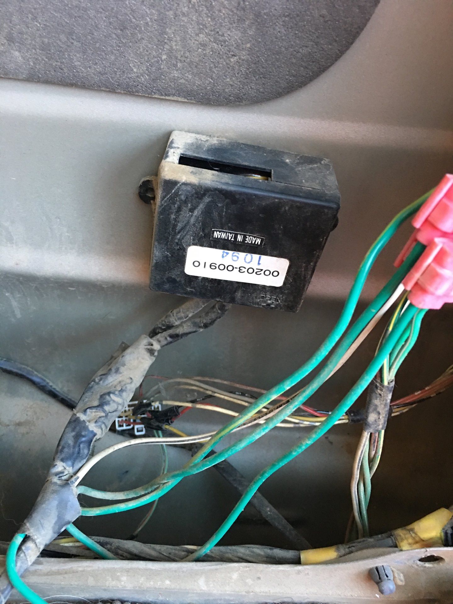

No, but I do have a generic black box there. The PO spliced in a box, but it only triggers the headlights and not the brake light signal.
S
So my best advice would be to go on amazon and pick up a new trailer wire harness and control box (they come together) they run 15- 25 bucks and follow the instructions and you should be set,
