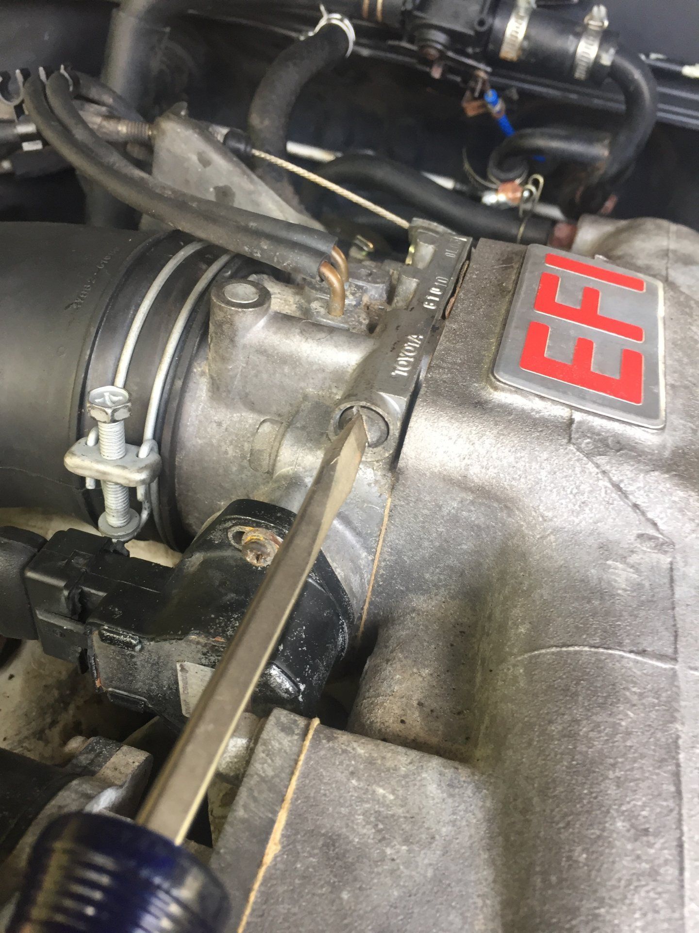

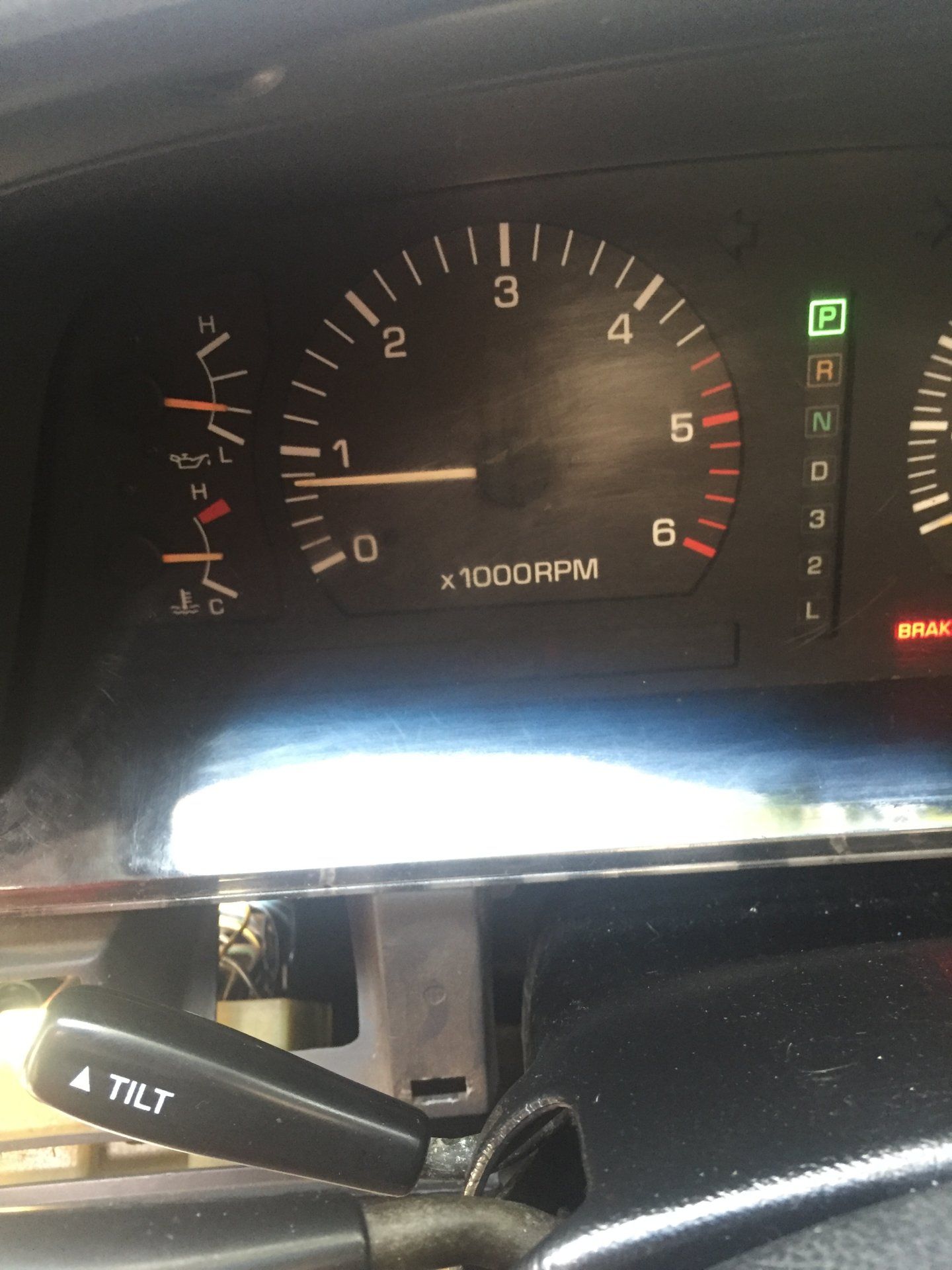

Got 8.5 MPG on my first tank. Idle also runs high in Park and Neutral (about 1,200 RPM) compared to other gears.
For the high idle I would check this screw
1920258
1920259
mine generally settles around 580-600, so turn the screw all the way in and see what happens and adjust accordingly, also do you have stock gears? I was thinking of running 33s on stock gears but I am unsure of how it'll effect the truck
