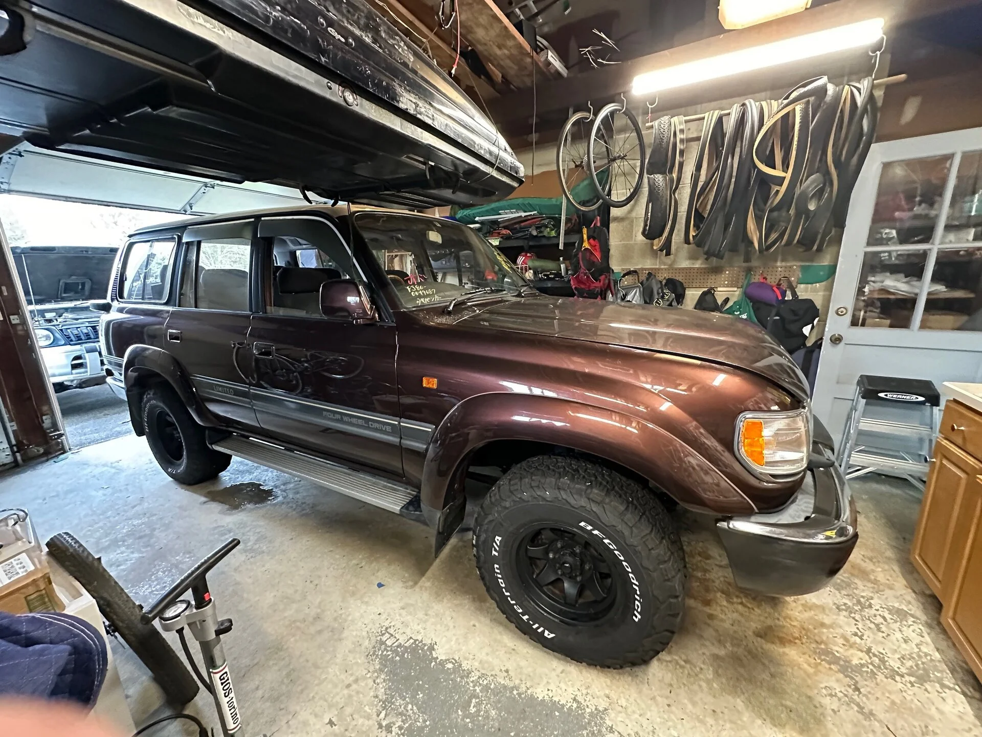

One more 3FE FJ80 rescued and back on the road after sitting for a few years. Bought it in April 2022 and got it back on the road almost a year ago. Click the link in my signature to read all the work we did. It's still got a ways to go, but is much more enjoyable now.
Before:
Current:
direct fit.

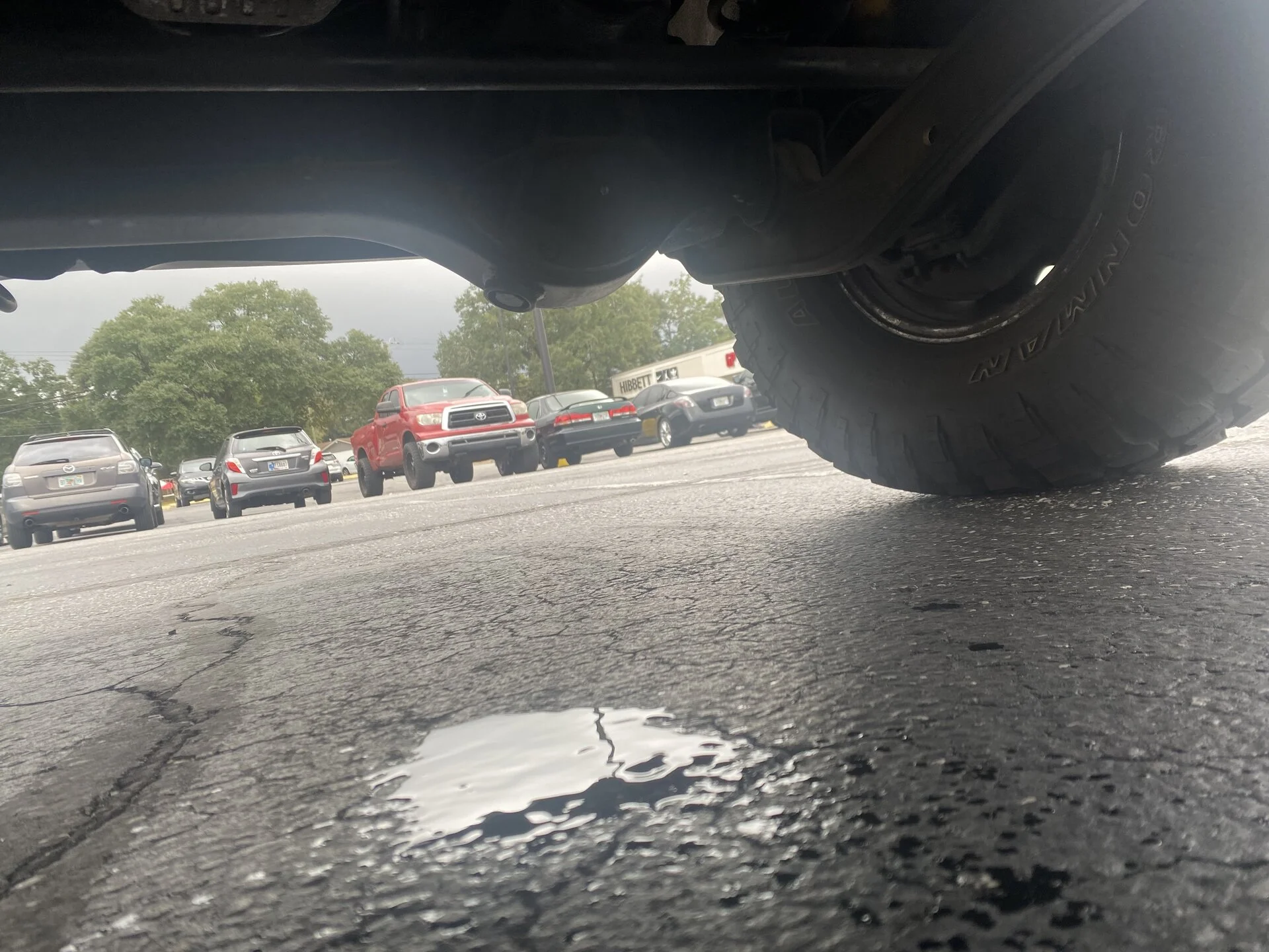

Has anyone replumbed rear heater hoses/lines, or completed the delete on an fj80 3F-E? Or know if the fj80 is the same difficulty as fzj80 in the replacement/delete?
My lines on 91 are about to go! Noticed a drop of coolant, got a couple poor lighting (flash) pics.
Searched but couldnt confirm if the 3F-E 80s were unique or not to fzj’s.

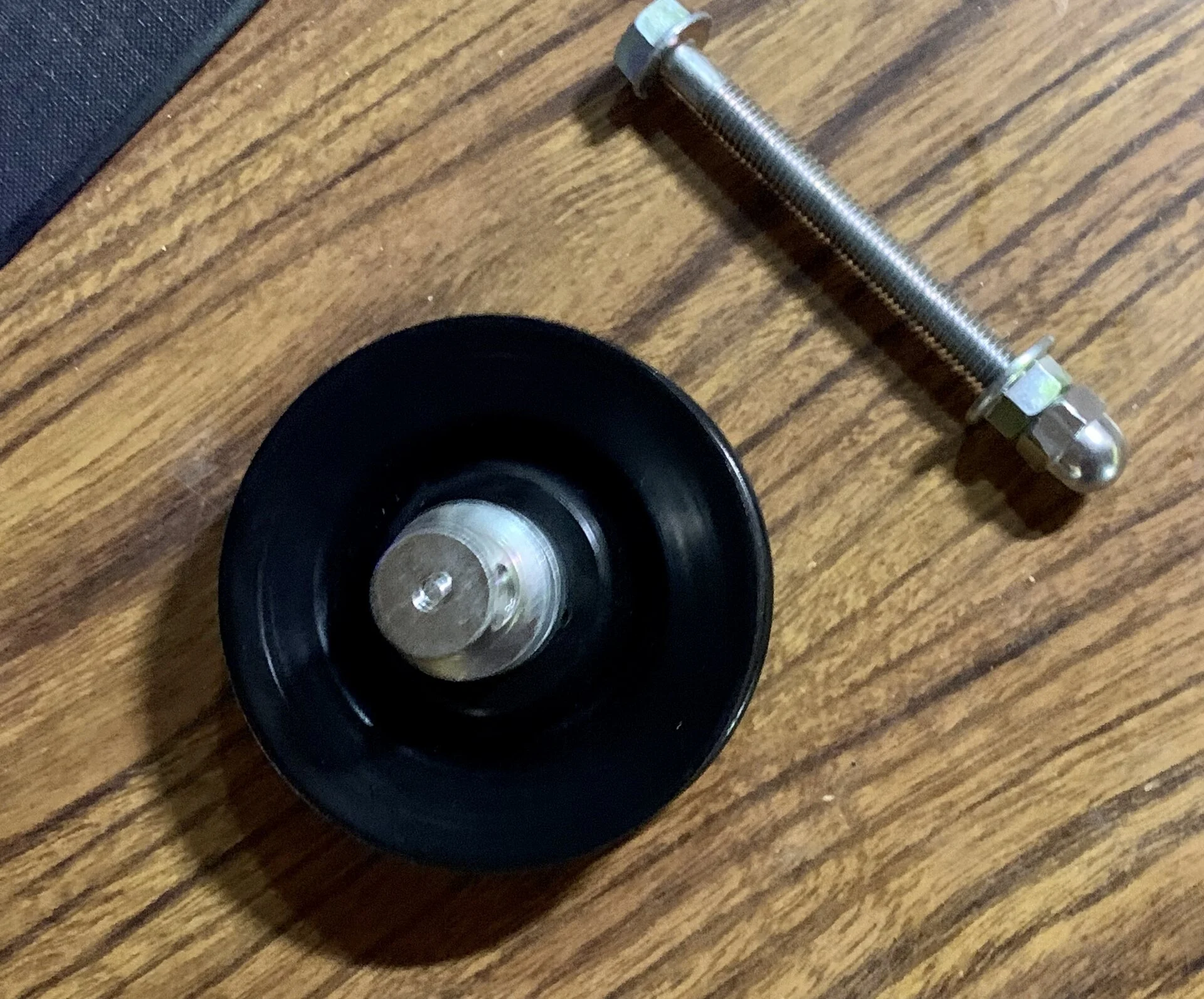

- plug and play P/S Tensioner Pulley restore kit , factory exact bearing , new oem snap ring , NEW , slider block , carriage bolt , the chrome ACHORN nut and lock down nut , and finally the SHOULDER bolt to lock the slIder in-place after final belt tension adjust

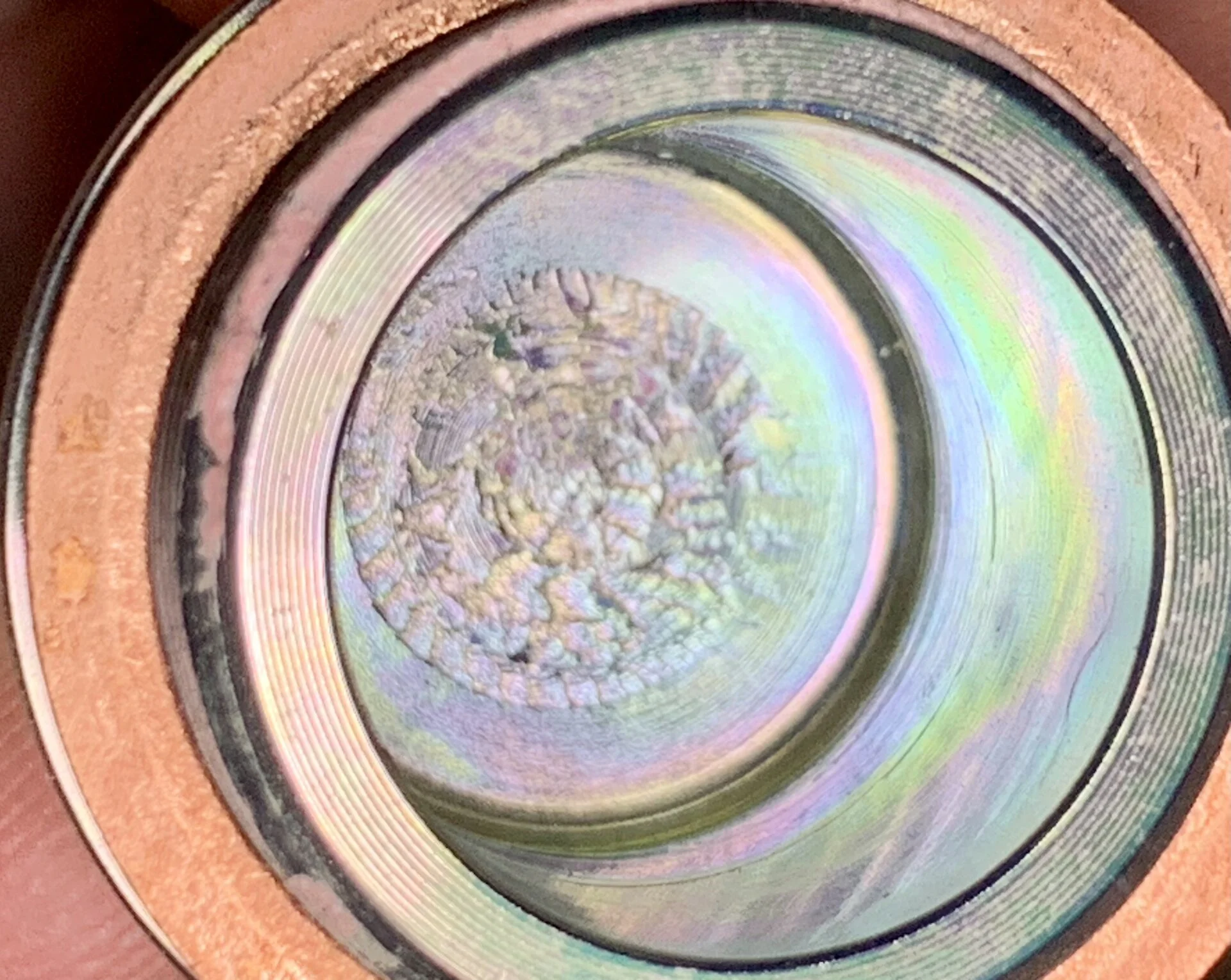

After a few minutes head scratching and convincing myself that my IR231 Ingorol Rand 1/2” air impact could in theory Crack the front exhaust manifold like ICE ?
- the time tested use of a OXY torch , rapidly applied pin point precision cherry 🍒 red status made removing the double male threaded EGR union a simple 1/2 “ long hand ratcheting eazy-peezy step ….done
I have recreated the unique ACHORN nut equipped P/S pulley slider adjust and lock down bolt parts , I’m waiting on that darn odd shoulder bolt now , it’s getting reproduced in a super hard alloy stainless …
Also , a 10pack of the OEM NSK JAPAN sealed bearings and new Snap rings too !

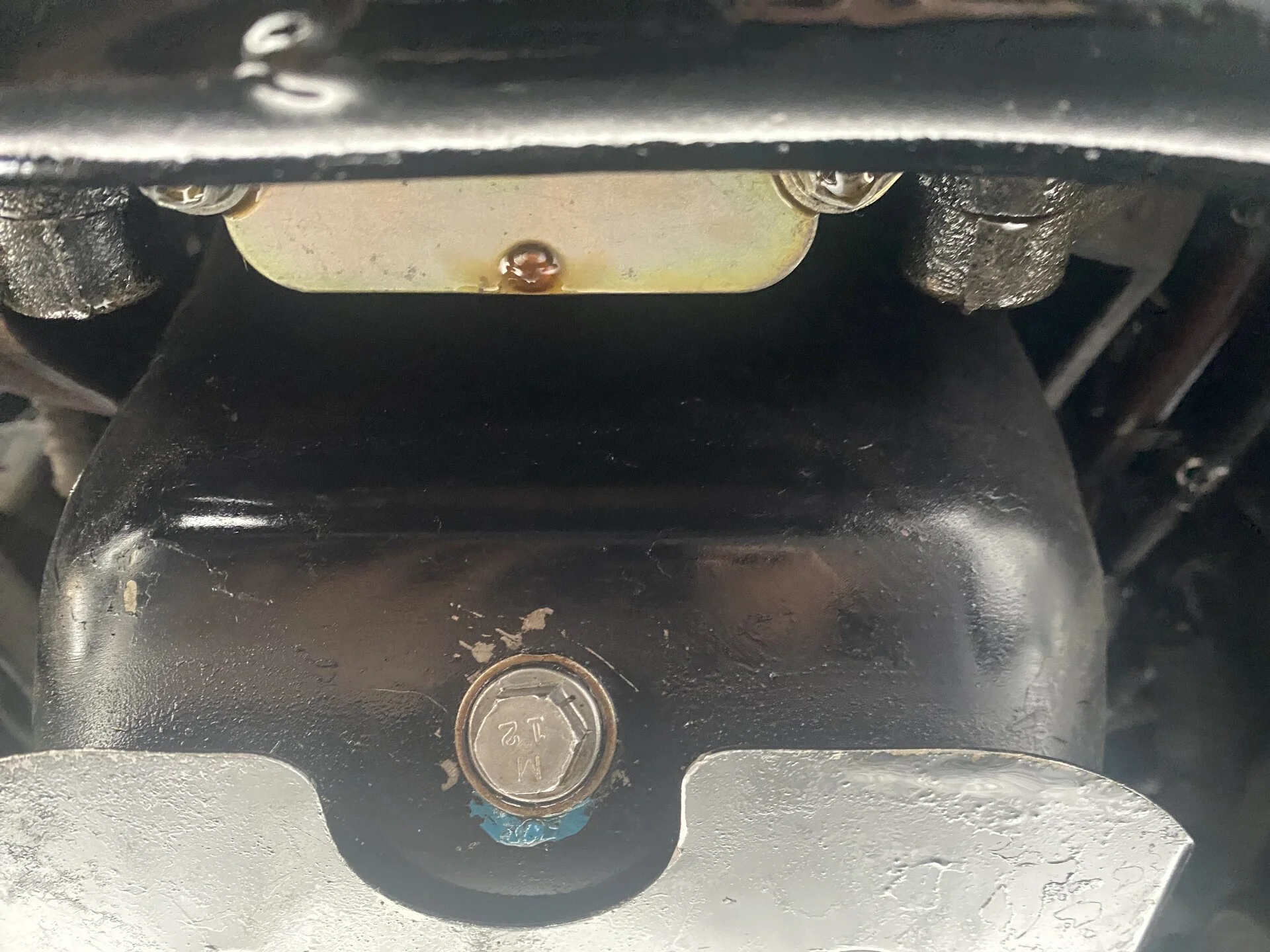

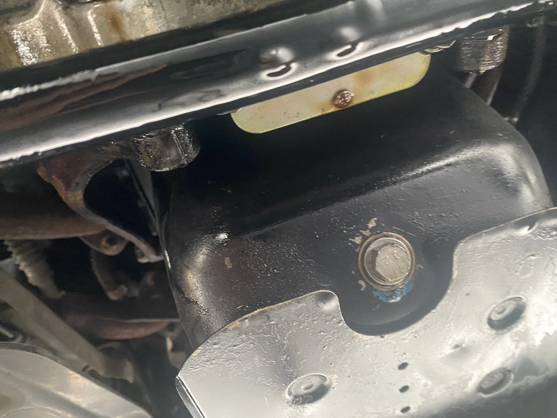

so first time poster long time reader. Anyway I have 92 3fe that’s just starting spewing up oil. At first thought maybe the drain plug was tightened. That was fine the bolts on the oil pan ended up being loose so tightened them. Changed the oil and still spewed up all the oil. It only really dumps oil while it’s running. Any ideas? See photos i have a video as well… TIA
is it Motor Oil or ATF ?
