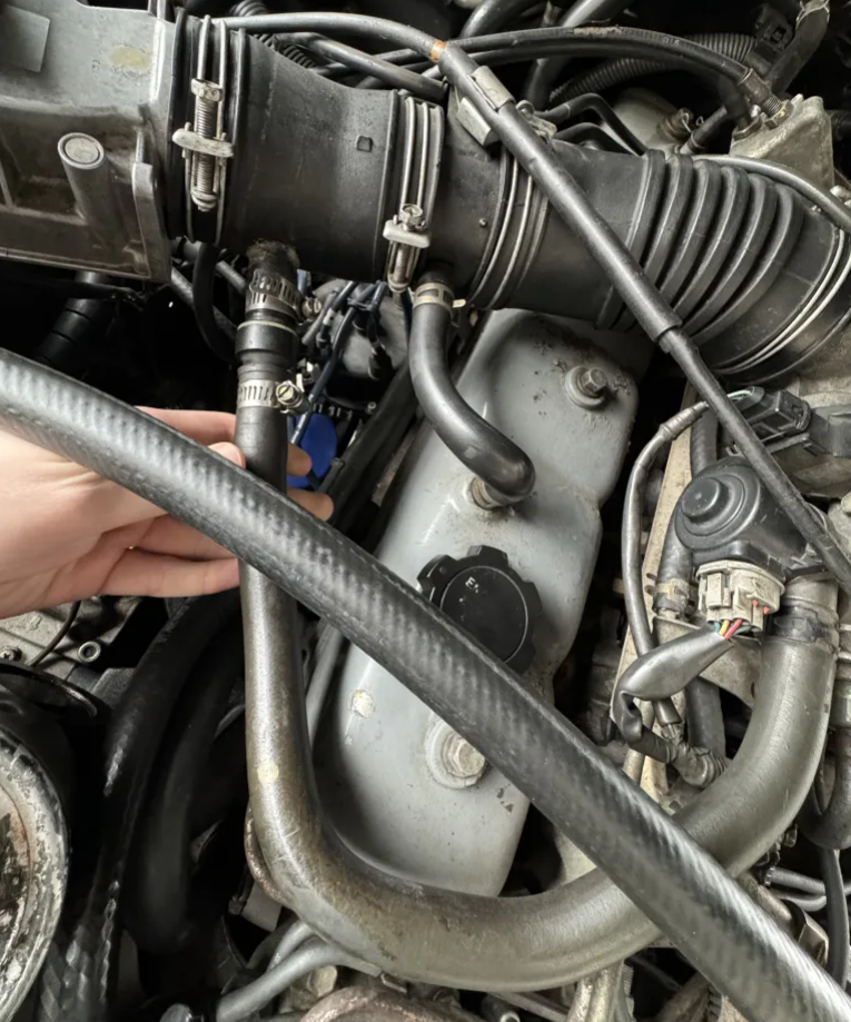

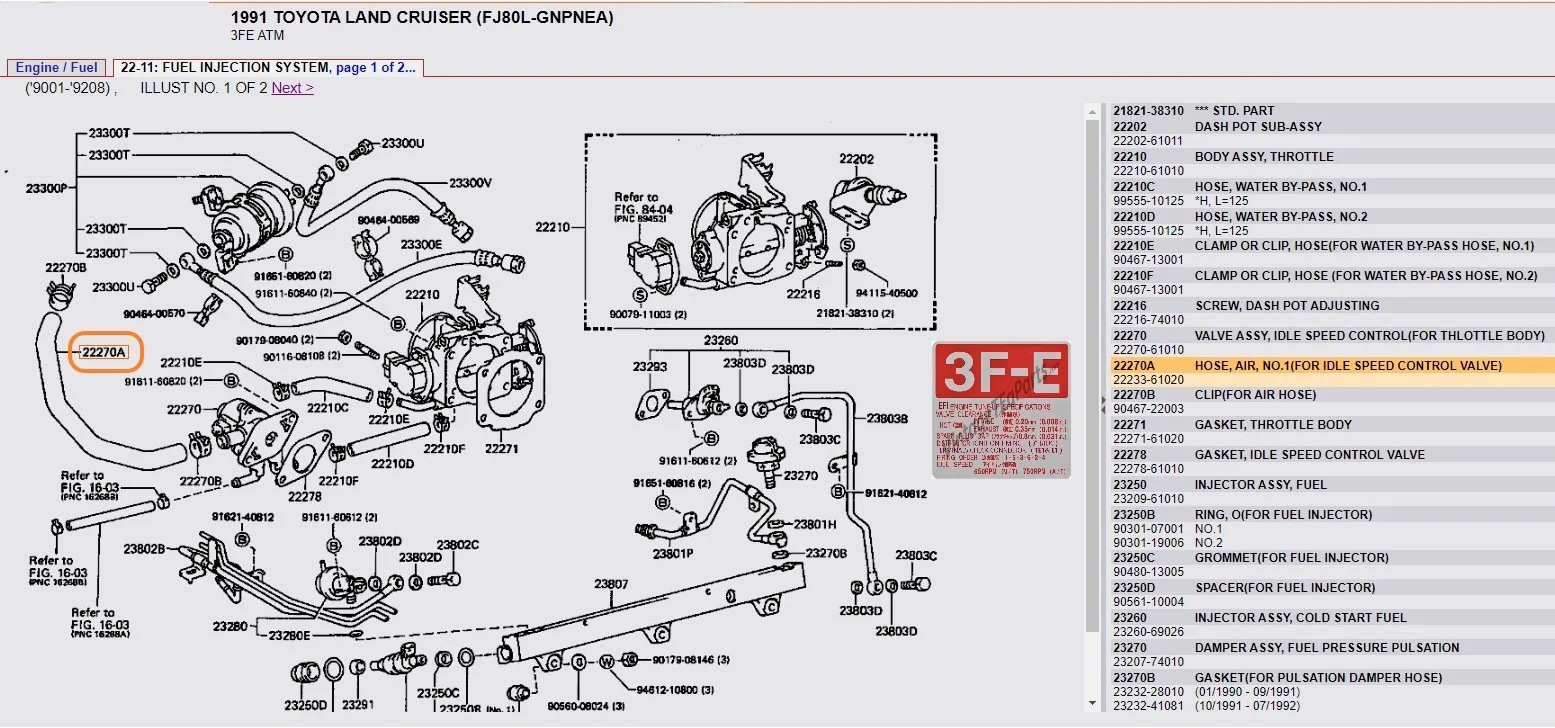

Hope everyones week is going good. Thought it would be a little more appropriate to ask here, can anyone point me towards a replacement for this hose? the one im grabbing in the picture. goes from the air intake to around the IAC. previous owner did some "interesting" work and im trying to get it back to OEM, all help is appreciated
i need this too , i have not found anything remotely close yet oem toyota parts or other Japan made OEM parts either
it was disc. / NLA
21 years ago in 2003 ...
i have however found a straight-section of Japan oem hose that is the same ID and also same hose wall thickness , long enough too !
it does not have to be any type of OIL or petroleum JIS rating code / codes hose rubber because it's pre-throttle body and air-flow direction flows into the intake manifold , NOT sucking outward drawing all the nasty stuff through the rubber hose ...
i will post here when it arrives post install , so everyone can evaluate it including me and discuss the topic as well TECH. wise too .....
oh , btw ...... you
DO NEED to keep this in-place when preforming a text book by the FSM De-Smog ....fyi
matt
it was disc. / NLA
oh , btw ...... you
matt
ah figures it was discontinued. exciting developments though with the replacement, would you be able to link the replacement? i'd love to just have ANYTHING besides what I have now, as the connector on it they patched together doesnt allow me to replace my intake hose with my OEM replacement and its driving me insane. Thanks in advance Matt

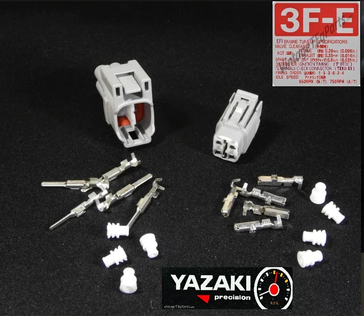

Hi there!
I'm wondering if you folks could point me in the right direction.
I've got a 1991 TLC where the passenger side o2 harness failed somewhere above the transmission.
Unfortunately all 4 wires failed and I have not been able to find the ends to splice in some fresh wire.
My question is if anyone has any advice on how to trace the wires, or alternatively is there a way to bypass an o2 sensor signal and perhaps trim fuel based on the remaining sensor.
Thank!
if you post photos of the harness side female connector plug , both ends please ....
this is what you refer to as the
ends to splice together ?
i am fairly certain these are the 2 rascals here below , but we want to be sure ...
matt
i have not received it yet , i ordered it from japan monday of last week
it should be here soon , then need to test-fit and install to verify good fitment
the ID spec. in millimeters is spot on
the hose-wall thickness i am going by visual comparison photos only and it looks like the shoe will fit :)
