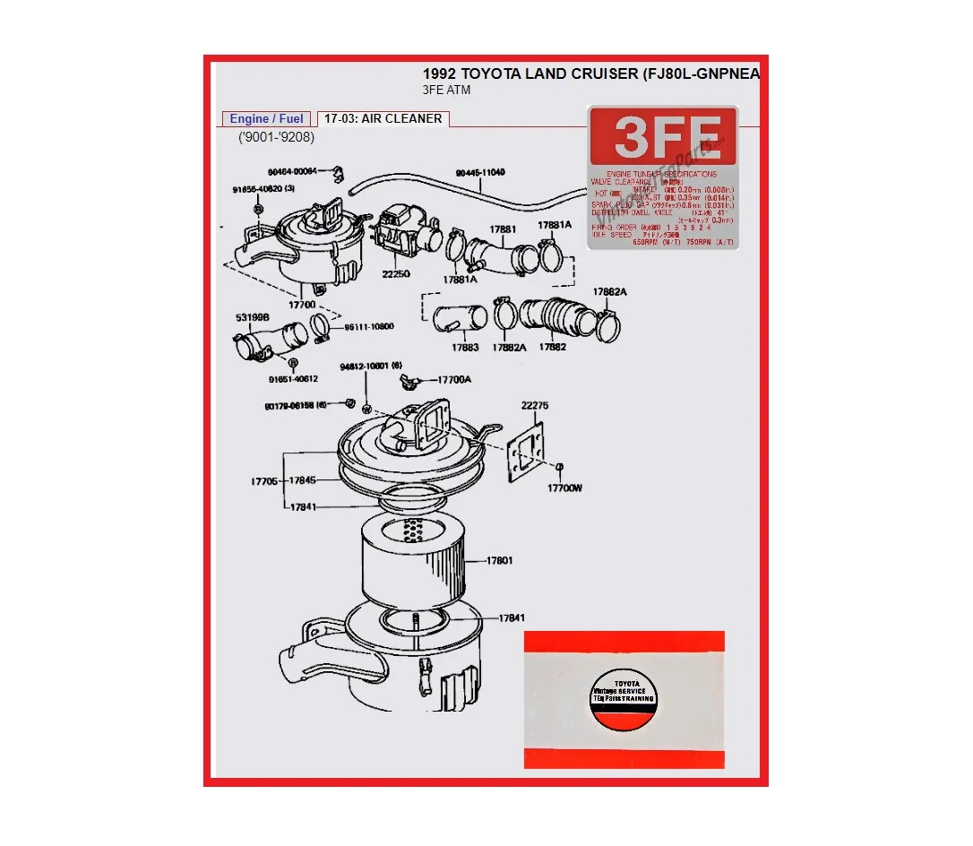

i posted the correct OEM parts diagram too ,based on your sig. line info ..... \ :)

Here is one OEM hose link:
And the other:

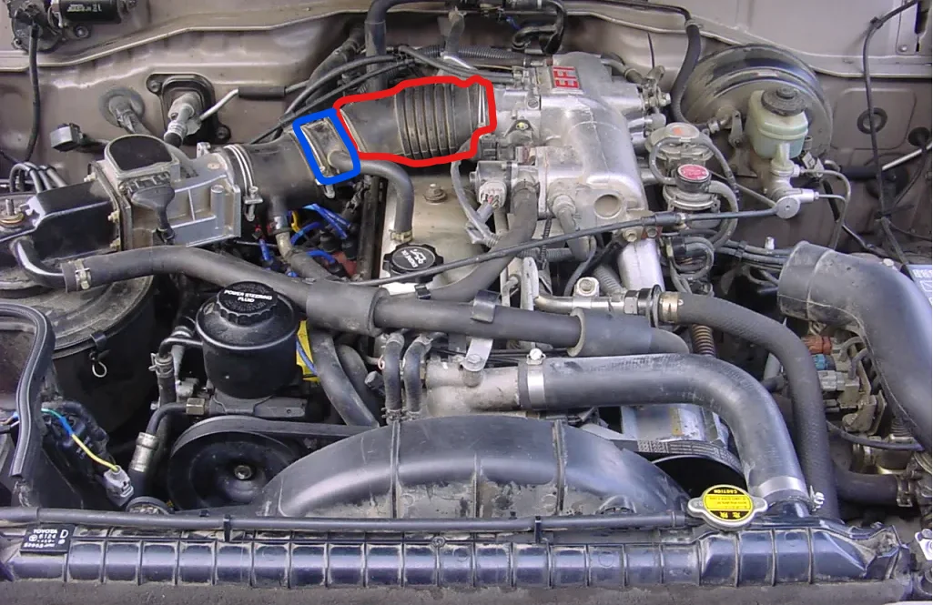

.View attachment 3351009
17882- is what I should have probably ordered but I only drive ~3k a year so I jerry rigged it lol
red is what I replaced with the amazon tube. I also reused the clamps.
blue piece was starting to crack the end of the red where they come together & when I was looking at my air filter it just ripped in half lol.
it took longer to get the tube from amazon than to replace it
ref pic- not my engine bay

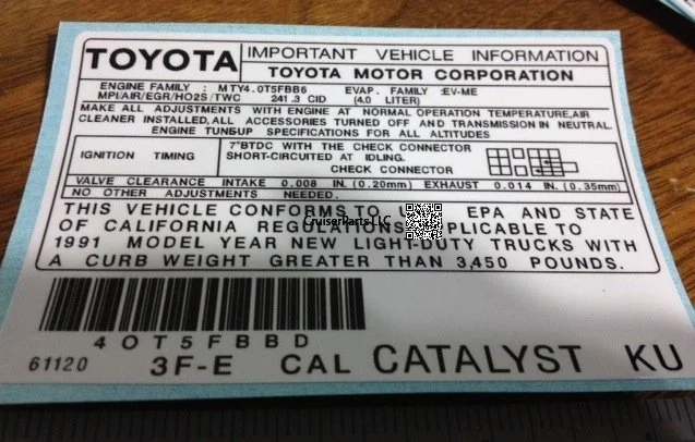

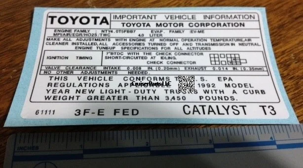

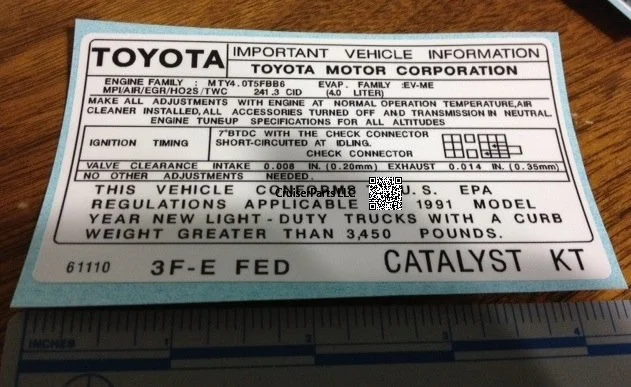

- the below EMISSIONS Control system Decals all state
" 3F-E " and NOT the simple " 3FE " ...
- this is a way TOYOTA assigned MOTOR Family and features such as EFI , TURBO , Double OverHead Cams , Scissors Gears ,
- the 22R & 22R-E are the most common example here to camparson the period of 3F and 3F-E production same in kind timeline era ..
- NOTE : our new engine badge is NOT yet complete , in regards to the tech. specs in the larger pewter area below the smaller RED above ...
- needed final input and details : , i want and need a 2nd and 3rd verified facts source please .......
- they are as listed below in same order as they appear on the final 3F carb badge above our new one below it ...
- the Valve Clearance specs , HOT 0.20mm / ( 0.008 in & 0.35mm ( 0.014mm )
- spark plug gaps ...
- the Distributor dwell angle 2 lines get AXED / omitted altogether entirely , because word DWELL applies to a Points Based ignition system Distributor , not a Fully Transistorized one on like ALL 3F-E 's came with ...
- that creates a major KOOLNESS factor situation to skunk-works out here quickie like , but also well thought out same time too ,,,,,,!
- what do we do with that now free reliststate of 2 FULL on lines , now ... ideas anyone ? time to think harder then hard , and make it count too here ,,,
- ill post my idea input , on the 2 free-space lines further below in its special place you will soon see ..
- firing order ...
- idle speed
- rpm A/T rpm M/T
