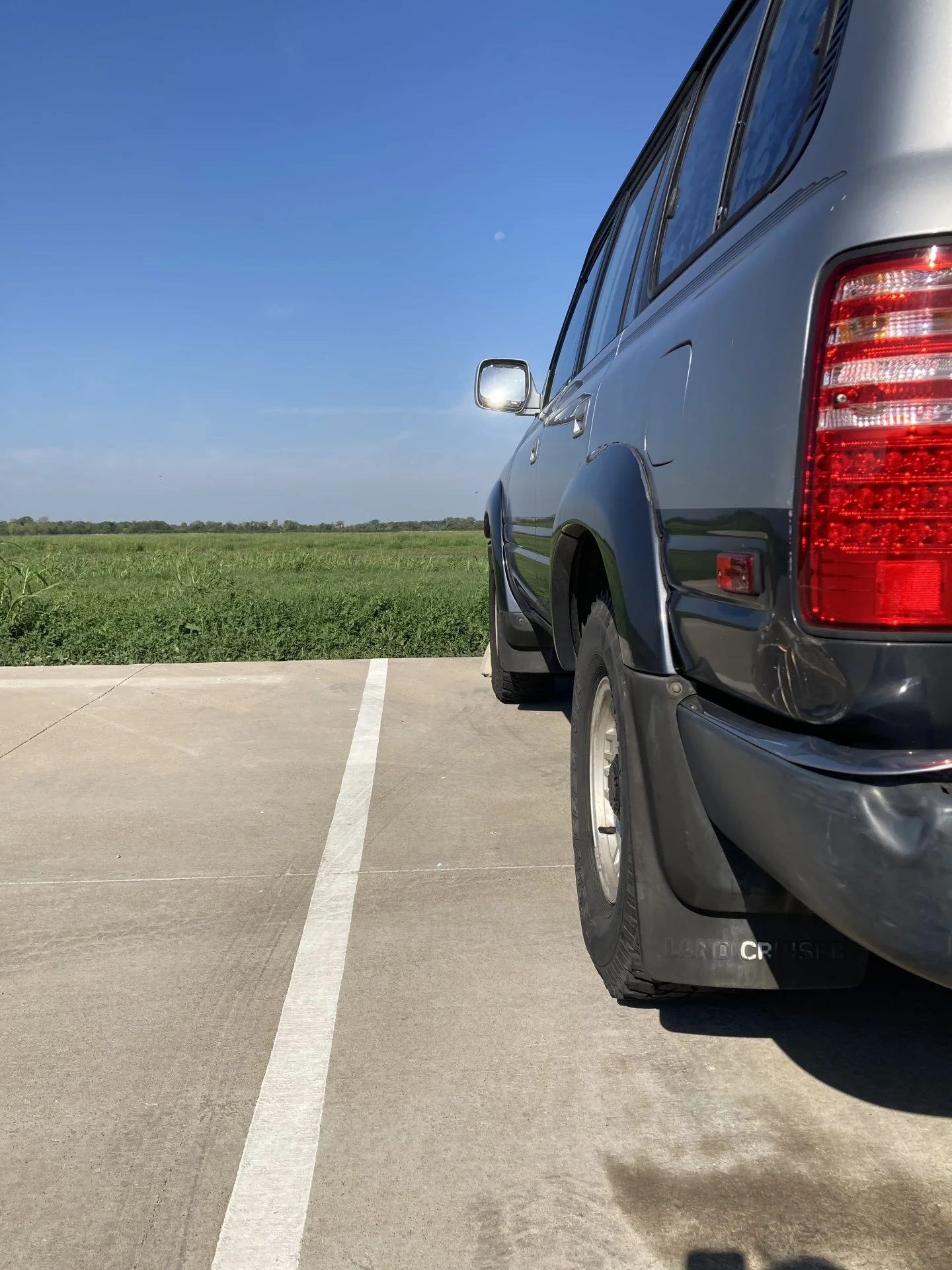

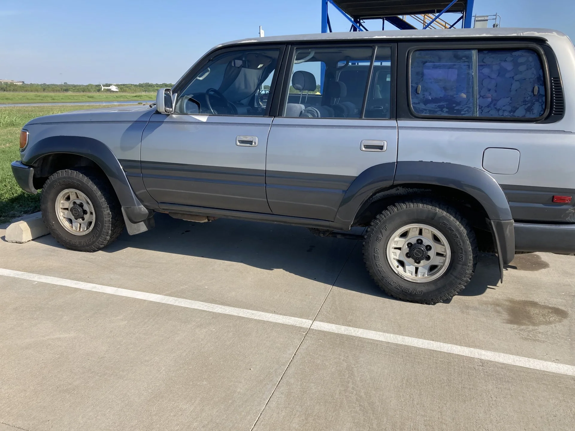

So, I just picked up my FIRST! 80, It's 1991 running on 31.5x10.5x15, looking to up grade to 33, but was told I need wide rim's as I'm running on OEM 15's. Need some help, do I buy 16's rims or stay on OEM 15's? Thanks
Pics of the vehicle side angle
I was told by the tire shop the OEM rim is only 6 inch wide, and I need a rim with 8 inch wide rim.
