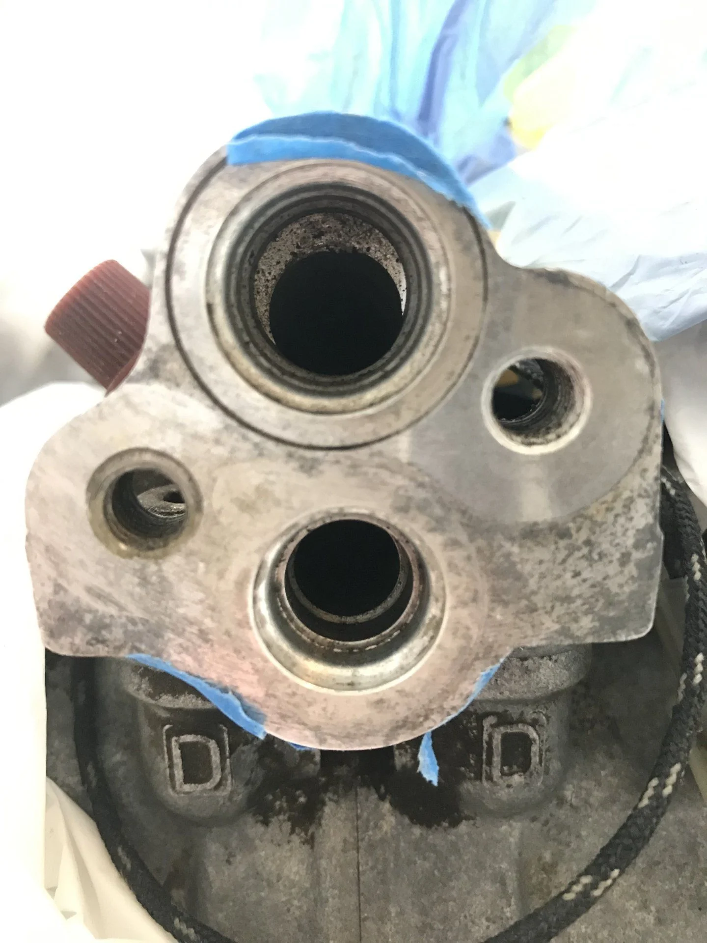

This is what the manifold on my compressor looks like:
Thank you, PM sent.

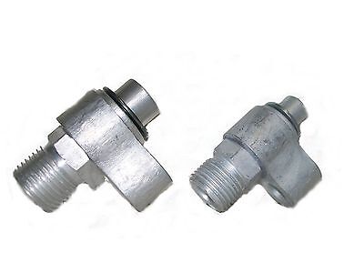

the 62 hoses have a bolt flange fitting, the hose attaches with the bolt, 1 bolt for each hose. there is a male piece on the fitting that the oring goes on and slips into the compressor then held in place with the bolt.
Do these look like what I need?
Thank you!
