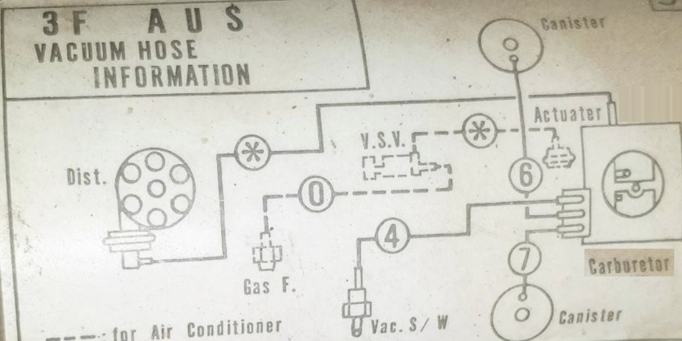

It is a Vacuum Sensor, for the Idle Fuel Cutoff. It earths to ground, when Vac goes above a level. That ground signal goes to the yellow computer box in the passenger footwell, which this controls the fuel-cut-off. I've bypassed my cut-off, so I dont think I need to worry about it. This thread talks about it. Aisan Decel Fuel Cut Circuit - https://forum.ih8mud.com/threads/aisan-decel-fuel-cut-circuit.989475/
However, more concerning is the layout of the three Vac-Pipes at the top of the Carb. Your picture above, and another one I found on the internet has the Vac sensor on the pipe closest to the Fender. However the 'Vac Layout Diagram' on the Air-Intake Pipe, suggests that it should be the one closest to the engine? So right now, I'm on a mission to figure this out.

Have you got access to a decent vac gauge?
I used a really old one (it was installed in the 1980's) and tested each port (hooked up a T-piece) and found that some of the ports were higher or lower than the other. They weren't all the same (even the manifold ports are different pressure, at idle and also under load)
This also includes what is the correct vac port for distributor advance (probably the most important) if I hook it onto a 'high vac pressure' port, the advance is rotating and the timing is then WAY too advanced for idle/initial start up.

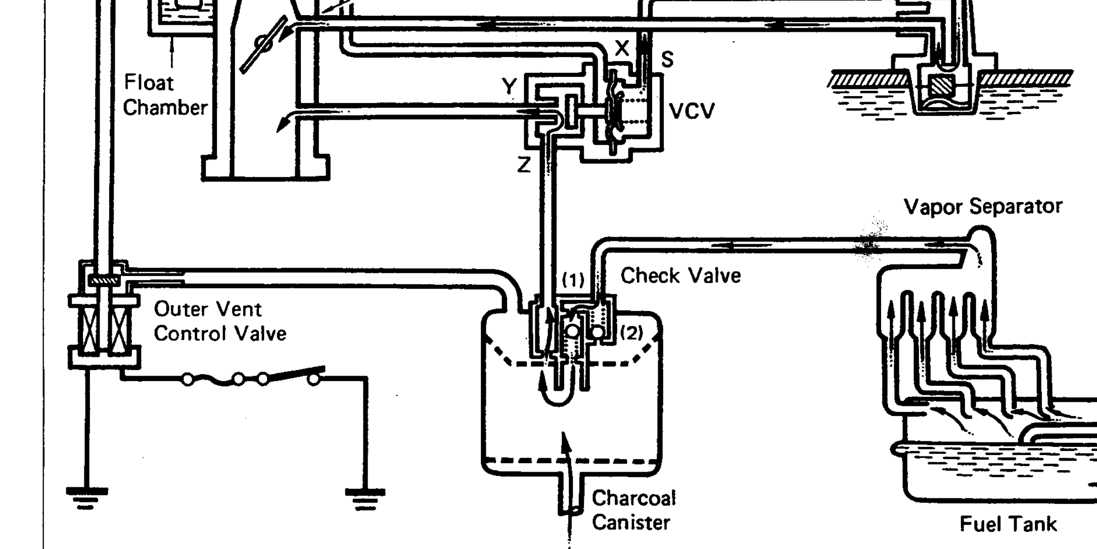

My investigations then moved to the two Charcoal Canisters. I ordered the ACdelco, BUT looking at this diagram from a 2F;
You can see that the canister has inbuilt valvles. The 2F have 3+air ports, the 3F has 2+Air ports. When you pull them out and test them.
- The small port (which connects to Carb) has a Valve one way.
- The large port vents to Air
- The small port, also vents to air.
Hence, I cant see how any overpressure or underpressure, would ever get past the charcoal canisters and impact Carb drain. Any pressure from TANK or CARB will vent to Air? This is on both canisters. Hence I dont think this is the issue.

I’m not sure if this helps. In the US we have two things that control the venting to/from the evap canister on a 2F.
One is the “outer vent control valve” that is attached directly to the evap canister bracket, it sits right on top of it. It plugs into the wiring harness as well. The other is a VCV (pictured below) on the carburetor side. This part is still available from Toyota. You obviously have the 2F and missions manual so you can see how it’s all plumbed together.
On our US 2F trucks, this part is black and white. At this age, every single one of them is bad - I’ve tested maybe 12-15 and have never found a good one. The above black/blue unit comes from the 80 Series and is identical except for one vacuum nipple that faces a different direction.
Even if the carby 3F motors used different equipment, perhaps one of the puzzle pieces could get replaced with the unit above. Maybe you just craft your own evap system with whatever parts are available in other words. Again, the 2F emissions manual will show exactly how that part works. Hopefully any of this is helpful.
