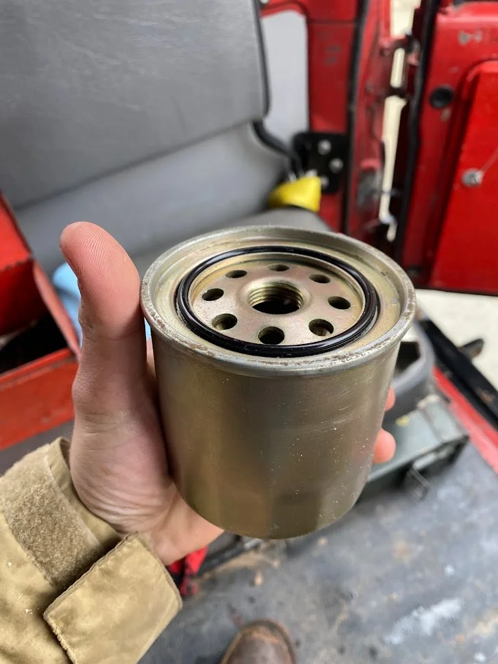

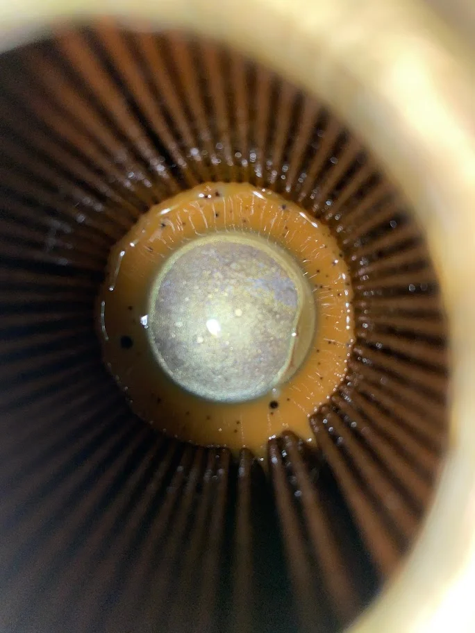

I was tired last night, after a bit of reading and reflection/just thinking stuff through I believe it is in fact the diaphragm... I do have a racor with about 15,000 miles on it, same for my OEM fuel filter. I checked both and they didn't seem bad, I replaced the 2 filters with spares I had and the problem still persists. I use diesel additive/treatment during every fill-up that should prevent algae from growing unless it's faulty, as well as adding lubricity to the diesel in place of sulfur etc etc.
I had the idea of the diaphragm in the back of my mind but I really didn't want it to be that, just some clogged filter or EDIC ground issue. Was really hoping a funky ground would be making the EDIC switch back and forth randomly to off and back to on, causing the fuel delivery issue, that obviously isn't the case. I have the 3B tuned to not really ever smoke, except on startup, or if it's pegged at 20psi in low range 2nd gear, never have really seen any smoke color other than on startup, even when the problem happens there is no visible smoke.
Reasons I believe it's the diaphragm: the filters are fine, the EDIC functions fine, and in the video, below you can watch me suck on the venturi lines trying to build vacuum but it just feels like I'm sucking through a straw, also the idle has been getting higher and higher consistently throughout the past month.
Below are photos of the outside and inside of the fuel filter, I forgot to take one of the racor.

Yup! sucked on it and held no vacuum, thanks for the links as well as how to maintain it whenever I replace it.
