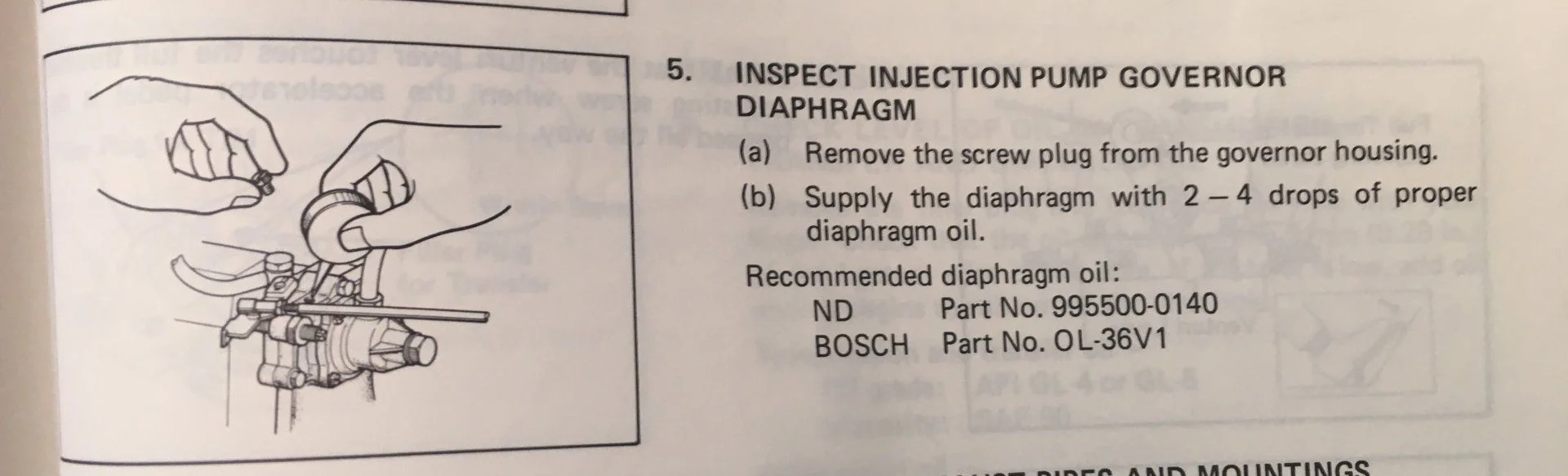

Where could I get this kind of oil? What is the difference compared to motor oil?
Try a pharmacy or Tack Shop, great for all leather products.

I picked some up at a Saddle Shop a few years back.

Thanks for the replies. I ordered one bottle of this from Japan ($12.99 shipped):
