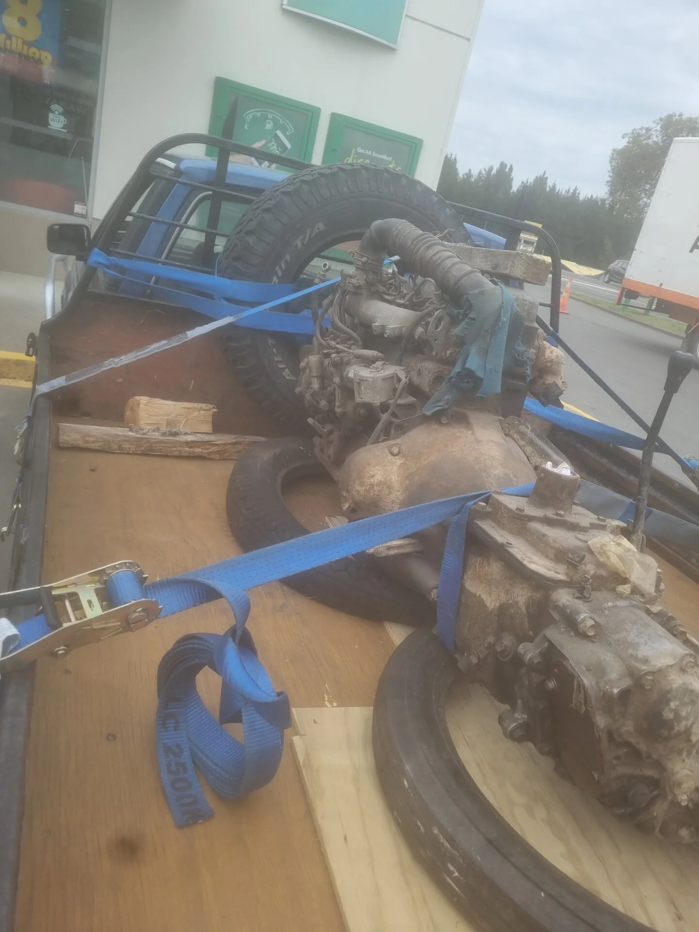

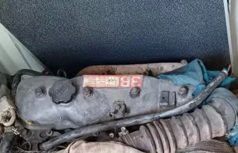

I mean they both say 3B on the side and the only 2 noticeable differences is that the fuel pump in inline and the oil filter is upside down

Ol well which ones which. Cause they both day 3B and are identical other than the fuel pump and the oil filter is upside down on the one that's on the back of my ute
3BII by all accounts has a slightly different rocker cover, may have been more likely to have come out of a Coaster or a Dyna rather than a Land Cruiser.
Can you post a photo of the one on the back of the ute?
That's the one on the Ute
The oil filter facing one way or another doesn't tell you anything. 3b engines had both style oil filter housings.
3bii engines came in plenty of land cruisers too not just coaster or dyna. The 3b is just a predecessor to a 3bii. I believe the change was sometime in 88 or so.
Well I thought/know that both were normal 3Bs but then people in this thread are thinking it's a 3b11 so now I'm very much confused
